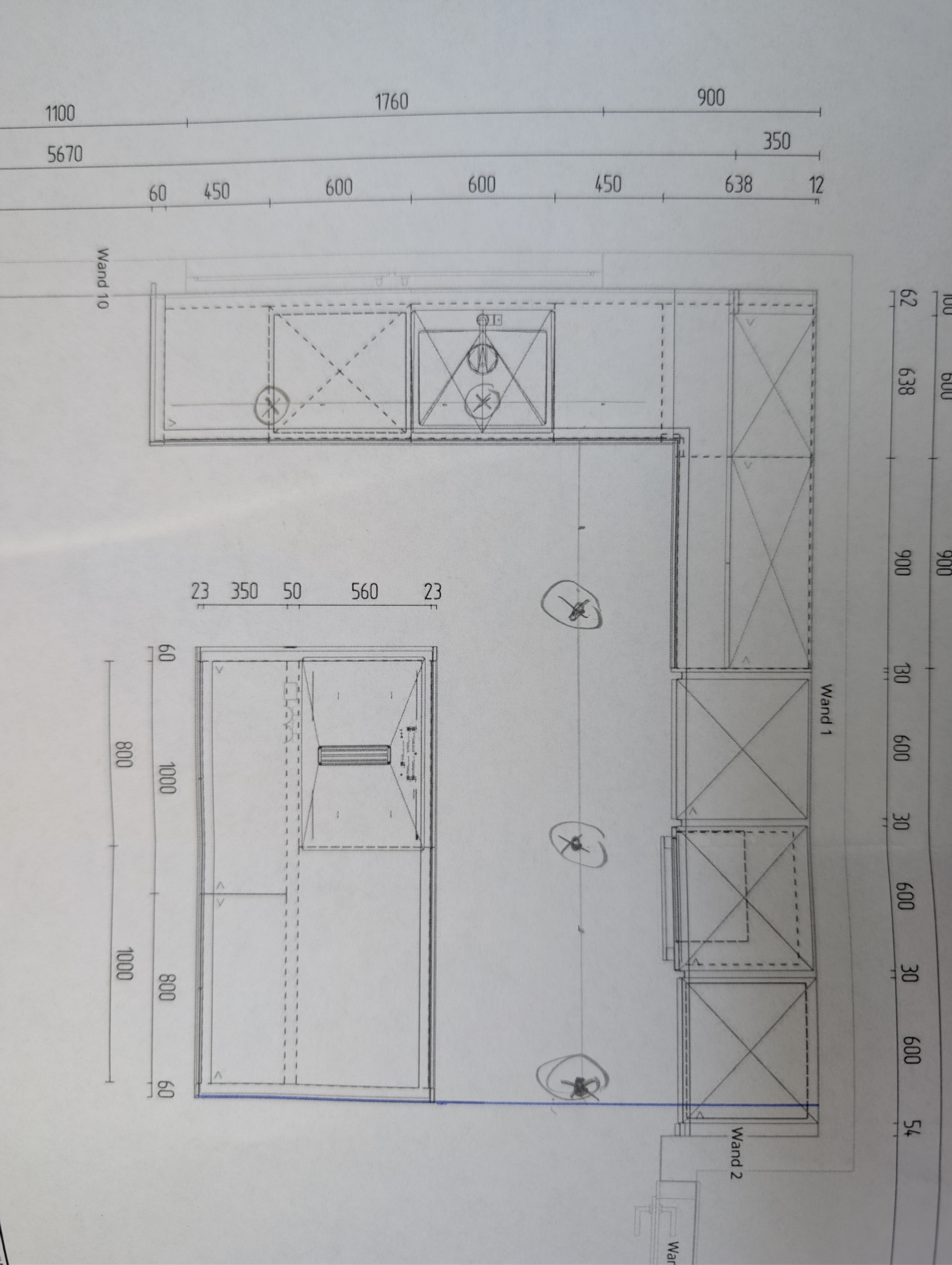

we are planning to install recessed ceiling lights in our kitchen.
Here you can see the installation plan and our proposed layout for the spots, marked in gray.
What do you think?
Thanks and best regards
Papierturm21 May 2026 08:37
We have two rows of spotlights – one closer to the cabinets (to reduce shadows when standing near them), and one centered above what you call the island. With your current plan, that area would be too dark for my liking.
I would also arrange the spotlights more symmetrically. Right now, there is a bend in the layout. I’d prefer two spotlights from the side near the sink instead of one directly above it.
Chimpska
21 May 2026 08:43
Thank you. I forgot to mention: pendant lights are planned above the island. I’m considering whether maybe just spots would be enough?
familie_s21 May 2026 09:12
Did a kitchen planner handle the design? Ours also included the lighting layout along with a light simulation.
Do you really want the cooktop that close to the edge of the countertop? I understand you want a larger uninterrupted work surface, but this way a lot of grease, etc., ends up on the floor.
