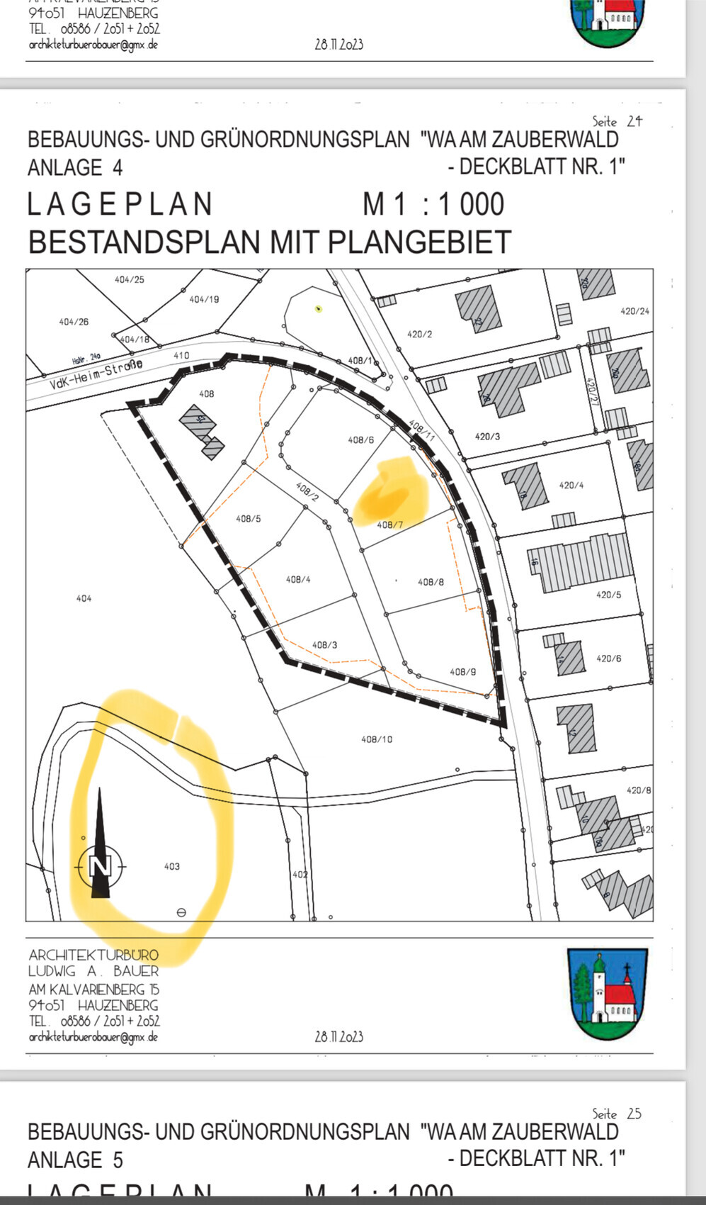

I need your experience on the best way to position a house measuring 8.4 x 10.4 m (27.6 x 34.1 ft) on a trapezoidal plot of land to maximize usable garden space, while avoiding an excessively long driveway.
Development Plan/Restrictions
Plot size: 665 m² (7,157 sq ft)
Slope: slight, facing northwest
Floor area ratio: 2, no basement
Building window, building line, and boundary: see plan
Building layout:
The longer upper side is about 30 m (98.4 ft) long
The shorter lower side is about 16 m (52.5 ft) long
The left side is 28 m (91.9 ft)
The right side is 30 m (98.4 ft)
The plot is marked in yellow on the overview map, where the cardinal directions can also be seen.
The blue box marks the building window – it’s quite large. Roof ridge orientation does not matter. However, the setback distance of 3 m (9.8 ft) for the house must be respected. The garage and storage can be placed anywhere. The driveway access must be from the lower street.
Building layout:

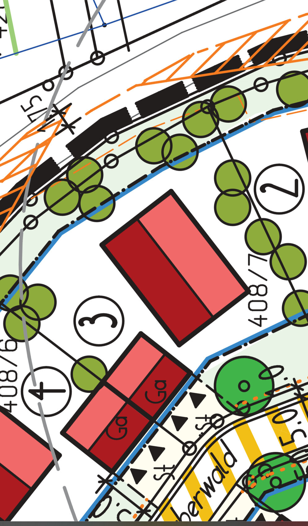

Are there no specifications for building heights? Reference points? Benchmark levels?Yes, there are. But slope-side data is given combined with houses A, B, or C. And honestly, with all due respect to the detailed work, it’s too much effort for me to summarize all necessary information clearly, including maximum eave heights, and to figure out for someone else—without knowing the floor plan—which fixed dimensions show how the house is optimally positioned.
That is the responsibility of the builder. Also, drawing out the facts.
K a t j a schrieb:
It does make a difference if I place the house centrallyYes, but are we talking about moving it one meter to the left or right, or just ensuring the living room gets enough light? The floor plan is genuinely the real challenge here—now add the slope data, plus the rule that garages must either be attached to the neighbor's garage or have a one-meter (approximately 3 feet) gap. Then tree planting in front of the plot is mandatory, including linden and oak trees. I couldn't remember exactly which species. But that plays a huge role in planning rooms on the south side that will eventually be enclosed. In addition, fences facing the street or hedges are prohibited. So, it’s not about placing a fixed-size rectangle well.
You have to plan flexibly _with_ the plot _and_ the floor plan.
K a t j a schrieb:
Allow space for a tree’s canopy.As I said: on the south side in front of the property. Zauberwald schrieb:
the most sensible orientation of the housewould be to gather all parameters first—not necessarily for us, but for you. You’d think you’d have already dealt with the plot and the zoning plan rather than just looking through catalog floor plans. That’s not enough if you want—and must—spend half a million. Zauberwald schrieb:
t). And of course, the orientation also affects a future photovoltaic system. …Yes, then you already know which direction the ridge must face. That’s a start. Then look at the slope: what can be where? Because raising or lowering ground is not allowed toward the neighbor. Zauberwald schrieb:
What else must be considered with an 8% slope for house placement?80cm (approximately 31.5 inches) over ten meters (approximately 33 feet). You really need to check where rainwater flows because it probably has to be collected on your own property. So: sketch your rooms, where they could be. Sketch a driveway or garage with a one-meter (approximately 3 feet) distance to neighbors and try to get light from the south and quiet from the north. You can spend a month with colored pencils on that. Then you can discuss it, the mistakes, pros, and cons.

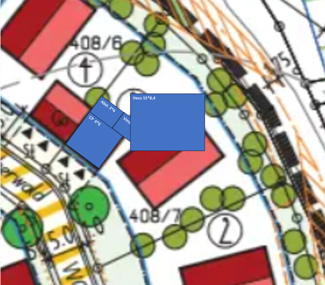

Zauberwald18 Jan 2024 21:39Of course, we have been working on the floor plan and development plan ourselves for quite some time. That’s why we are now at the point where we’re unsure about the best way to position the house on the plot because of the “slope.” I’m not concerned about the tree to the south. If it becomes an issue, it simply won’t develop a large canopy; there are plenty of ways to manage that.

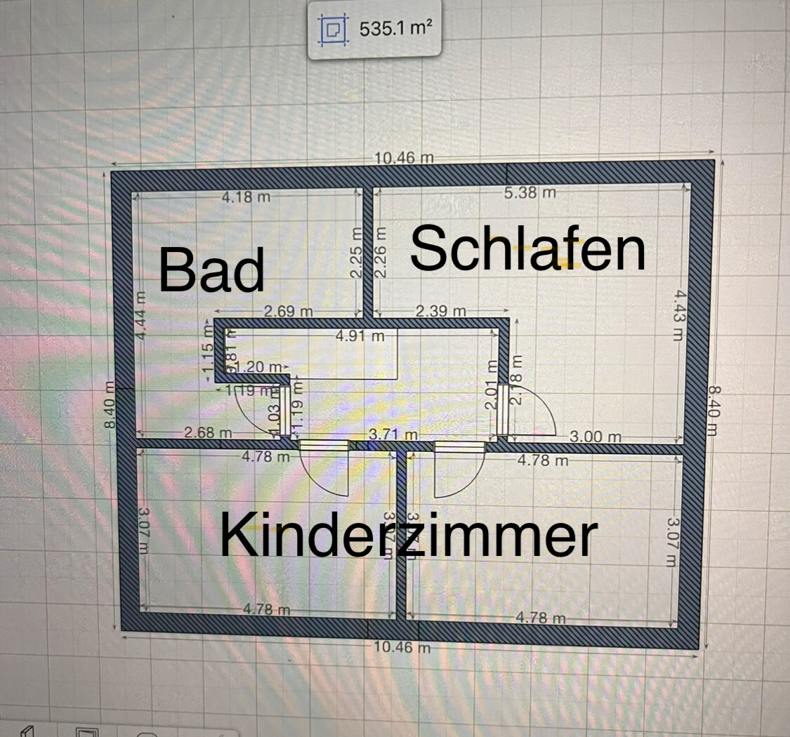

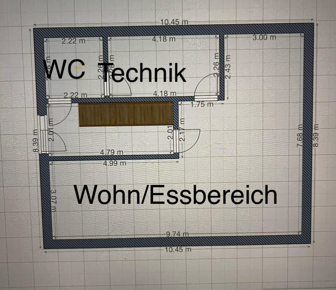

As shown in the picture, we have already considered the orientation. At the front, there will be a carport. To the left of it is the storage area. The idea is to be able to enter the house without getting wet by passing through the carport and under the storage’s roof overhang. The floor plan itself is quite simple; I’m attaching it for reference, but my main interest is in the “big picture” regarding the orientation.
hanghaus202318 Jan 2024 21:41It would help to answer all questions. With your house, the minimum 1.3/1 ratio is not met based on your specifications. So, 11 x 8.4 m (36 x 28 ft) could work.
Z
Zauberwald18 Jan 2024 22:02hanghaus2023 schrieb:
It would help to answer all questions. With your house, the minimum ratio of 1.3/1 is not met based on your information. So 11×8.4 m (36×28 feet) could work.Yes, you’re absolutely right that we are just under 1.3. Respect for spotting that so quickly! But that’s exactly what I mean: it’s not about checking the floor plan of the house to the millimeter right now; what matters to us first is how the house is positioned, and then we can deal with the exact details inside the house. That seems like the simplest way to first establish a basic orientation and then think about the “smaller details,” right? Our main goal inside the house is to create as much space as possible in the living/dining area and to have two reasonably equal-sized children’s rooms.
