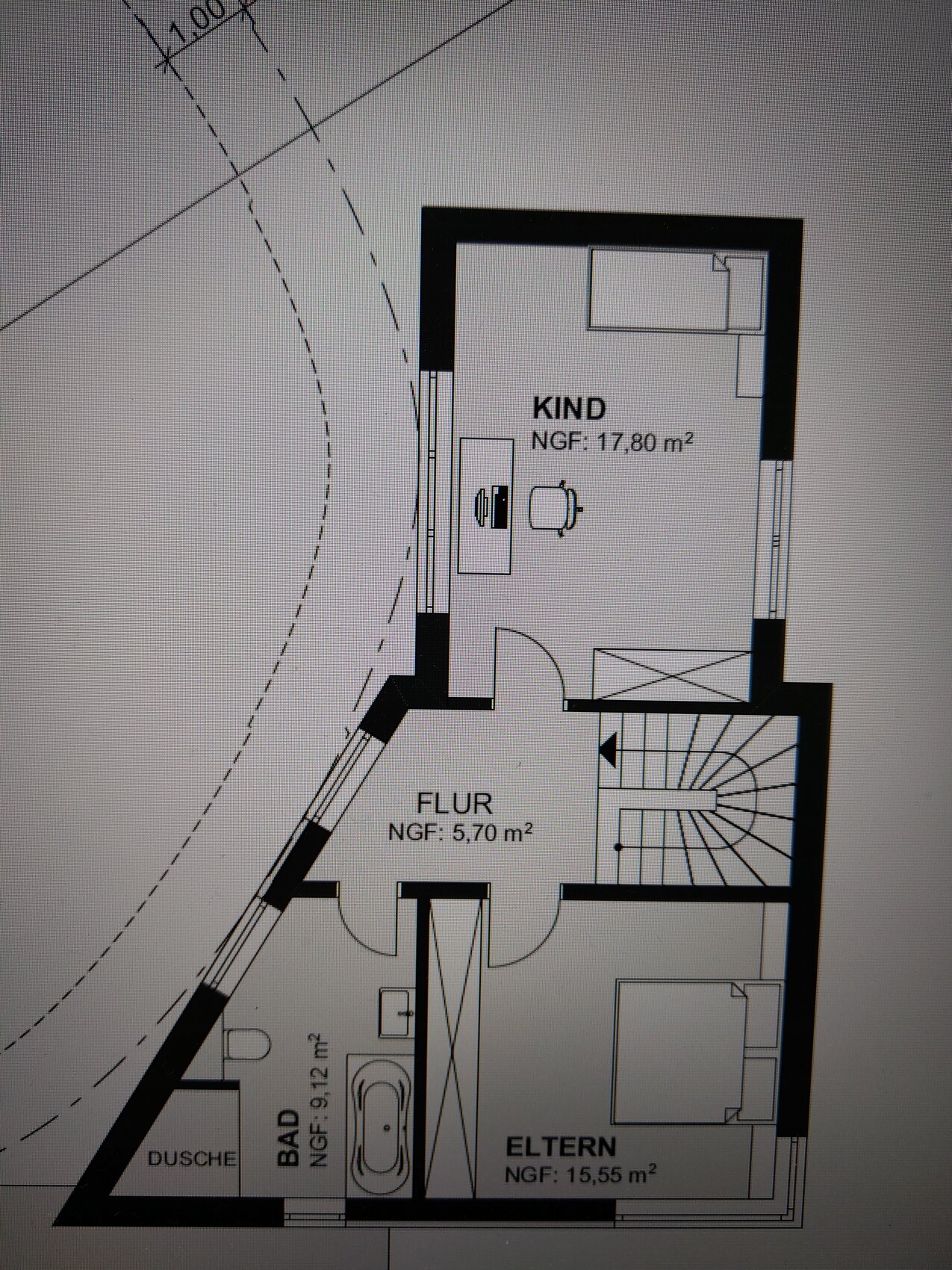

Hi!
Attached is the floor plan of the upper floor we are currently designing. How would you plan the bathroom? We want both a bathtub and a shower. Shelf space and a spot for a narrow bathroom cabinet should also be included.
The two windows can of course be freely moved.
Looking forward to your ideas!

Yosan
11 Jan 2019 14:54
Is this a full storey, or are there sloped ceilings to consider?

Yosan
11 Jan 2019 21:42
Ok. Still a challenging room. I don’t think the layout in the plan is bad at all, but the window by the toilet naturally reduces the available space... How exactly are the windows going to be, I mean how high and how far down?

kbt09
11 Jan 2019 22:35
A few measurements on the plan would definitely be useful 😉
