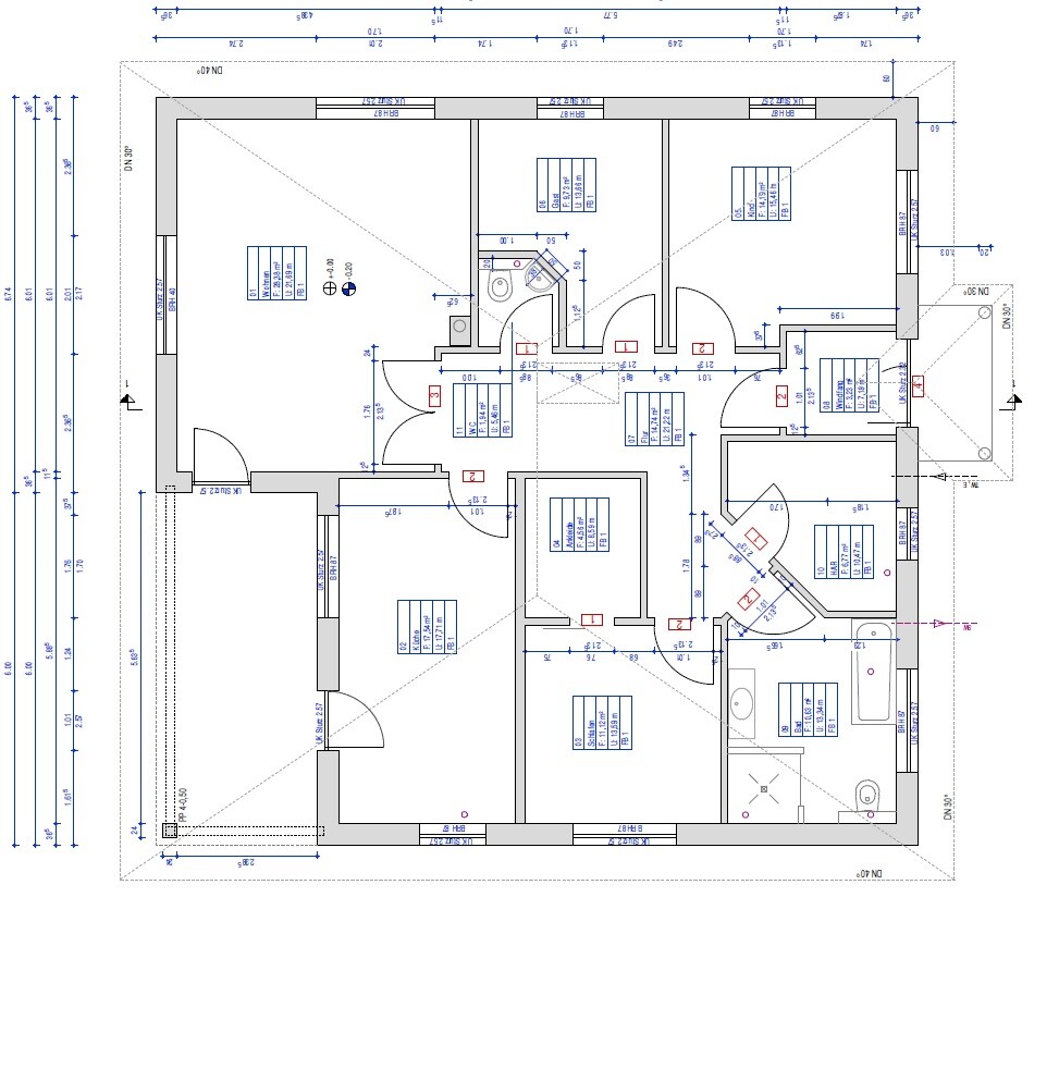

I’m not sure how to arrange the spotlights. First, I want spotlights in the soffit, which looks really nice. Unfortunately, I can't decide on any layout.. :/
Then I also want some inside the house… hallway, bathroom, etc. What do you think?
Thank you very much for any useful ideas. Floor plan attached! 13m (43 feet) long, 12.74m (42 feet) wide on the front entrance side + 60cm (2 feet) roof overhang!

garfunkel10 Sep 2016 22:21You can do it however you want.
I would place some at a distance of 30cm (12 inches) from the wall, then the next row about 70cm (28 inches) or so, until they meet in the middle.
You can arrange them regularly or irregularly. At the ceiling-wall corner, you could also install LED light strips.
There are almost endless possibilities.
The important thing in the end is to install more spots than you think you’ll need. It’s much easier to switch off a few spots than to add one later.
Spots are great and enhance many rooms, but in some rooms, I would rather choose decorative lamps. That keeps the overall room atmosphere more cozy.
For example, in the living room, I would think twice about using only spots because it’s usually meant to be more comfortable there, and "regular" lamps can have a much better effect.
I don’t know where your relaxation area is—bathroom, living room, bedroom, kitchen, or somewhere else—but consider whether you want only spot lighting in that area.
In my opinion, spots can seem somewhat cold and less cozy, depending on the situation.
Alternatively, you can install double switches. You’d use the main light with spots and still have indirect lighting with, for example, other types of fixtures.
There are so many options; you might want to get advice from lighting designers or similar professionals. It’s really amazing how much is available.

I installed my spotlights with a 40cm (16 inches) distance from the wall.
I determined the spacing between the spotlights using an LED lighting calculator (Google), so that the light cones projected onto the floor would slightly overlap. For me, this was about 2.2m (7 feet 3 inches).
