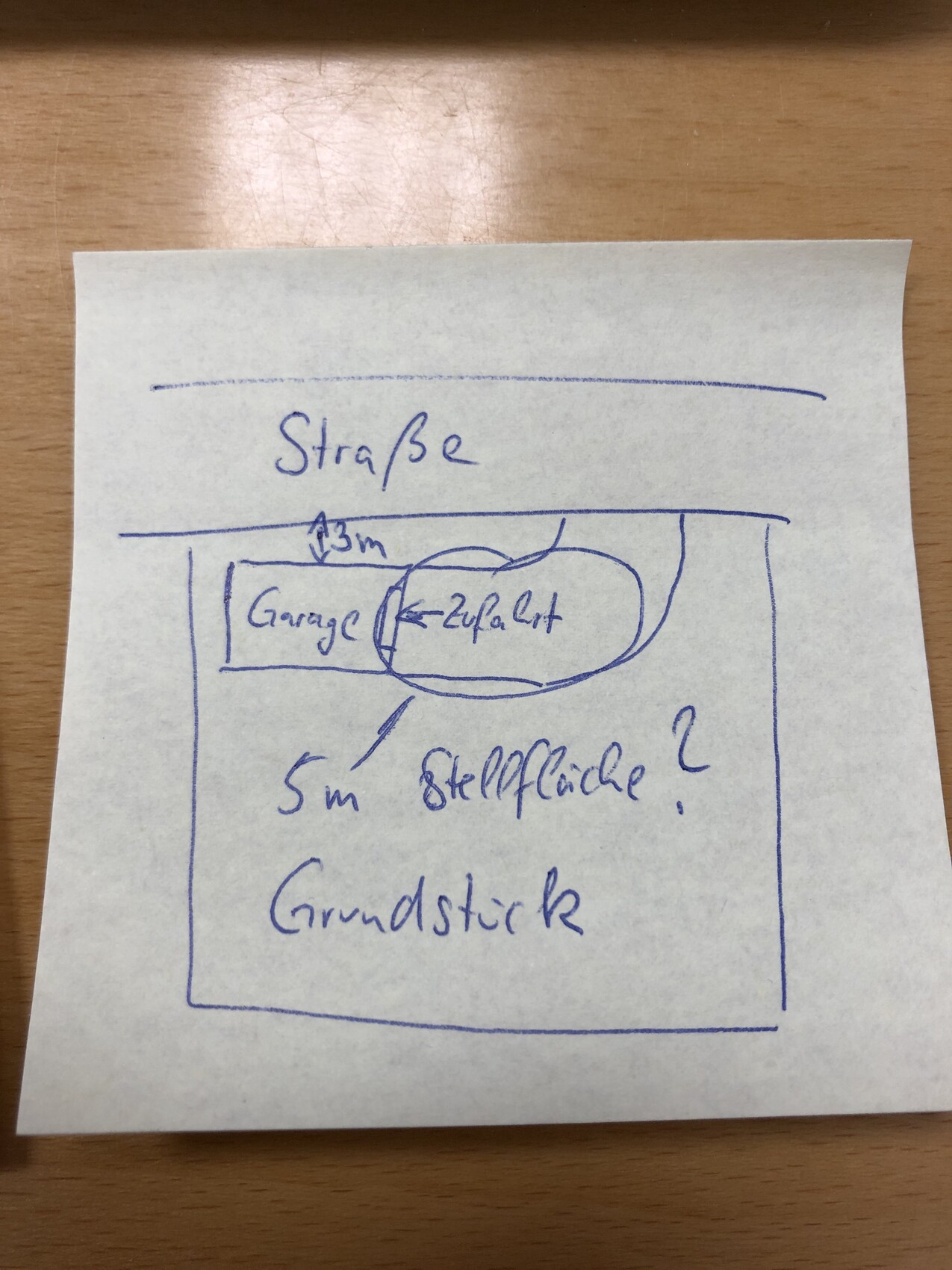

according to the building regulations, 5 meters (16 feet) must be available in front of the garage. Can I position the garage parallel to the street with a side driveway? (See the sketch attached – the building area extends up to 3 meters (10 feet) from the street.) This would mean leaving only 3 meters (10 feet) between the street and the garage on the side.
Thank you and good luck
Michael

Isokrates16 Mar 2021 09:29Michlhausbauaa schrieb:
I just reread it: garages are allowed up to 9m (30 feet) along each property boundary.Then you didn’t read the article 6 BayBo quoted by Escroda completely.
Article 6 paragraph 7 sentence 2 BayBo regulates the maximum 15-meter (49 feet) boundary development allowed for a property, which has already been mentioned here.
By the way, I think you mentioned earlier in this thread that you are planning a workshop. However, the boundary privilege does not apply to such structures. You should keep this in mind if you intend to build a workshop as boundary development.

Isokrates16 Mar 2021 11:32Michlhausbauaa schrieb:
pure hobby workshopYes, even a hobby workshop is not privileged. That means it cannot be built right up to the property boundary. The term "garage" is defined very narrowly.
"Garages are buildings or parts of buildings used exclusively for parking motor vehicles."
Legal definition from Article 2, paragraph 8, sentence 2 of the Bavarian Building Code (Baybo)
There are also plenty of administrative court rulings on this topic.

Isokrates16 Mar 2021 14:37Michlhausbauaa schrieb:
Is there a maximum size for a garage?You can’t really answer that in general; it depends on the specific situation (lot size, floor area ratio, zoning regulations, etc.).In any case, you will need a building permit / planning permission if the garage is going to be larger than 50 square meters (540 square feet) and you want to build it on the property boundary, according to Art. 57 para. 1 no. 1 letter b) BayBO. Otherwise, it can be up to 100 square meters (1,080 square feet) under Art. 57 para. 2 no. 1 BayBO if there is a local ordinance.
In your case, it would be best to get professional advice from a qualified architect or planner authorized to submit the application, who can also handle the permit process accordingly.
