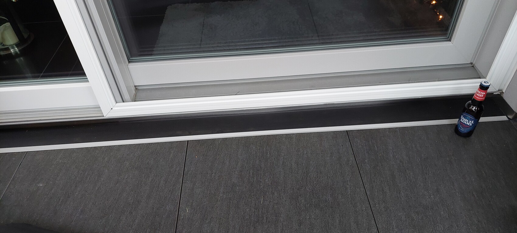

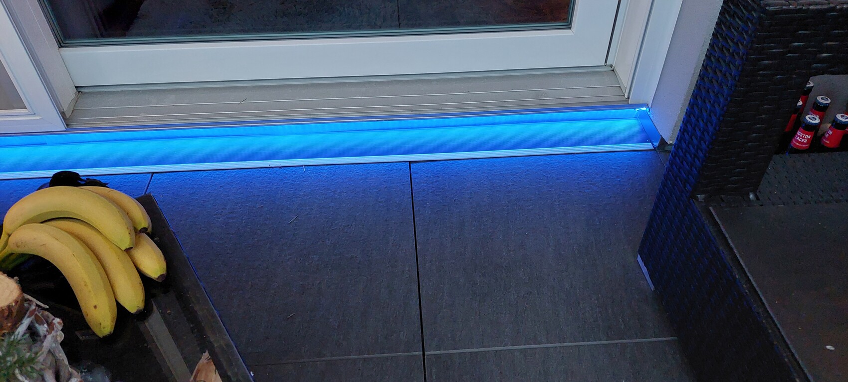

Der suchende2 Jan 2022 13:24...we have been using the lift-and-slide door in a closed position for 5 years now. A door panel would have been taller as well.
The flush installation (threshold-free) was denied because supposedly there wasn’t enough height for a sufficient drainage channel. We can live with the few centimeters difference.
The terrace flooring is installed on pedestal supports, which in turn stand on rubber mats, and these again rest on a thick plastic sheet serving as waterproofing.
I could no longer see the "drainage channel" made of loosely laid grating! Therefore, I clad the vertical section with stainless steel and replaced the grates with a WPC panel.
Also, the regular removal to clear the fallen leaves is now no longer necessary.
I cannot tell how the planning was intended on your side(?).
There is a balcony above the sliding door and we have had no issues with water, not even with regular watering using a hose or once a year pressure washing.
Good luck and much joy after your move-in ;-)
