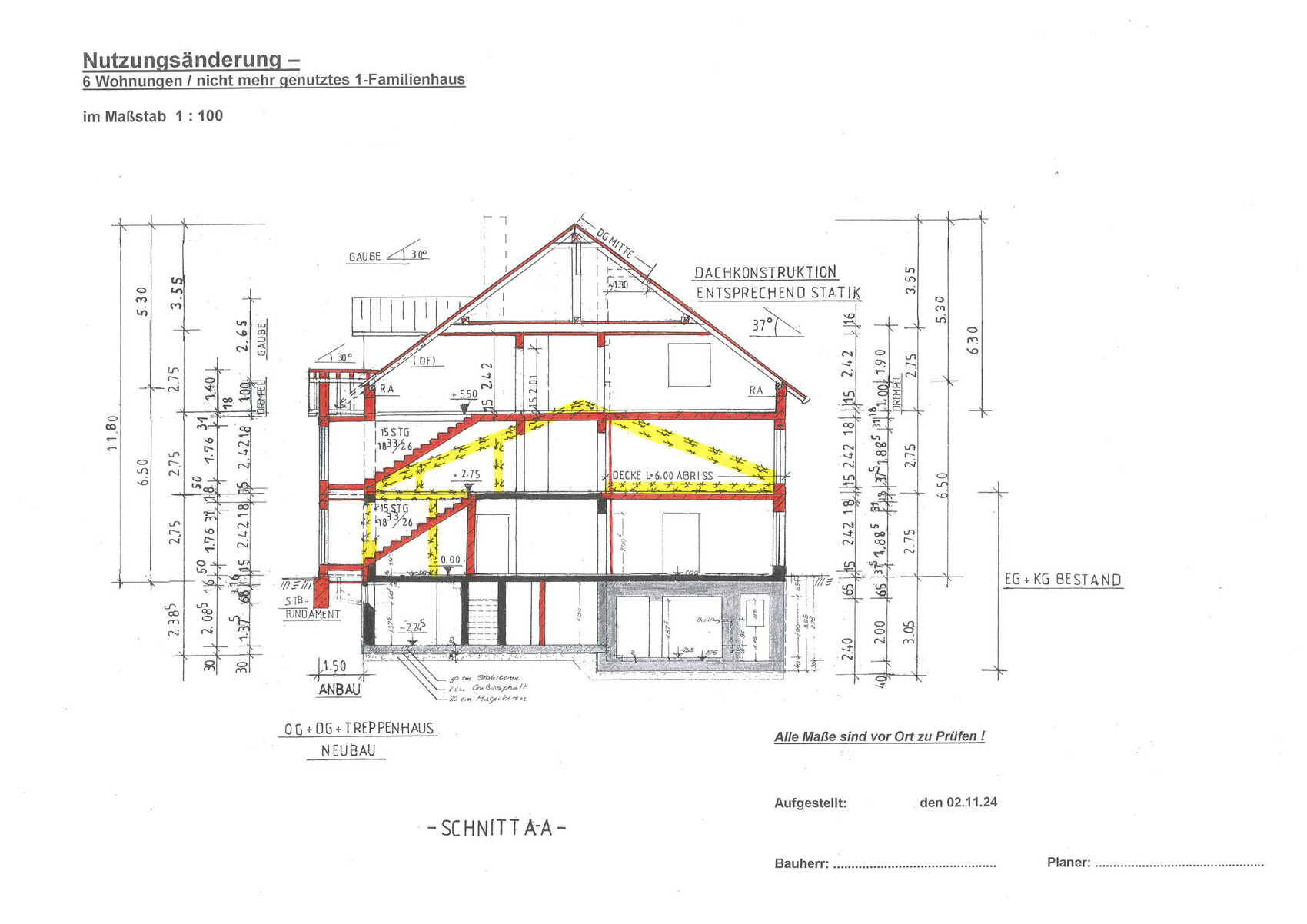

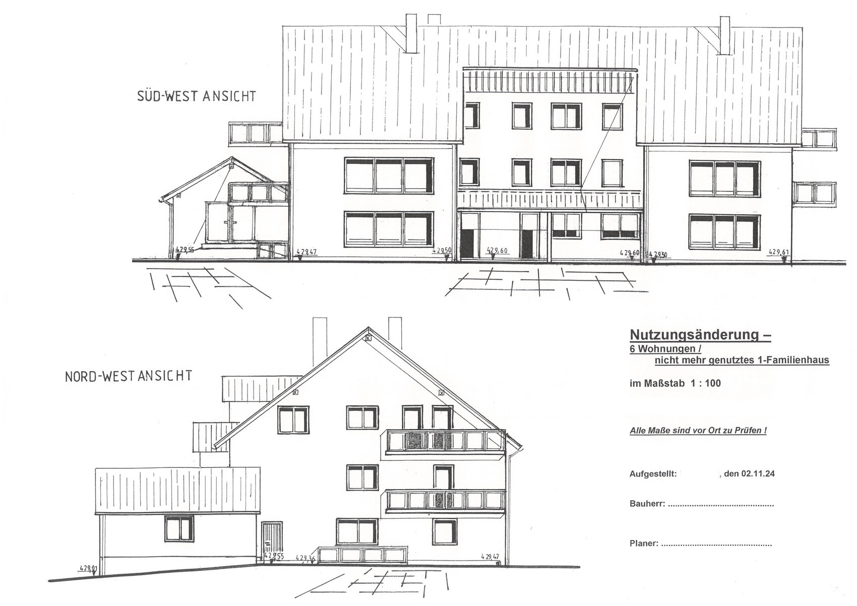

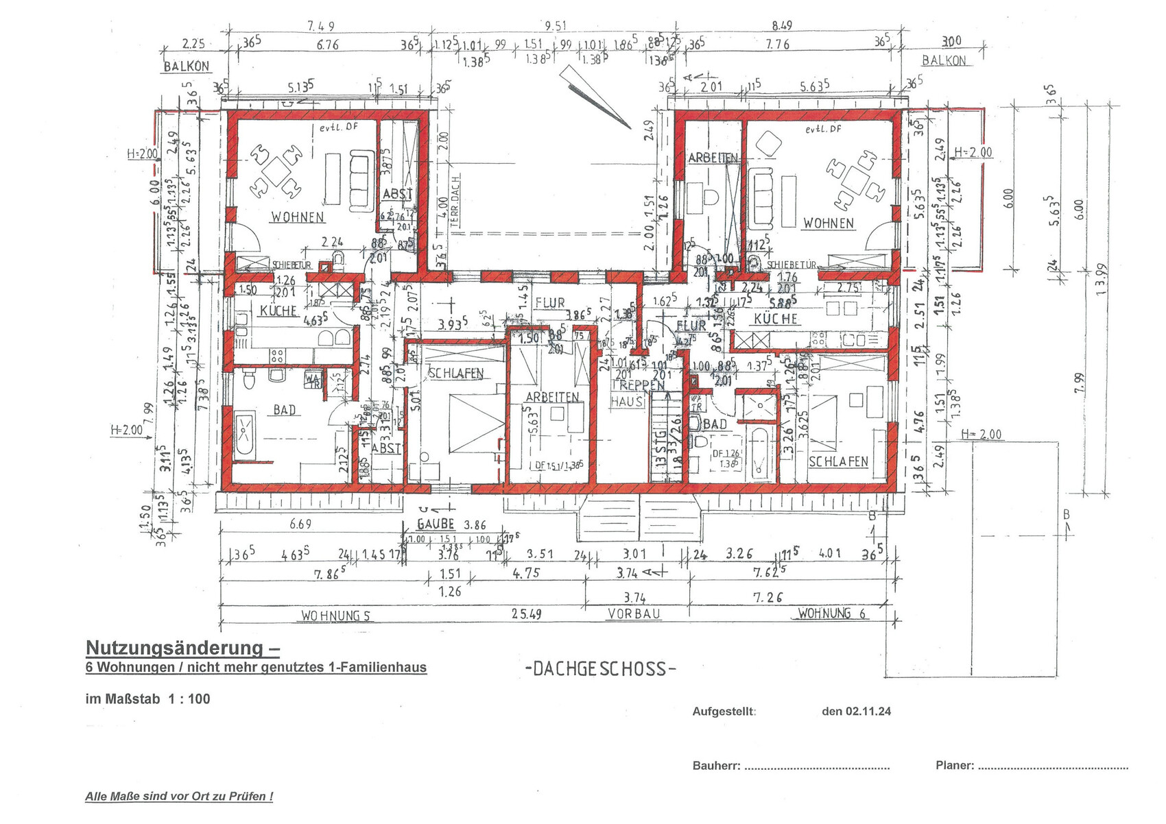

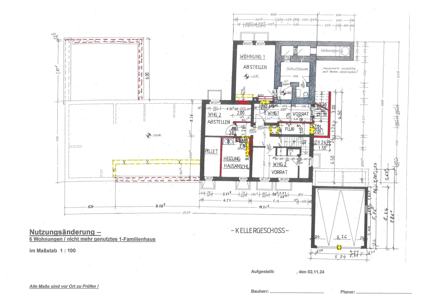

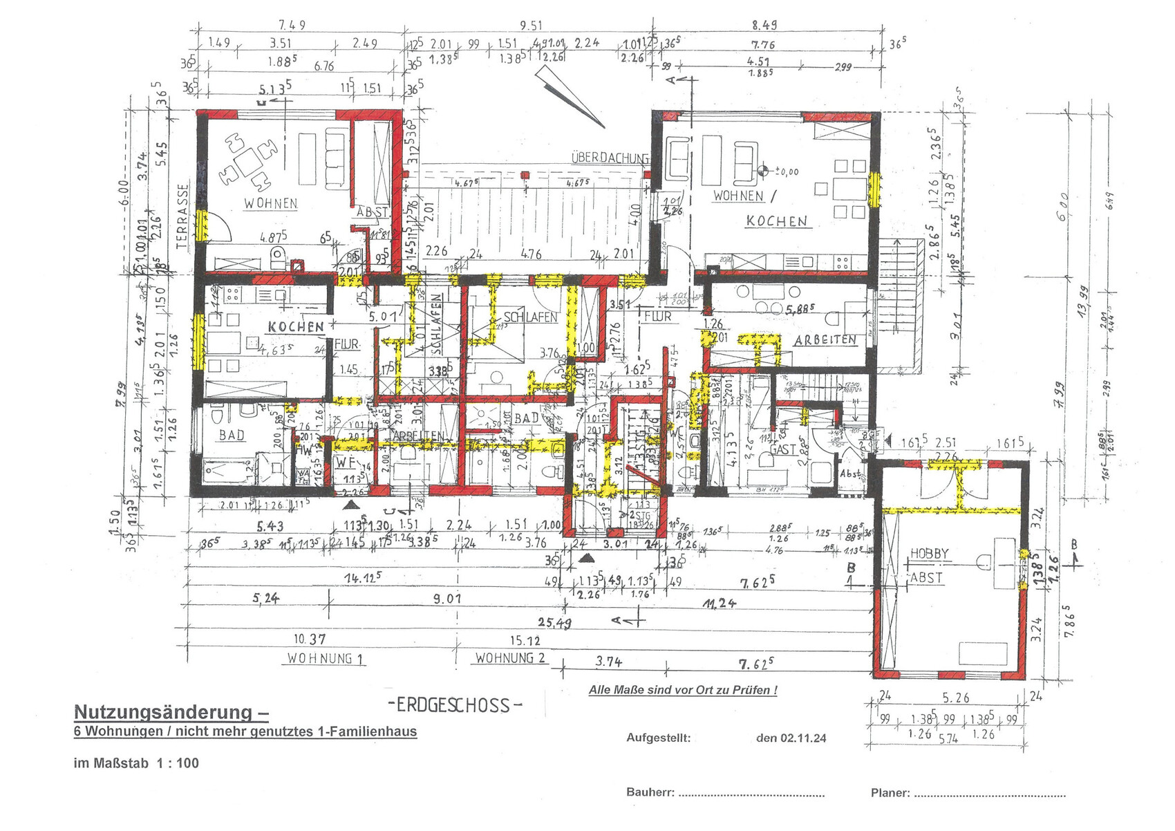

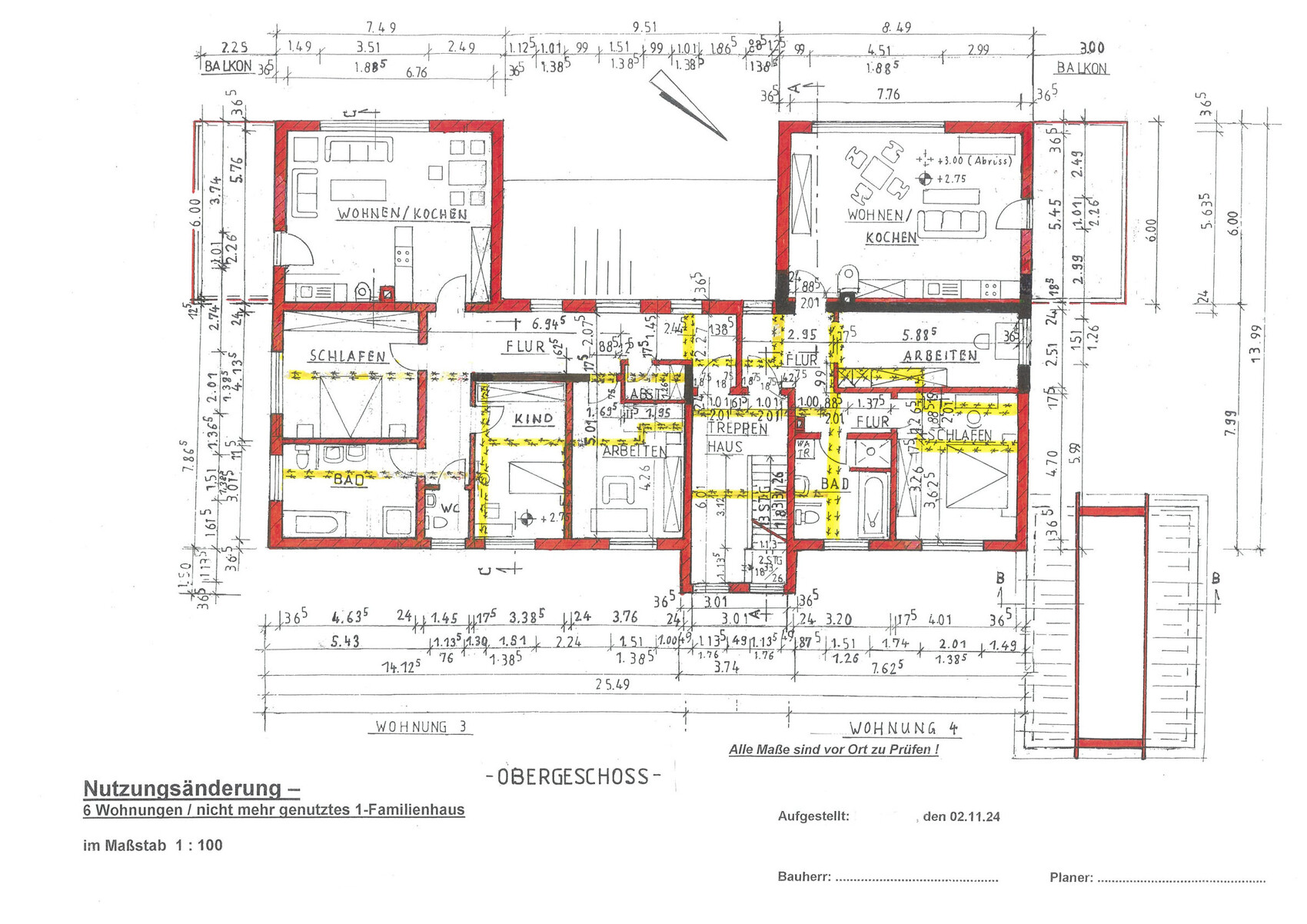

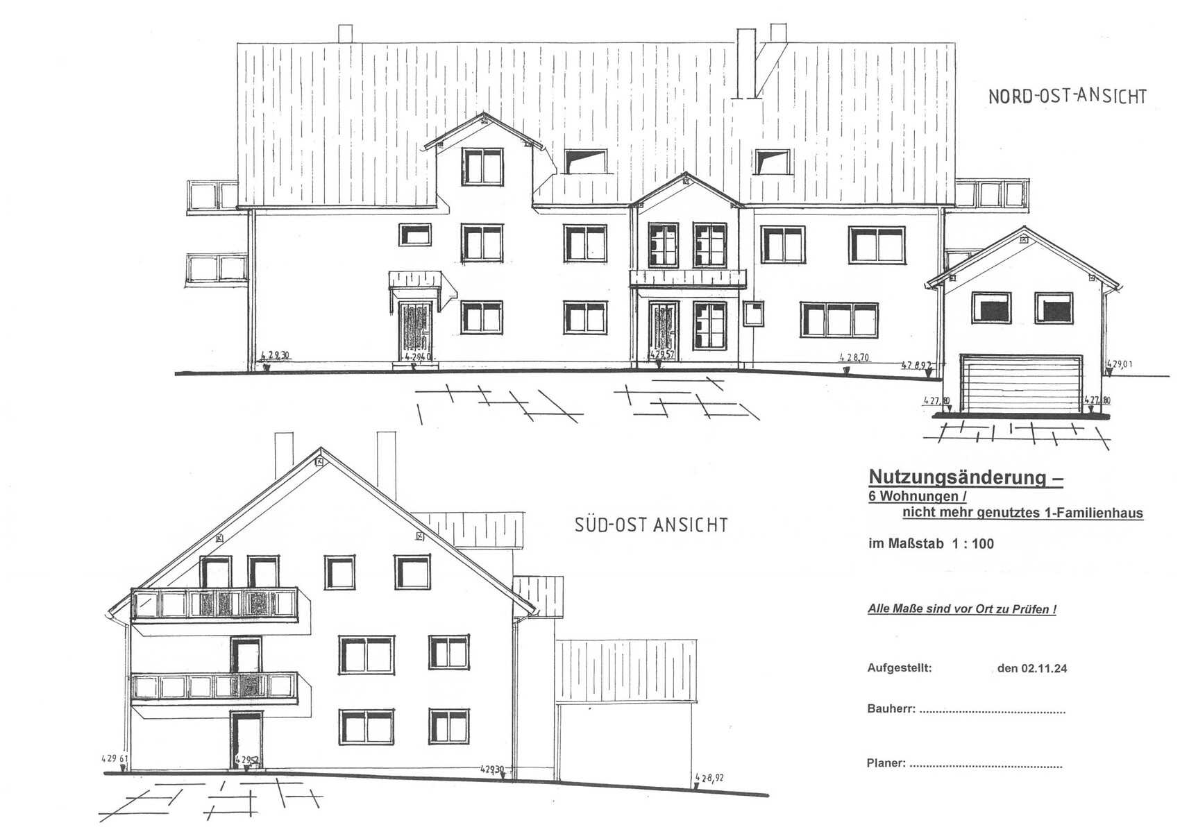

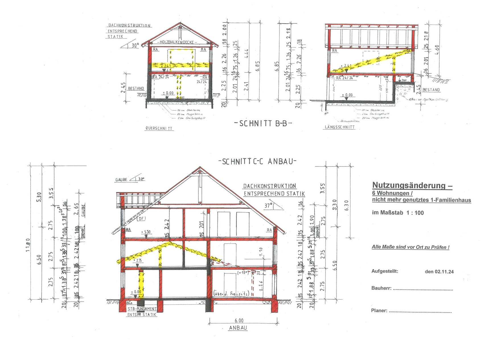

Hello dear forum members, a retired architect has designed a renovation and extension of an existing bungalow for me. I would like to compensate him for his work. Could you tell me what I would typically pay an architect for such plans? Attached are the plans. Or alternatively, what amount of time one might expect to spend on creating these plans. The architect mentioned he spent over 300 hours on them.
nordanney9 Dec 2024 12:25Addendum: In an older letter from the building authority in Bavaria, a gross hourly rate of €140 is considered appropriate for architects on an hourly wage basis. That would amount to €42,000.
This looks like a very thorough plan. The architect seems to be from an older generation, as many places include masonry walls where lightweight partition walls would typically be the preferred option today. Please share some images (drawings or photos) of the current state; I find it hard to envision some of the components, meaning the "as is and remains" (= black) designation isn’t entirely convincing.
The value of the planning for you ultimately depends on whether the design is likely to receive approval. If that is the case, I don’t see any reason to pay less than the market rate or the standard fee schedule. I would use the schedule value for a new build as the benchmark, which would already be a favorable price compared to renovating an existing building. Also, appoint the architect as the construction manager!
However, the significant increase in building volume and height makes me doubt that this design will be approved. Where is the parking provision proof (I count seven missing spaces)? Also, the amount of new construction will likely cause the existing building protection based on the original construction year to no longer apply, meaning compliance with GEG2025 (which realistically can’t start this year) would be required, including photovoltaic installation. What has the architect done in this regard? If only design phases 3 and 4 were completed, my above suggestion obviously does not apply to the full scope of phases 1 to 4.
