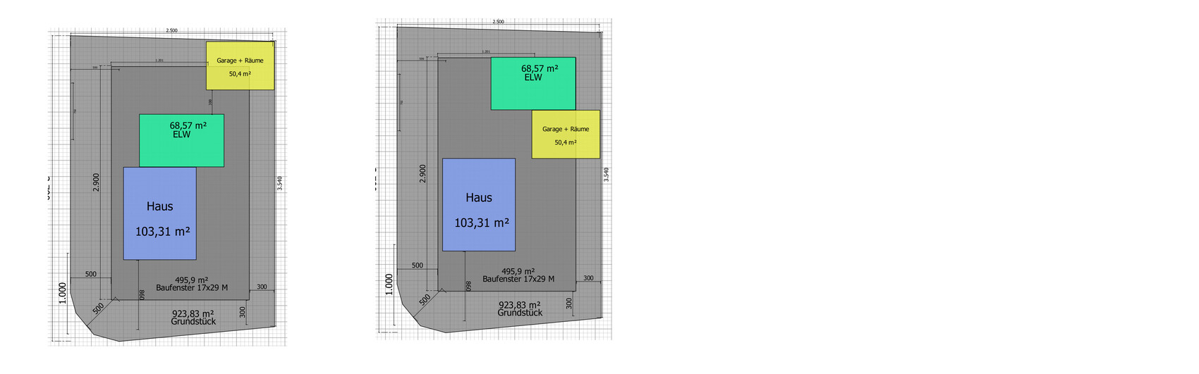

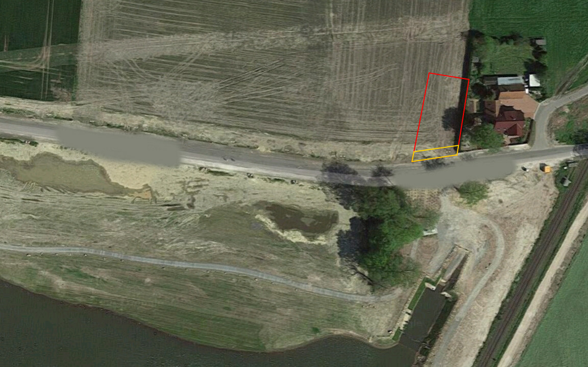

schustrik4 May 2017 17:04kbt09 schrieb:
How should I picture the bus stop and the plots 42/8 and 42/9?Here you can see that an older renovated house stands to the right, and the bus stop is marked in yellow.
But I find the plot quite acceptable, you just have to be open-minded and not get too fixed on something.Exactly, and that is what we want to do now.
- We want to place the garage entirely in the northeast, right at the boundary, with the main house designed as a townhouse and the granny flat to the left, so there is also a longer, wide courtyard.
- The kitchen does not need to be at the front facing the street.
- The choice of staircase does not matter.
- The sauna does not need to be inside the house; if at all, it should be in an extension near the garage, along with a small toilet.
What should remain is that the front door is centrally located at the front of the house and the granny flat is to the left of the single-family home, slightly set back by 1–2 meters (3–6 feet). Both the single-family house and the granny flat have a hipped roof, and the garage has a flat roof. For example, these two layouts.
schustrik schrieb:
-The sauna doesn’t need to be inside the house since, if anywhere, it should be in the addition by the garage, just like a small toilet.That won’t work. With boundary construction, living spaces are not permitted.
schustrik schrieb:
What should remain is that the front door is centered on the front of the house, and the accessory apartment should be to the left of the single-family house, set back about 1-2 meters (3-6 feet). Both the single-family house and the accessory apartment have a hip roof, and the garage has a flat roof.It’s one or the other. If the front door is centered on the main house, but the main house itself is not centered within the whole layout, it will look off.
Imagine what you’re planning as a face: both ears on the same side. The nose in the middle doesn’t save the symmetry.
Place the main house in the center. Give both side structures the same roof style. Set both outbuildings apart from the main building (or at least the garage far enough so that the center of the main house aligns with the overall center, taking into account the outer edges of the group).
That way, the entire ensemble visually looks balanced again — which it actually did in the design from kbt09.
