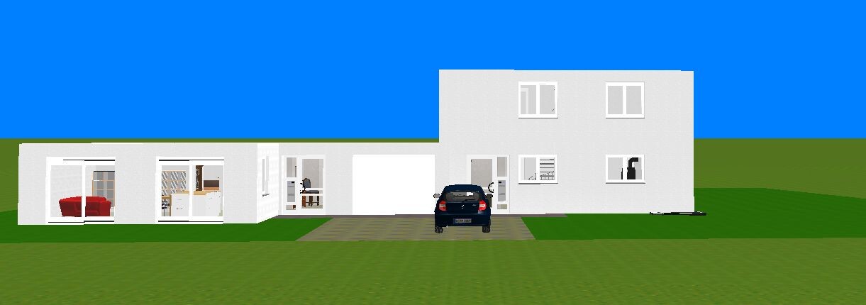

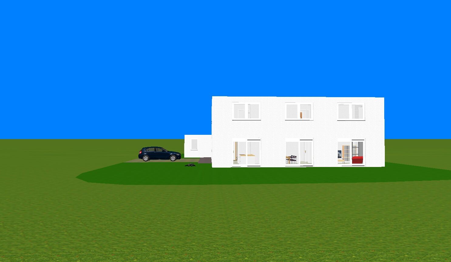

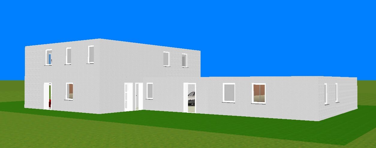

Views ... just without the roof for now. I have widened the garage door here to 300 cm (10 feet).
Partition walls should be possible to install in the living/dining/kitchen area. I would always make the living area separable and keep the dining/kitchen combined. This saves large special dining spaces.

Print out the floor plans, mark the walls with a pencil, scan it, and share the view here.
For a straight staircase with a landing, the staircase as drawn is not long enough and then causes new issues on the upper floor. This is generally a tricky point—you always have to consider things in context. However, the staircase as drawn now would also be very generous as a spiral staircase and not comparable to the small, narrow staircases often shown as discouraging examples.
The fact that the secondary apartment extends about 300 cm (10 feet) to the west serves to allow the kitchen window of the open-plan living area to still capture southern sunlight.
But as I said, just sketch it out.
