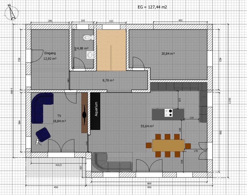

- could you not do without: large entrance/wardrobe; large children’s rooms; master bedroom facing east (I want to watch the sunrise); large aquarium as a highlight in the living area; platform staircase; children’s bathroom; and my wife absolutely wants a gallery.
Why did the design turn out as it is now?
I looked at almost every floor plan from all prefabricated house manufacturers and, annoyed by the “cookie-cutter” designs (keyword: living room/kitchen/dining all in one long corridor and stairs always immediately by the dirty entrance), I started working out my own floor plan. Many thanks to this forum because I have learned a lot from the floor plan discussions here! I even dealt with Feng Shui for the layout.
The rooms are ideally oriented to the sun: living spaces face south, unoccupied rooms face north. In addition, the slight slope (to the east) allows for nice walk-out basement rooms. The layout can also be easily split into two apartments, making it flexible for a barrier-free future. Technical aspects and piping were also considered: the utility room is on the street side and pipes/water lines don’t run erratically but are kept close together.
The only downside I see is that the kitchen is “far” from the entrance. However, I don’t find this very problematic and only mention it because it would probably be a common criticism.
I’m grateful for suggestions or optimizations of any kind! Especially tips for the master bathroom. I’m not 100% satisfied yet.

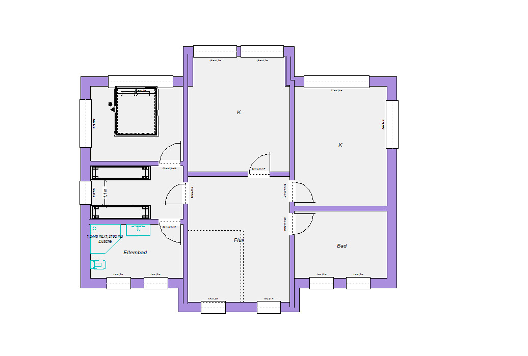

I find it difficult to place the bedroom facing east here, as it would make the parents’ area relatively cramped. Also, the bed would end up under the window — you could remove the window, but that would spoil the exterior appearance. Hmm. Why does the bedroom really have to face east again?

Traumhaus202014 Feb 2019 09:52Man, oh man, now I have to explain to all you “no-basement builders” why we want our bedroom to face east.
If you’re vampires who zombie-walk to the bathroom after the alarm goes off, quickly get ready, gulp down a coffee, and rush off to work, then sure, the bedroom orientation doesn’t really matter. But if you want to enjoy some of the morning sun or the early sky, you should face east.
You obviously can’t know the other two reasons:
The view to the east overlooks a very well-maintained Japanese-style garden next door, which is really beautiful.
My wife and I have found that when we sleep with our heads facing west, we sleep best (even despite disruptions like having a door at the head of the bed). Interestingly, when I looked into Feng Shui, it turned out that we are both “westerners” and our ideal orientation is east-west…
Need more reasons, or is the east topic settled now?

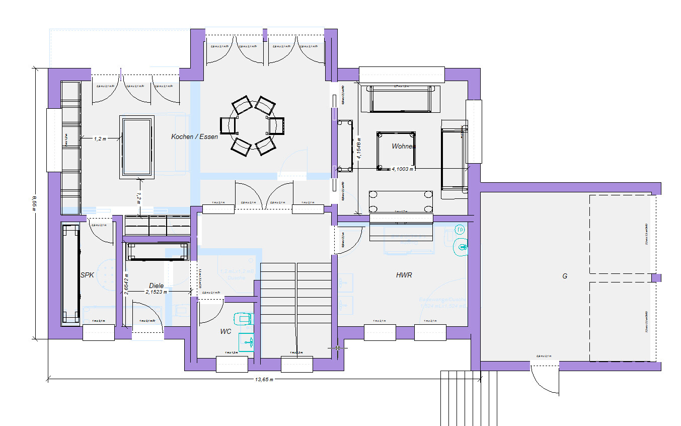

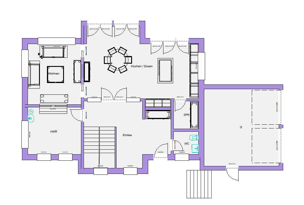

The garden would be a reason to mirror the ground floor.
In the evening, you can also enjoy the view from the living room. From the ground floor, the garden is not very visible because of shrubs and the fence.
And it’s not that great that the entire house has to be oriented around that. Our garden will also be very nice.

In the evening, you can also enjoy the view from the living room. Of course, you could mirror everything so that the bed faces east:
But then you have to walk all around the house to get to the entrance, and lowering the garage is also not a great idea in my opinion.
