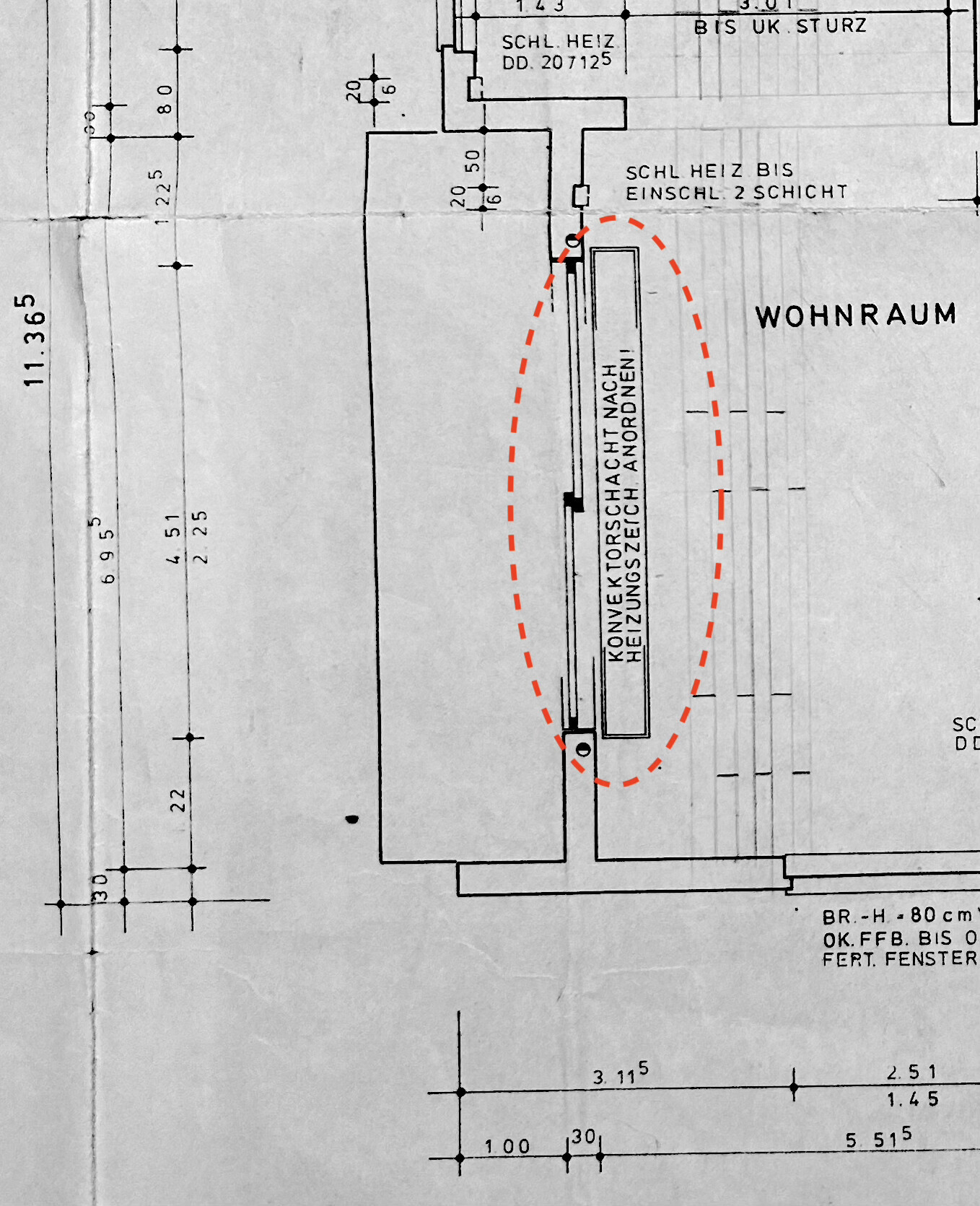

in the living room, in front of the patio door, there is a concrete slab (probably) poured over a length of 460cm (180 inches).

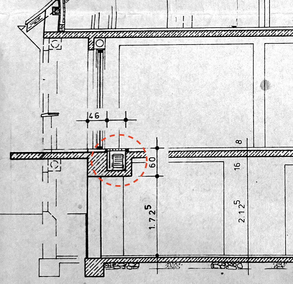

In the basement area, this massive structure is obviously a problem.
What do you think—is there any chance of removing it? The ceiling would no longer be supported at the wall. I’m not sure if a steel beam along the edge would be sufficient. Before I hire a structural engineer, I wanted to get some opinions on whether it might even be worth it.
Also, how much effort does it usually take to remove a 16cm (6 inch) thick concrete slab? Especially, how would one go about it?

ajokr202528 Oct 2025 07:28Structurally, the steel beam must be extended on both sides up to the next wall and supported there, or a bearing must be set into the wall. Unfortunately, I cannot provide any information regarding the costs.
hanghaus202328 Oct 2025 08:48With a height of 2.12 m (7 feet), this is not permitted as living space. What is the point of the effort?
Of course, it can be demolished. Ask a structural engineer how this could be done. Then let us know here. Costs can be estimated once you know what will be built.

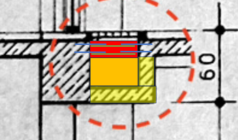

hanghaus202328 Oct 2025 09:09Possibly like this: Construction process.
Install formwork (orange)
Create rebar connections with embedded rebar (blue)
Install reinforcement (green)
Pour concrete (red)
After 3 weeks, break out the concrete (yellow)
Plaster the demolition edges.
It doesn’t get cheaper than this.
Roughly 5k plus planning and structural engineer.
Pour concrete (red)
