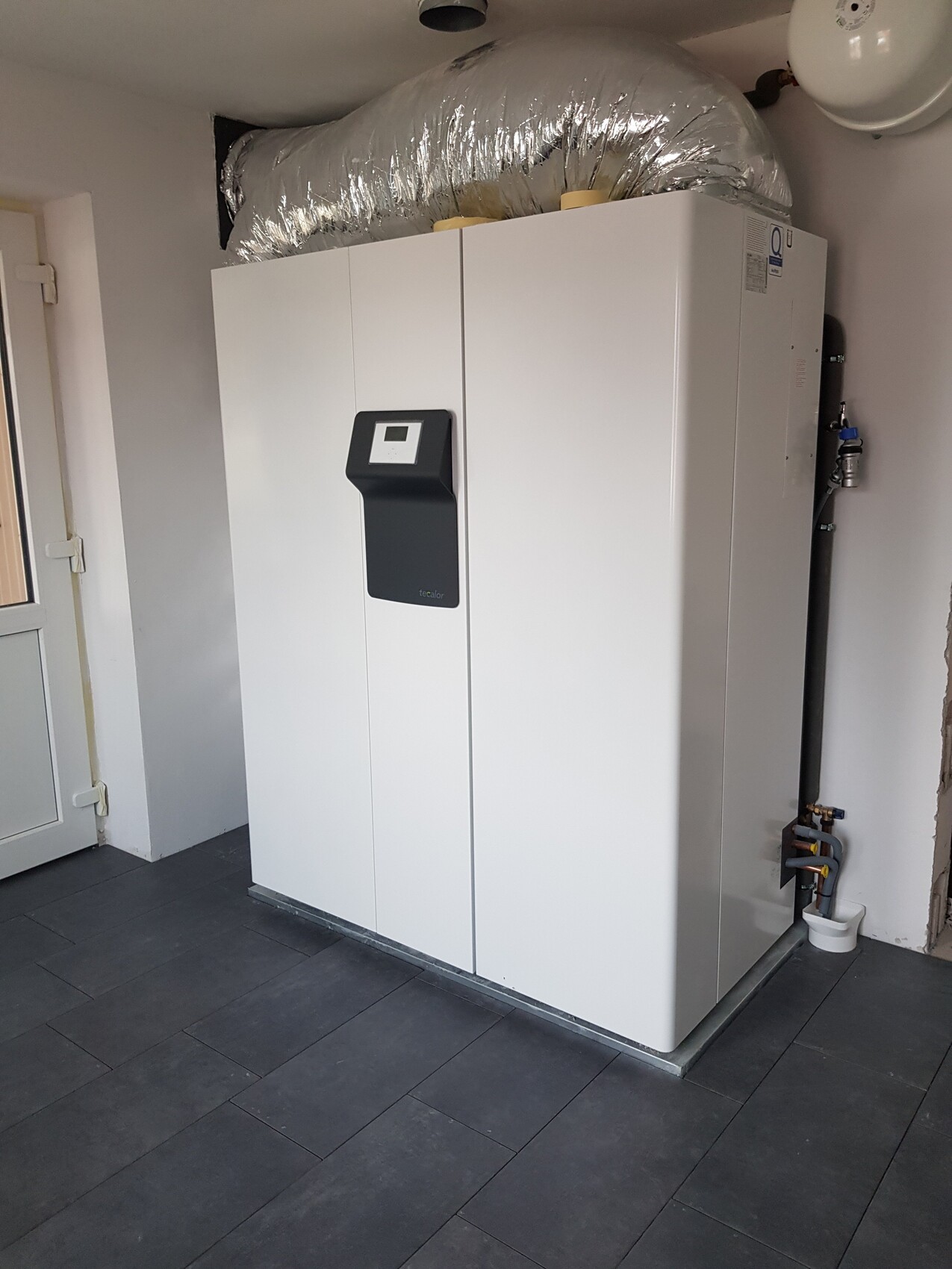

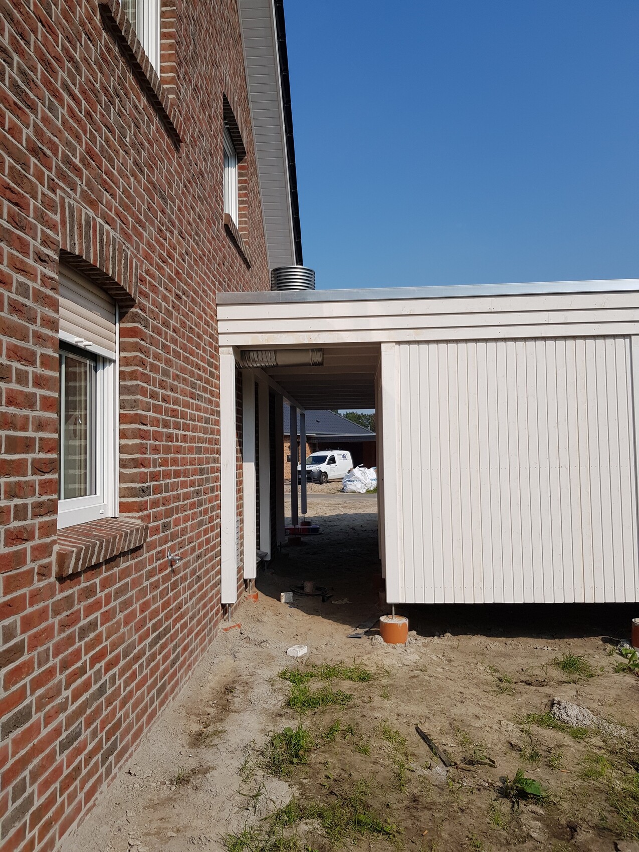

Our "Tecalörchen," shown once from the inside and once from the outside. For us, the fresh air supply was routed over the carport because we didn’t want a large hole in the front wall of the house.

Tolentino20 Jan 2022 15:44
It’s quite a bulky piece. It wouldn’t work for me. I need the separation of the units...
kati133720 Jan 2022 15:46
Yes, and at the time this photo was taken, the ventilation system was not yet connected. Insulated ducts are now running along the ceiling where you can see this opening.
