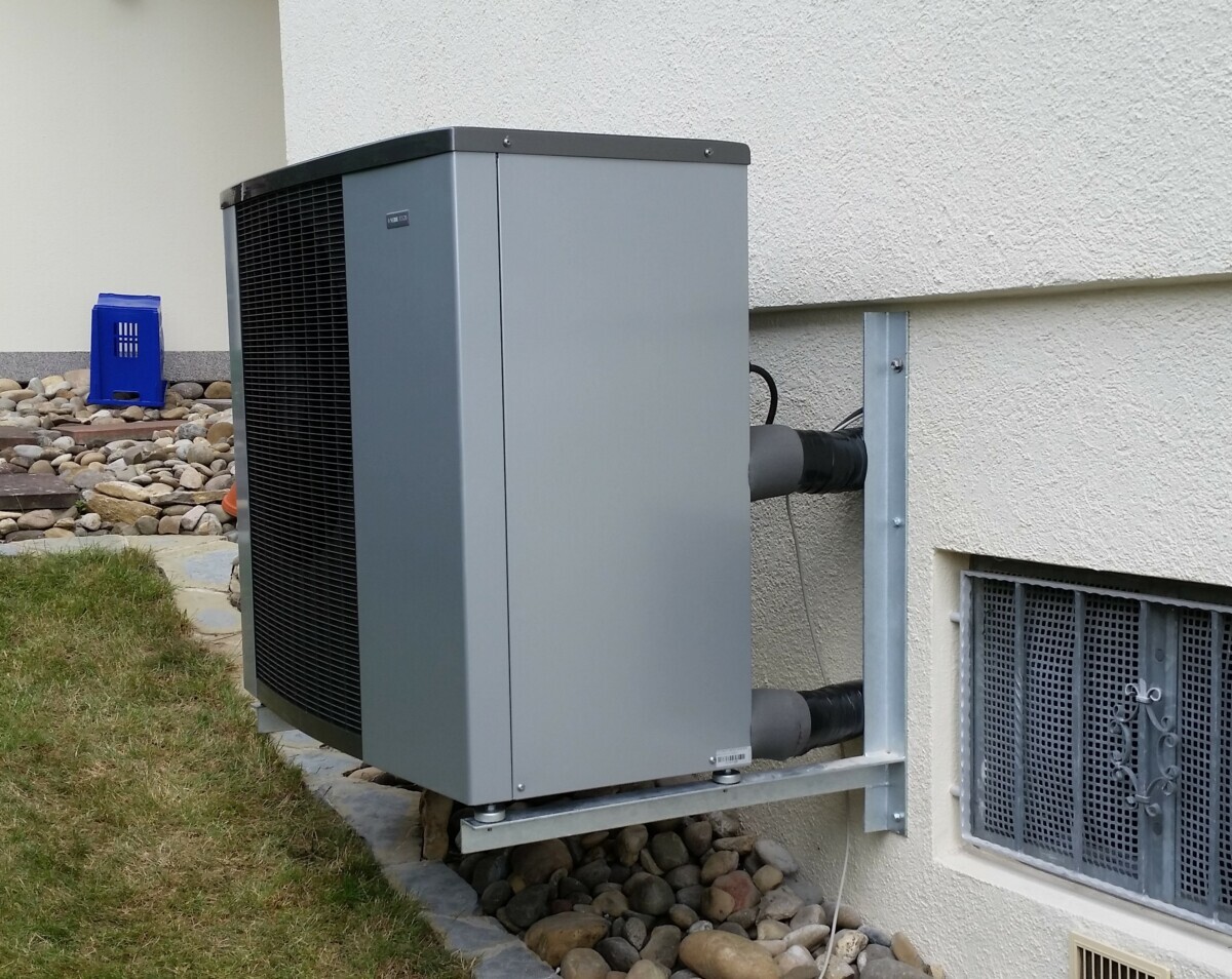

Here, take a look. Exactly your system:
Nibe F2120-12 heat pump with 600 l (160 gal) buffer tank
Wall mounting for the outdoor unit
Admittedly, it’s not a very neat solution and it can definitely be done better, but it’s on the wall:

@Mycraft: Thanks for the picture. I still haven’t understood where I’m supposed to hang the pump? As mentioned, the back wall has the children’s rooms with floor-to-ceiling windows. Hanging the unit there doesn’t seem ideal.

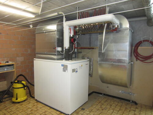

Mycraft20 Jan 2022 15:12
Then the only real option left is the indoor installation of an air-to-water heat pump, not an exhaust air heat pump!
It looks something like this, and you will need more space in the utility room as well as slightly larger ventilation ducts and openings in the exterior wall to allow for air circulation.
