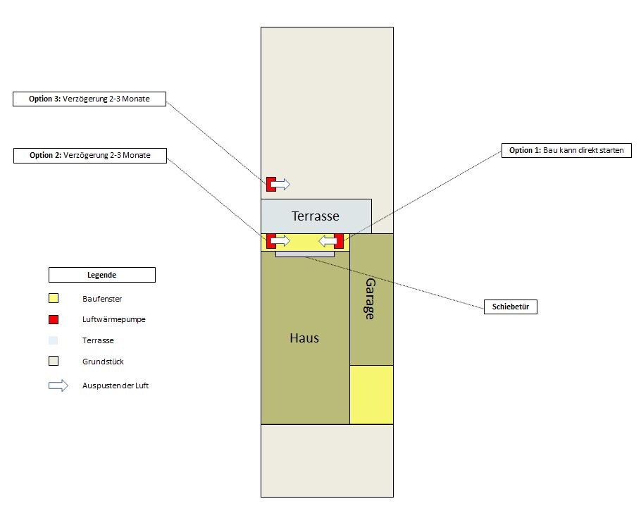

This week, we met with our builder. The following options were proposed:
1. Indoor installation using an exhaust air heat pump (Nibe F750 / no delay or additional costs)
2. Ground source heat pump (additional cost of 15,000€; possibly more if bedrock is encountered / no delay)
3. Alternative locations for the air-to-water heat pump (see below)
We are currently uncertain about which option is best. Ground source heat is only an option for us if the costs are capped, as we did not budget for the extra expenses and prefer not to use up our contingency fund right at the start.
At the moment, we are leaning towards option 3 (alternative location), specifically choice 1. The question is whether these locations are suitable if we maintain the required distances (e.g., 30-40cm (12-16 inches) from the garage and house) or if I might encounter issues such as thermal short-circuiting or increased noise disturbances.
I am open to suggestions and feedback.

ConnyJash20 Jan 2022 10:42The setback distance to the neighbor is not being maintained. There is noise disturbance because the building would then be located between two house walls. The architect also states that this is not permitted.
Placement on the boundary line with the neighbor on the right is not possible, as the neighbor does not consent.
ConnyJash20 Jan 2022 10:58We asked whether the outdoor unit can be "mounted." According to the architect, this is not possible. Additionally, the outdoor unit would then hang outside the children's room window.
Deliverer20 Jan 2022 11:00Is there a reason why all the exhaust directions are to the left or right? Why not away from the house?
And I’ve asked before: why not towards the street? With refrigerant lines, it shouldn’t be a problem to run them under the foundation slab.
By the way, option 1 is not a good option.
