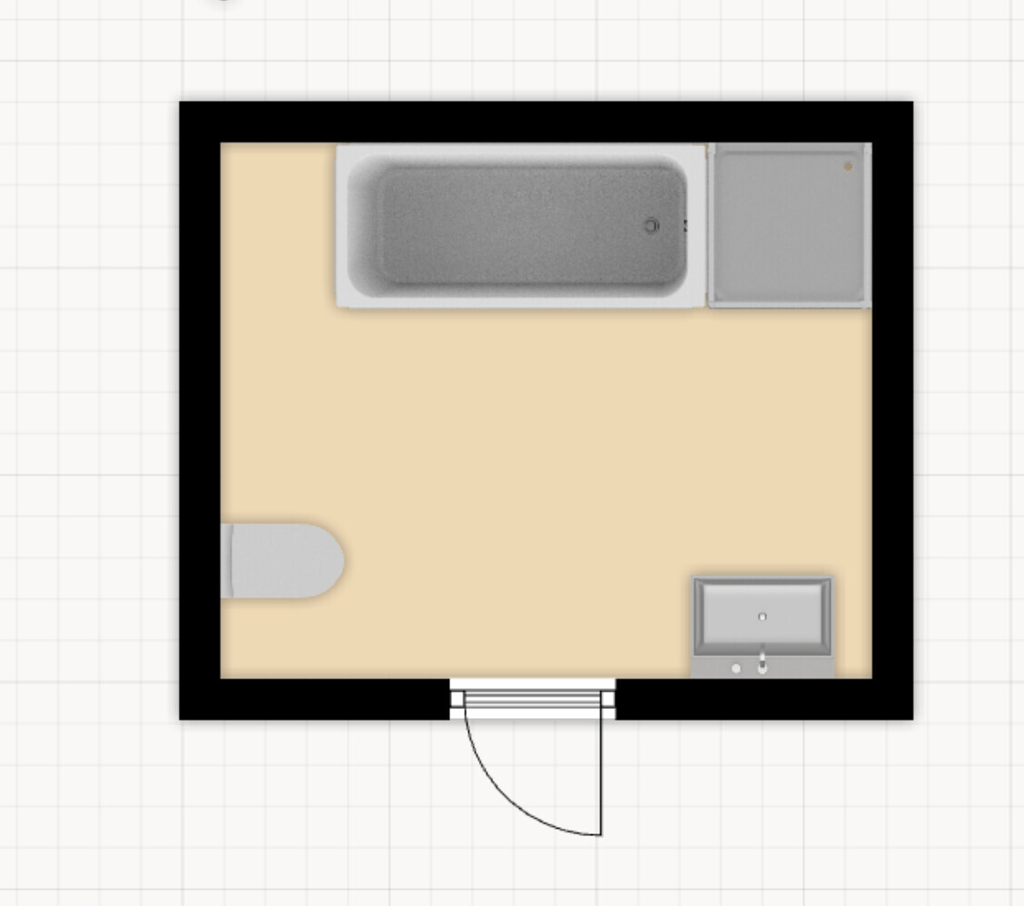

Myrna_Loy
25 Oct 2021 15:56
I would do it like this: And take 30 cm (12 inches) from the hallway.
Bathroom floor plan: Bathtub at the top, toilet on the left, sink at the bottom right, door at the bottom.
