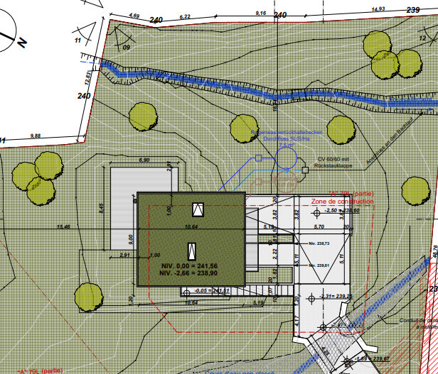

Furthermore, we spent a lot of time dealing with the municipality regarding the "watercourses." In reality, there are just two small streams, but since July 2021 the municipalities have become extremely cautious. We were still in the process of purchasing the property during the flood and visited the site at that time; even then, there was only a gentle trickle. The watercourses have no natural springs and merely consist of rainwater from the few surrounding houses (maximum 10), but after a long back-and-forth, we agreed on this bridge, which will cost us around 15,000€ (about $16,000). However, we will live with a provisional pipe culvert and embankment for the first few years and complete this part eventually.

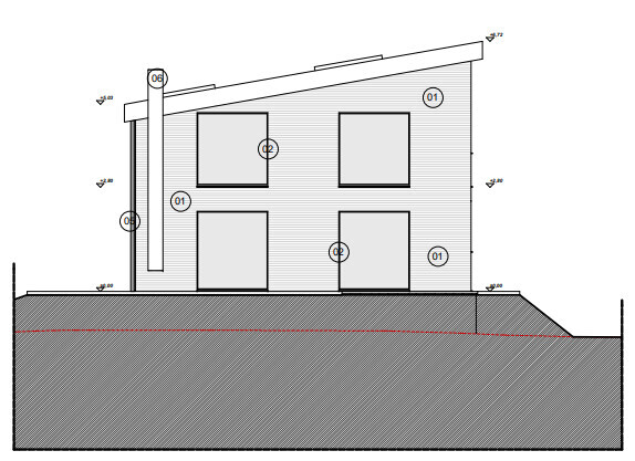

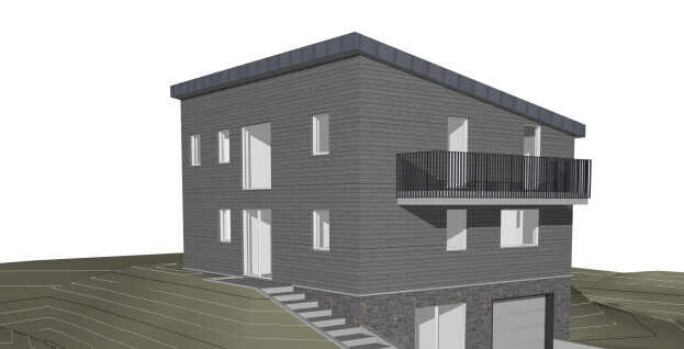

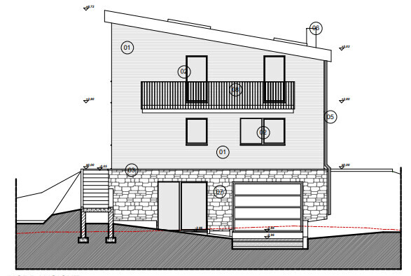

I had already asked here about the roof overhang, and as you can see, the house has changed significantly. The municipality eventually blocked the original plans because we were not allowed to build up the terrain so heavily. The German architect we had was unable to produce proper site plans, so this issue only came up quite late, and we had to completely redesign in April this year because we needed to reduce the size considerably and could no longer build a garage. Hence, the basement and a more compact house.

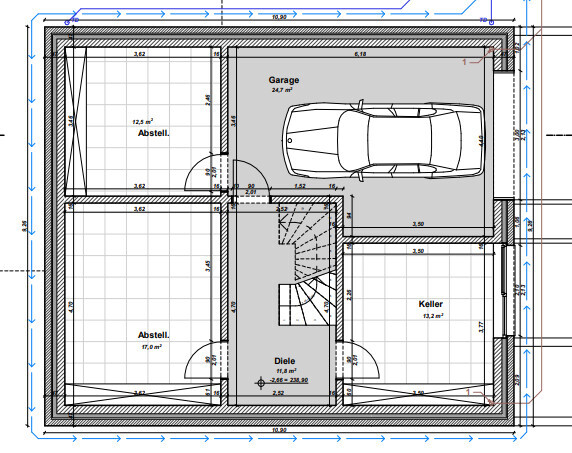

The basement naturally costs more than a simple slab foundation, but since we might have needed deep foundation anyway due to the slope, the additional cost is probably manageable (I never had a concrete offer for the pile foundation, but it was expected to be very expensive).

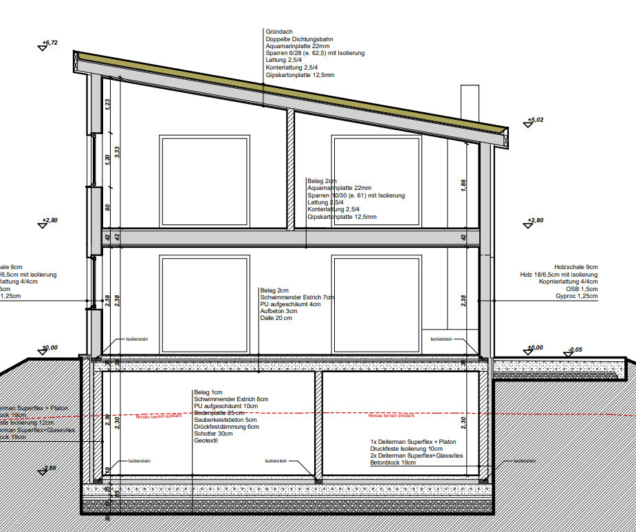

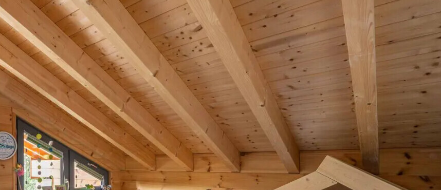

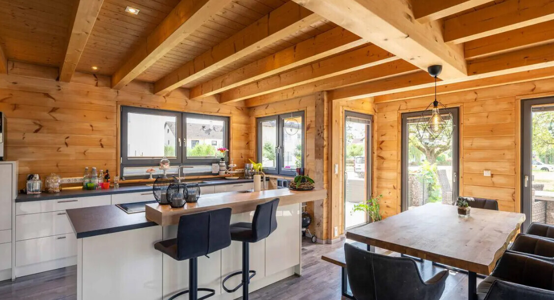

On average, you can see the ceiling heights, insulation of the exterior walls and basement. The ceilings are still incorrectly shown in the plans; they will be exposed wood, as shown in the attached pictures.

The plans show average ceiling heights, insulation of the exterior walls, and the basement. The ceilings are incorrectly depicted in the plans; they will be exposed timber beams, as shown in the attached photos.

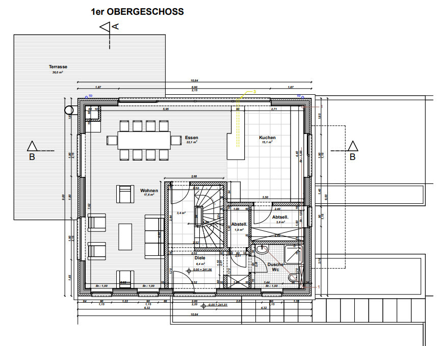

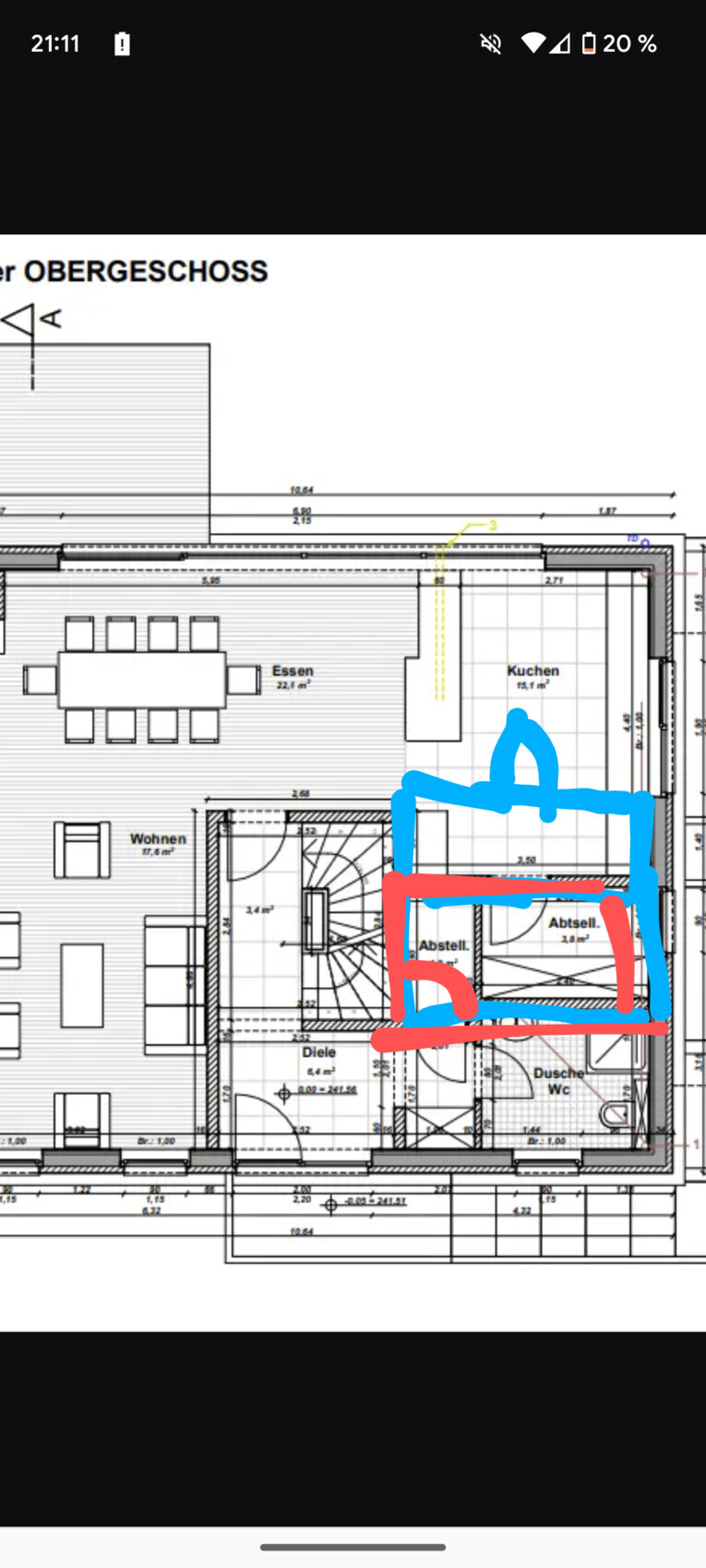

If anyone has questions or suggestions regarding our plans, feel free to ask! I look forward to your comments! I find the two storage rooms to be overly complicated. How about making one storage room as kitchen cabinets—some of which could be walk-in. You probably don't need that much space in the kitchen anyway. The other storage room could be used as a room, which could serve as storage, an office, guest room, etc.
I wouldn’t consider the small stream as irrelevant as it might seem. If rainwater from neighboring properties flows through it, that would definitely raise alarm bells for me. Flooding isn’t just flooding. Climate scientists agree that extreme weather events are becoming more frequent. If you have an extremely dry summer and the soil dries out significantly, followed by an extreme weather event such as a very heavy rainfall (see flood zones: sometimes an entire year’s worth of rain falls in one day), the soil can’t absorb this water because it’s too dry, and your small stream could potentially take your whole house with it :/
I would not underestimate the small stream either. In our municipality, the results of flash flood management have been available for over a year. According to this, our little creek is expected to reach a height less than 2 km (1.2 miles) from its source. Unimaginable. Many people do nothing because the water has never been that high before.

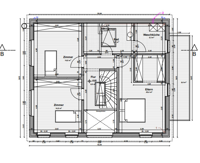

Regarding the floor plan, a completed questionnaire would be helpful. I find the walk-in closet in the master bedroom just a dark, unusable space. Does the bathroom not have a bathtub?
Please draw the desired or existing furniture to scale in all rooms. In the open-plan area, I miss space for a wardrobe, shelves, TV, etc.
WilderSueden25 Oct 2023 09:27The problem with trickles of water is not continuous rain. The problem is a thunderstorm with extremely heavy rainfall. It comes suddenly and is gone after about half an hour. You will never see this during an inspection. There is a small stream in our village that remains inconspicuous even during heavier rain. Nevertheless, it floods the village center approximately every 50 years.
