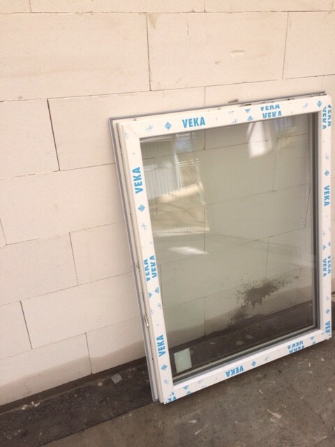

Today I also took a look at the windows that were installed this week. We chose uPVC windows with an aluminum cladding on the outside.
I have to say the windows are far from perfect. Almost every window has small scratches or dirt marks. Some of the dirt could be removed with cleaning alcohol, but others could not. In some of the panes, there are also small inclusions visible.
Sometimes the aluminum cladding has gaps that are not quite right, or you can see slightly overflowing glue.
What I find particularly odd are the lower “covers” that finish the aluminum cladding. They look like white plastic that has only been lightly painted. When closed, this is hardly visible from the outside, but it could definitely be done better. I must admit I am often quite particular. However, my future neighbors also had similar minor defects. Glass inclusions were replaced. So far, I haven’t spoken with the window manufacturer yet. We’ll see what they say. Minor flaws in the plastic might probably be polished out.
In the second photo, you can see that the miter joint of the aluminum cladding does not fit perfectly, and one part protrudes further.
