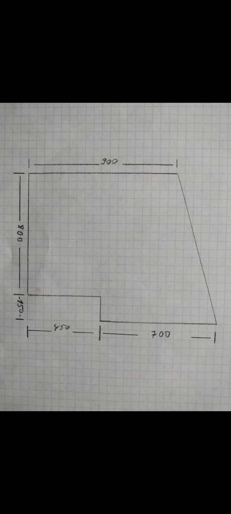

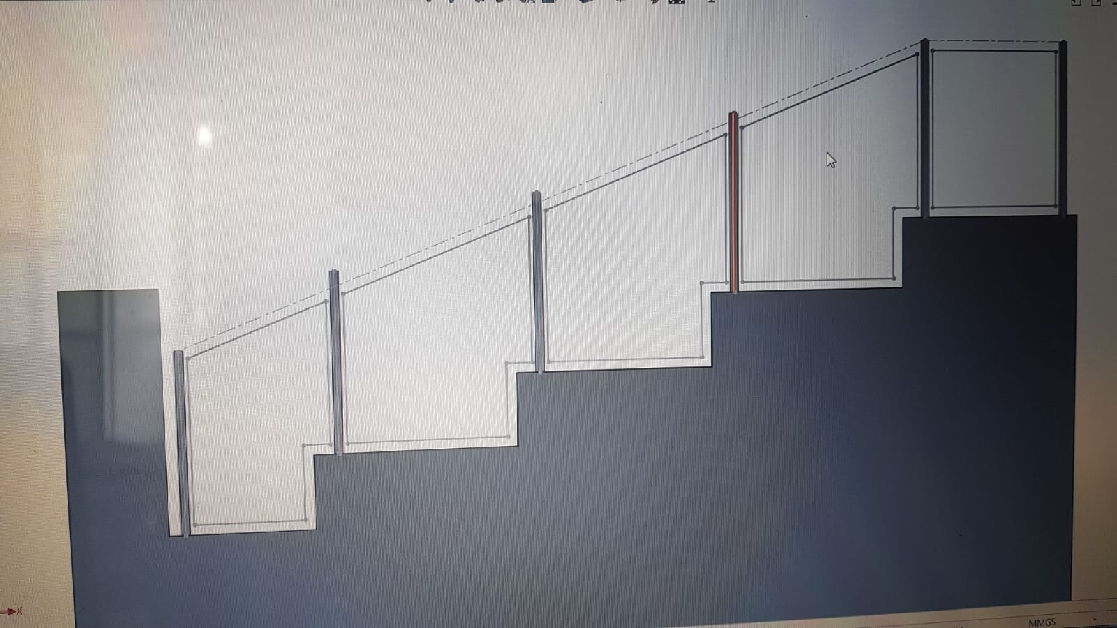

We will soon start working on our exterior staircase railing, approximately 5 meters (16.4 feet) long with steps. The cost per post for surface mounting is about 60 euros. I requested a rough quote for the glass panel; in our design, it costs around 180 euros. It is 10mm (0.4 inches) laminated safety glass with polished edges in matte white.
Don’t be confused, these are lintels, not the steps.
First, the posts will be installed, then the measurements will be taken and the rest ordered.
I estimate a maximum cost of 2000 euros for everything.
