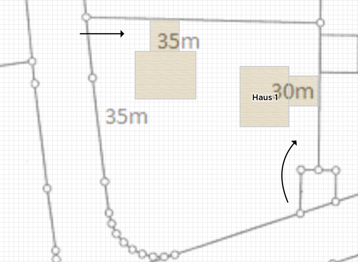

22 Mar 2022 20:58
K a t j a schrieb:
On the contrary. There is no reason to plan for two houses at all. So why would you want to ruin your plot and house?
I am certainly not a fan of suppressing dreams that are two or more generations away. But you can plan for it, as long as you don’t have to accept huge compromises. Let me put it in gaming terms, which you apparently understand: you can give up 59 and still come out ahead.
My suggestion:
Two building structures on the plan; distances 35 m, 30 m; House 1 labeled.
It should also be said: 30, 40, or 50 years later, you will have different expectations for your house. This also applies to the evening terrace.
