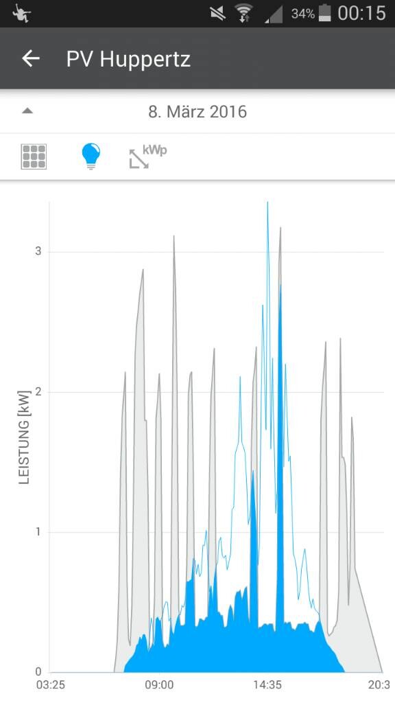

Keep in mind that the heat pump always uses electricity when the sun isn’t providing much power. Also, the heat pump requires a short burst of high electricity consumption.
Here is a typical heat pump consumption profile. Photovoltaic power does not help at all with the gray peaks.
