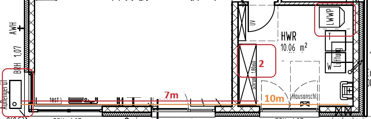

I am currently looking into the heating system. We are getting a Daikin air-to-water heat pump with a water storage tank, and I am considering which configuration would be the most sensible. I prefer not to rely solely on one opinion (general contractor) and would like to hear your thoughts. I have attached a photo showing where the outdoor unit and indoor unit are planned to be installed. To shorten the "distance," the indoor unit could also be placed at position 2.
Now the question is: given the distance, would it be better to choose a split system? I spoke with a designer from an air-to-water heat pump manufacturer who said that if we choose a monoblock, the pipes only need to be well insulated. The losses would then be very low. The distance from the outdoor unit to the nearest neighbor is about 20 meters (65 feet), so noise should not really be an issue.
Thank you very much for your opinions.

Bauenaberwie schrieb:
So, the question is: should we choose a split system because of the distance?
And what advantage would that give you?
I spoke with a designer from an air-to-water heat pump manufacturer, and they said that the pipes only need to be well insulated if we go with a monoblock system.
Are you aware that the pipes of a split system also need good insulation? Even if the requirements are less demanding.
I spoke with a designer from an air-to-water heat pump manufacturer, and they said that the pipes only need to be well insulated if we go with a monoblock system. The losses would then be very low.
Exactly. And in your case, the pipes also run inside the house, not outside.
Why not simply change the location of the outdoor unit? Whether mono or split.
Besides, there are many good insulation options. For example, for monoblock systems, district heating pipes can be used.

Ok, thanks for the information. We will prefer the mono unit then. I wasn’t aware that insulation is also required for the split unit. That makes the decision even easier. Regarding the position of the outdoor unit, it has been chosen to ensure the greatest possible distance from the neighbor and to avoid any disturbance for us. This is the case on this side. But thank you very much for the help.
