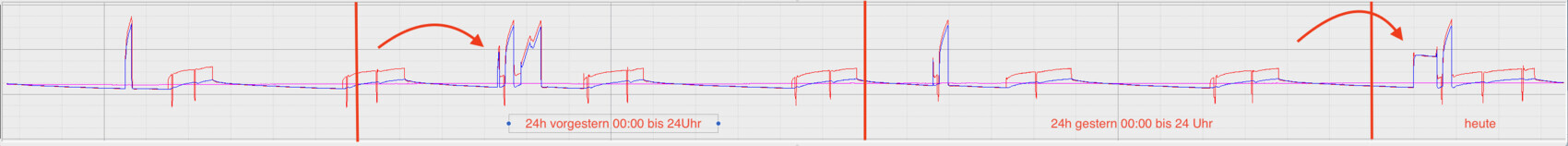

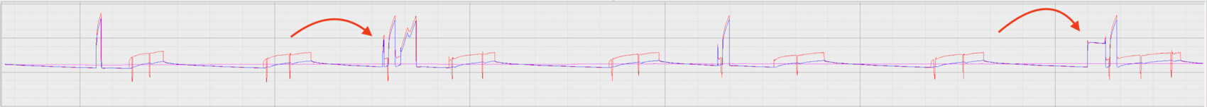

That’s what I meant earlier about the strange hot water behavior at low ambient temperatures. The hot water production usually looks like the one on the far left.
Unfortunately, there is no time scale shown here. But just the ratio between the heat pump’s operating time and idle time is quite impressive. Practically no heat is lost from the house. In my case, the heat pump runs almost continuously at -5 degrees Celsius (23°F). Sometimes it stops for about 3 hours, but then the return temperature drops by 3 degrees Celsius (5°F) and it starts running again...

10 Feb 2021 09:59
Bookstar schrieb:
Unfortunately, there is no timeline here. But just the ratio of runtime to standstill time for the heat pump is very impressive. In fact, almost no heat is lost from the house. For me, the heat pump runs almost continuously at -5 degrees Celsius (23°F). Sometimes it stops for 3 hours, but then the return temperature drops by 3 degrees Celsius (5°F) and it starts again...
I think now it’s easier to understand, including why yesterday’s 22.5 kWh was pure coincidence and why today will be higher.
Time course diagram with red peaks over three sections: the day before yesterday, yesterday, today.
