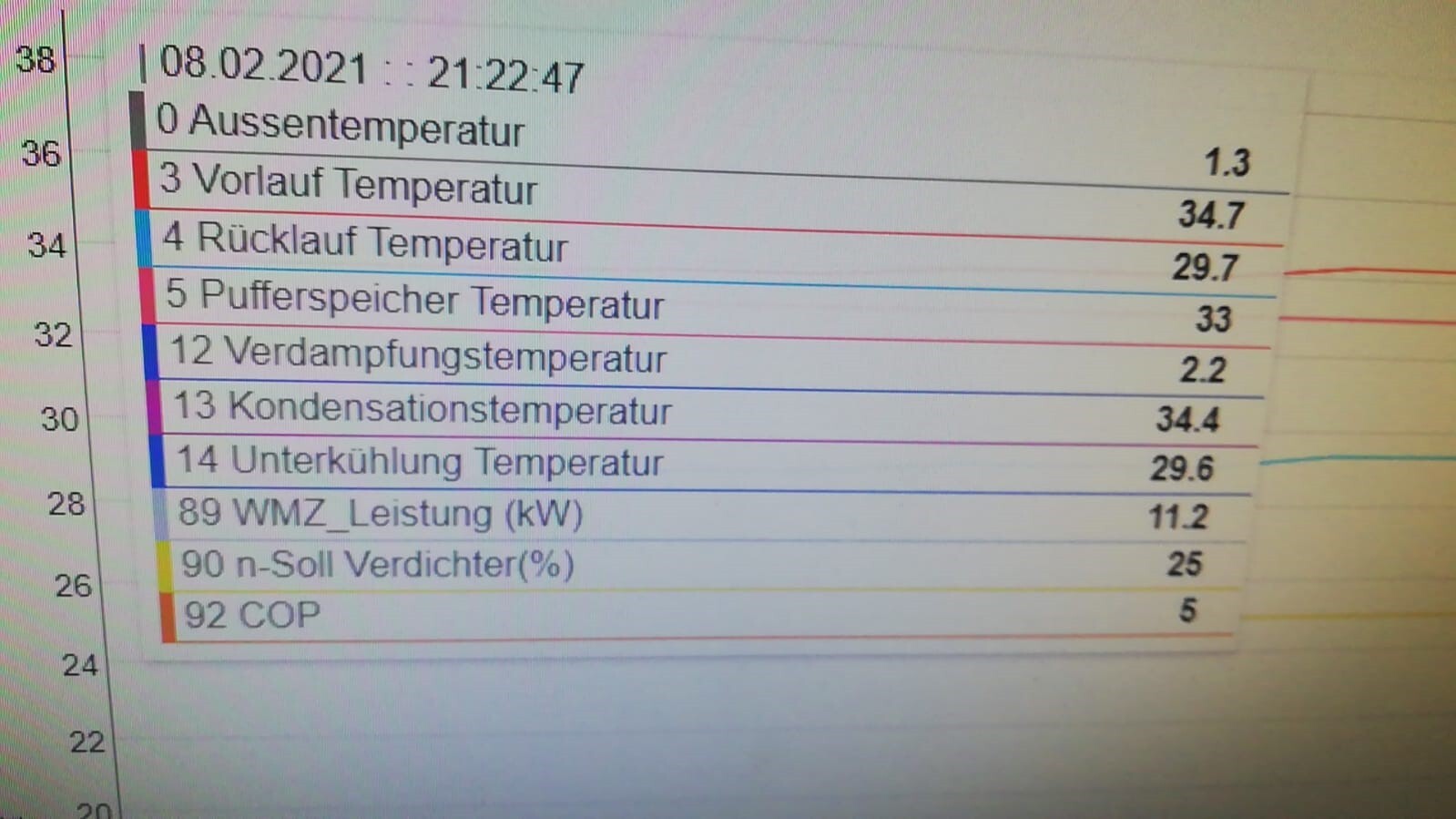

Alessandro9 Feb 2021 16:33Just as an example regarding efficiency and buffer tanks:
This system has exactly the same setup with the same hydraulics:
So it is definitely possible!
It would be quite surprising if everyone advertised seasonal performance factors over 4.5 and then required a buffer tank that completely destroys efficiency.
