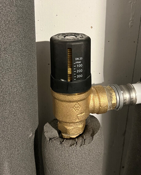

Is this the often-criticized overflow valve? At least the hydraulic line goes directly from the supply to the buffer storage tank on the return side.
It was set to 150 mbar (6 inHg) – I increased it to 250 mbar (10 inHg) and already noticed more flow reaching the upper floor. Should I continue adjusting?
Deliverer2 Nov 2021 21:44If all (or at least most) heating circuits/radiators are on and will definitely stay that way: go ahead and close them.
R
RotorMotor2 Nov 2021 21:51150 mbar (6 inHg) seems very low.
The air-to-water heat pump pump produces 640 mbar (9.3 psi), right?!
Can you turn it off completely, or is 300 mbar (4.4 psi) the maximum?
By the way, did you get an additional pump?
