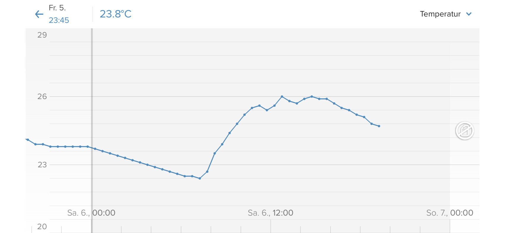

So today was one of those days again. Outside it was very cold, 0 degrees Celsius (32°F) during the day but with full sunshine. Inside the house, it was 23 degrees Celsius (73°F), almost unbearable. The heating then turned on, and we had to ventilate the whole day. In my opinion, that is a waste of energy.
But I have no idea how to counteract this. Do you do it the same way?
Bookstar schrieb:
So today was one of those days again. Outside it was very cold, around 0 degrees Celsius (32°F) during the day, but full sun all day long. Inside the house it was 23 degrees Celsius (73°F), almost unbearable. Then the heating kicked in, and we had to keep ventilating the entire day. In my opinion, that’s just a waste of energy.
But I have no idea how to avoid this. Do you deal with this the same way? For me, it was 26.1 degrees Celsius (79°F) on the ground floor today, and right now it’s 24.7 degrees Celsius (76°F). The heating has been off since 1 p.m. and won’t be switched on again until tomorrow noon.
How do I deal with it?! Well, I don’t fully ventilate and the roller shutters are kept up. Strictly speaking that’s not necessary with such sunshine since the heat comes free, but even when it’s free, it still feels like a waste.

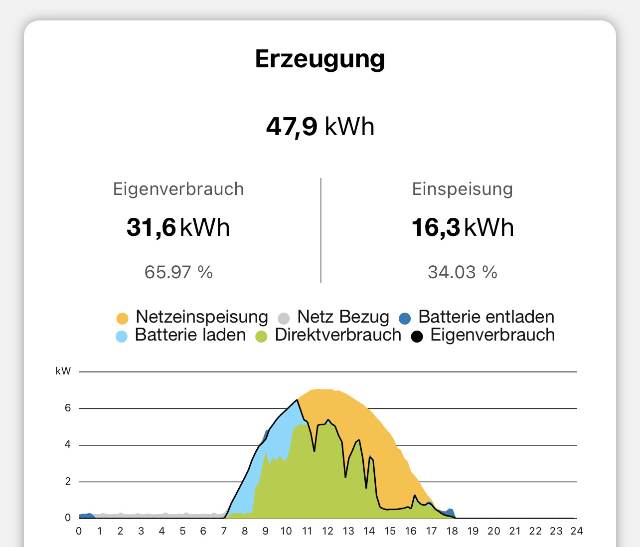

Today I tried to reduce consumption as much as possible. Yellow indicates energy fed into the grid, the rest is consumption.
