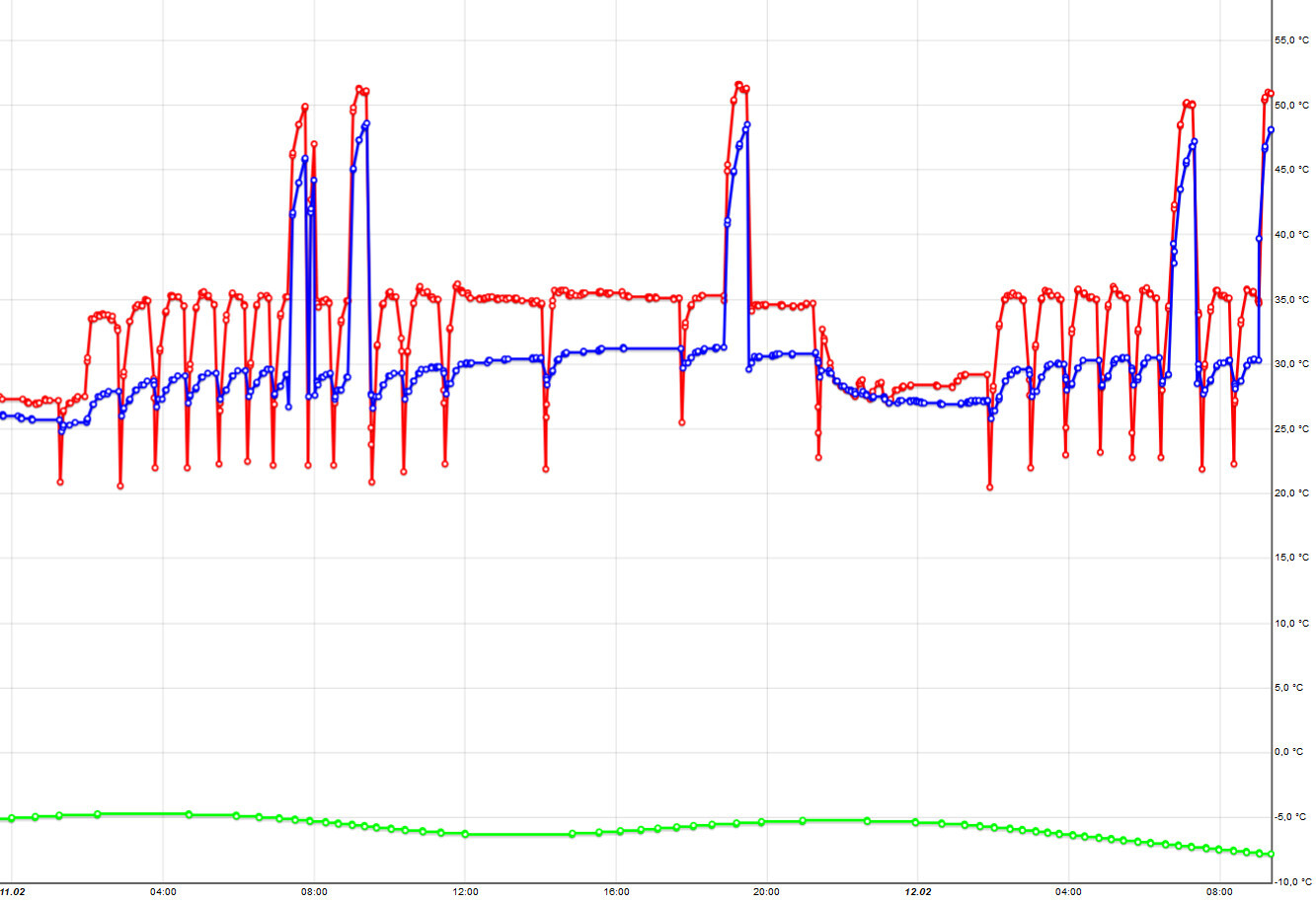

Malz1902
12 Feb 2021 09:27
Consumption from February 11 to 12 was 55 kWh total electricity usage – 10 kWh for household consumption and 45 kWh for the heat pump.
Indoor temperature was 22-23°C (72-73°F), heated area about 120 square meters (1,292 square feet).
Outdoor temperature around -10°C (14°F).
Zeitreihe von Temperaturmessungen: rote und blaue Kurven mit Spitzen, grüne Linie unten.
Red = Supply line
Blue = Return line
The peaks upwards represent domestic hot water.
