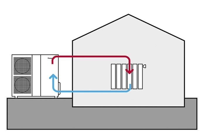

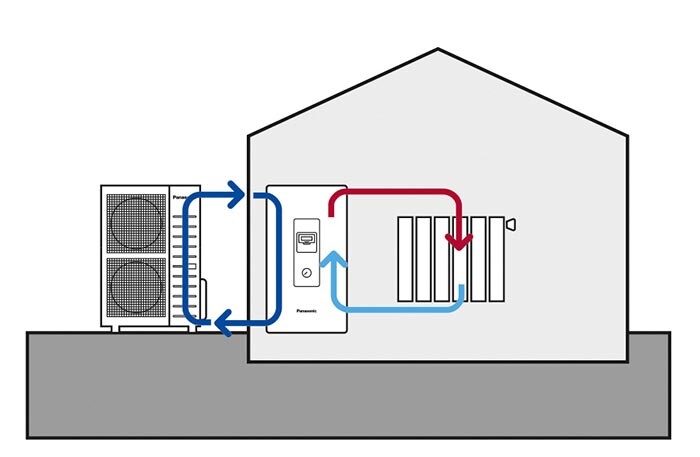

Well, it’s a matter of space. If you have a large utility room, then go for a monoblock. If you have outdoor space and no neighbors to bother, then a split system. I thought it was the other way around? Monoblock means everything is outside, while split systems still need an indoor unit.
