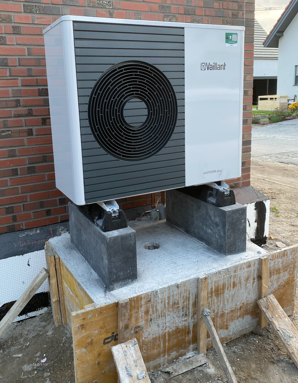

Our unit has arrived. 🙂The same model was installed here a few days ago and fully connected today. 🙂
The electrician particularly praised the cooling function, or at least spoke very positively about it, saying he is very happy with his own unit at home.
We probably won’t need the cooling function in the coming months, but now winter can come. 🙂
I’m curious to see how it performs.
