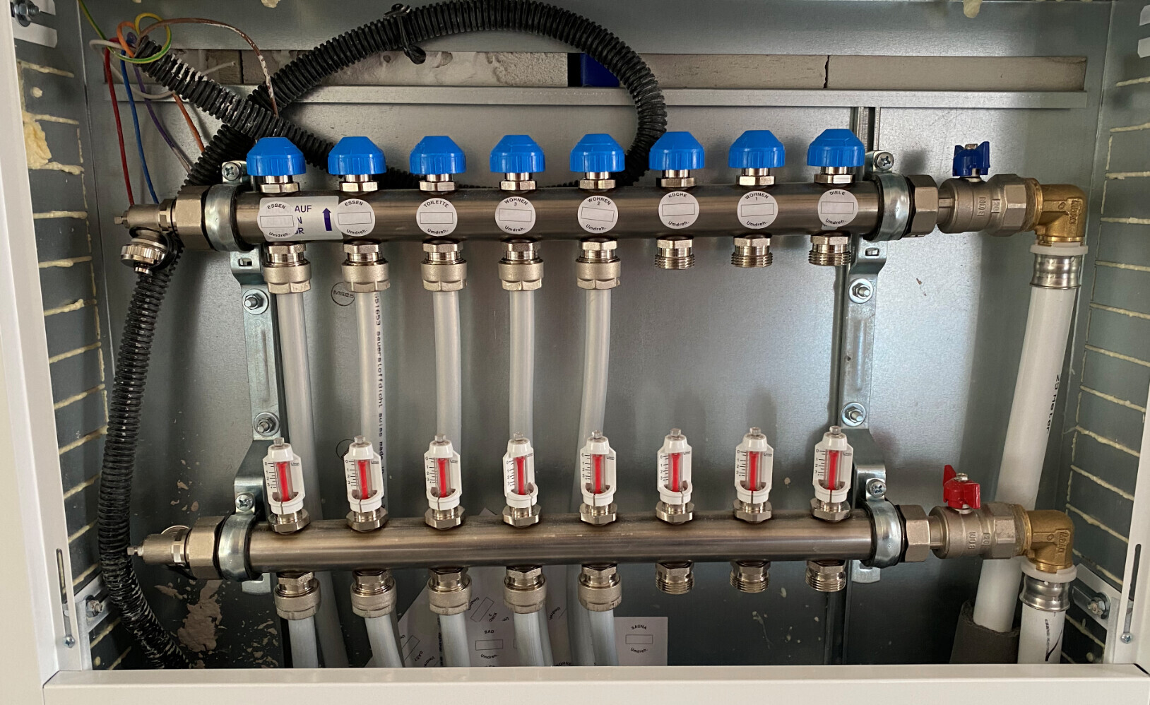

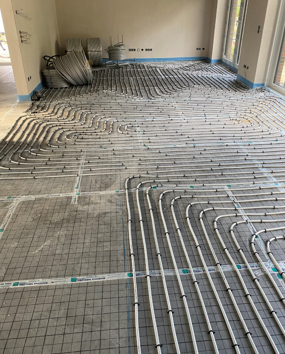

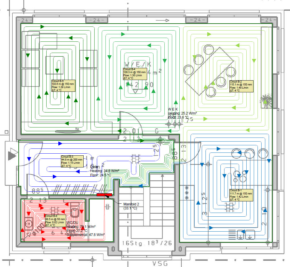

I just don’t understand the difference between theory and practice when it comes to the tradespeople.
Theory: 4 heating circuits with a 15cm (6 inch) pipe spacing:
Practice: 6 heating circuits with a 10cm (4 inch) pipe spacing:
Heating circuit manifold:
Sometimes I wonder if they do this on purpose? We keep discussing how it should be done, and the general contractor complains about warranties, and then everything is done differently? It’s starting to get on my nerves a bit. I’m just wondering if my concerns are justified or if I should just let it go.
The planned flow rate should be 1.45 liters per minute (l/min). Now I guess I need to throttle it down to about 1 l/min?
Deliverer7 Jul 2021 21:1915 cm (6 inches) would have been nonsense anyway. 10 cm (4 inches) is fine.
But why is there an empty area at the bottom left?
Still, there are several reports from people who have had the ERR function deactivated. If that doesn’t work, make sure the actuators are powered off and open. Then you can simply unplug the cables. Of course, it’s a pity to waste money on this...
If there is no chance to convince the heating technician to switch to a buffer-free system, at least have a small buffer tank (50 liters (13 gallons)) installed in series on the return line. Not in parallel as a hydraulic separator. Otherwise, you won't be able to pump properly or heat efficiently without losses.
