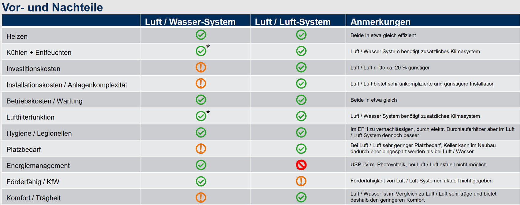

we are currently deciding between several prefab house suppliers, and a major difference is the heating system offered. Some suppliers install an air-to-air heat pump as standard (cooling available at extra cost), while others provide an air-to-water heat pump with underfloor heating and a ventilation system with heat recovery (an air conditioning unit can be added). Geothermal or groundwater as a heat source will likely not be an option for the plot we are currently considering. It will be a KFW 55 house, initially without photovoltaics for cost reasons, but solar panels are planned to be added later.
We have already read quite a bit on the topic, but as laypeople, we find it difficult to make a decision regarding the heating system. It is important to know that we are very sensitive to heat and want to include active cooling right from the start. In the worst case, we would need to heat/cool only individual rooms.
These are the advantages and disadvantages we know so far:
In principle, this results in 3 options that we are currently considering (we were advised against underfloor heating with cooling function for the reasons mentioned):
Which option would you prefer, or do you see another solution? Do you have any ideas which option would be better in terms of running costs? Because we probably have a rather expensive plot and need to watch costs during construction, air-to-air currently sounds like the better solution to us.
We would appreciate your assessments.
| Heat Pump | Advantages | Disadvantages |
| Air-to-Air with Cooling Function |
| Air-to-Water with Underfloor Heating + Air Conditioning |
| Air-to-Water with Underfloor Heating with Cooling Function |
- Install air-to-air heat pump with cooling function
- Install air-to-water with underfloor heating, add air conditioning when photovoltaics are installed, and live with the heat until then
- Install air-to-water with underfloor heating and air conditioning, tolerate high cooling costs until photovoltaics are added
