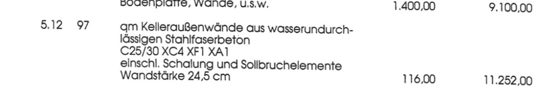

Except for a good basement builder who knows their craft?! Besides using waterproof concrete (WU concrete), we also had metal fibers added to the concrete, which our architect insisted on.In principle, should you just trust the prefabricated house supplier when it comes to basement construction and not outsource it?
But if I know which basement builder my prefabricated house company works with, couldn’t I casually request a quote from one of the largest ready-made basement providers in Germany and have it contracted externally?
That’s what I’m getting at... I think you could save some commissions and extra charges by contacting a basement builder directly.
I think it’s easier to have everything done by the prefabricated house supplier... sure, that’s the simplest way, but probably also the most expensive, right?
Am I going in the wrong direction here, or is something like this feasible?
How did you handle this with your prefabricated house suppliers? Everything completely from one source (basement, garage, landscaping, photovoltaic, etc.) or did you hire specialized external contractors for different parts?
