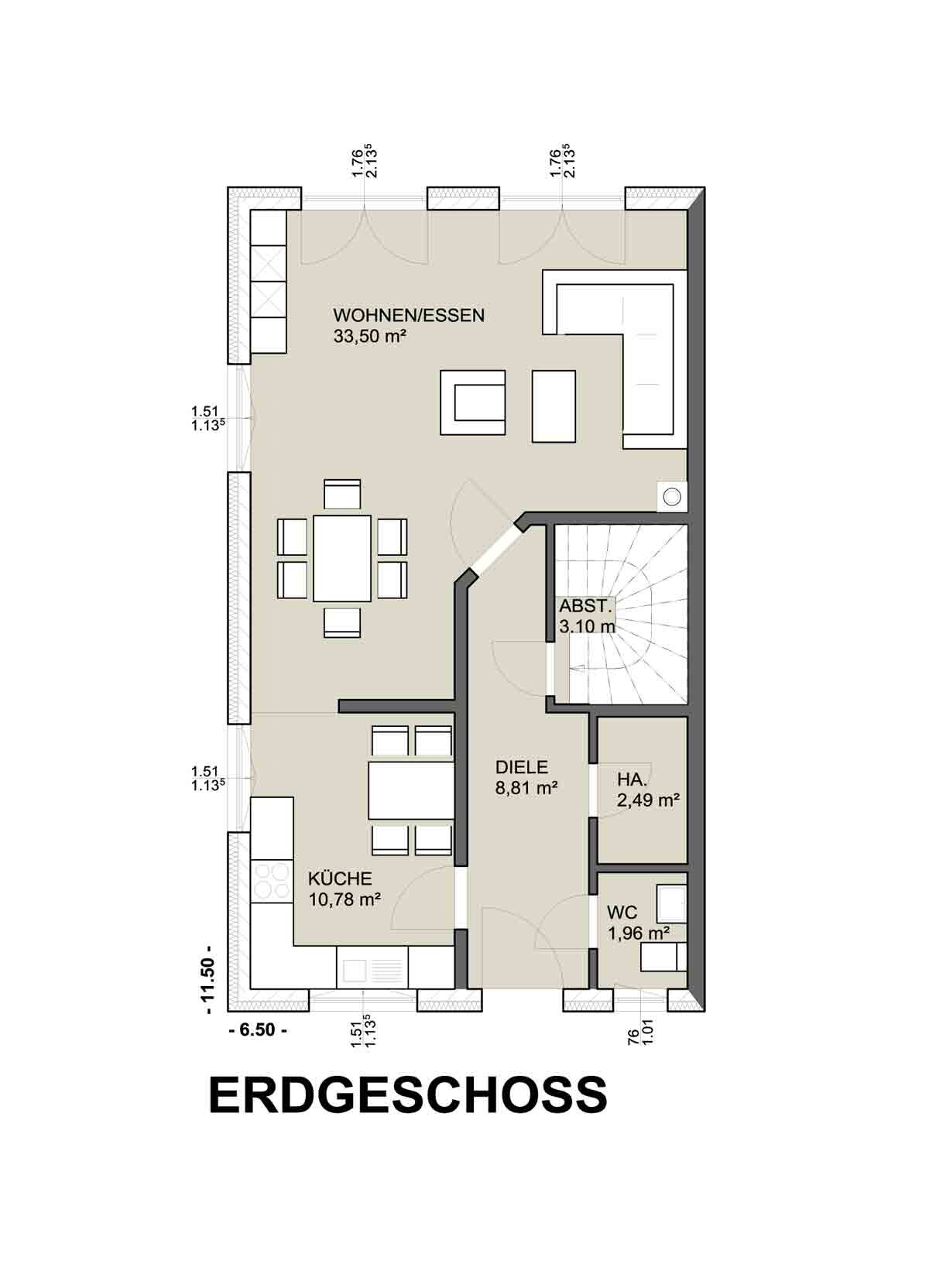

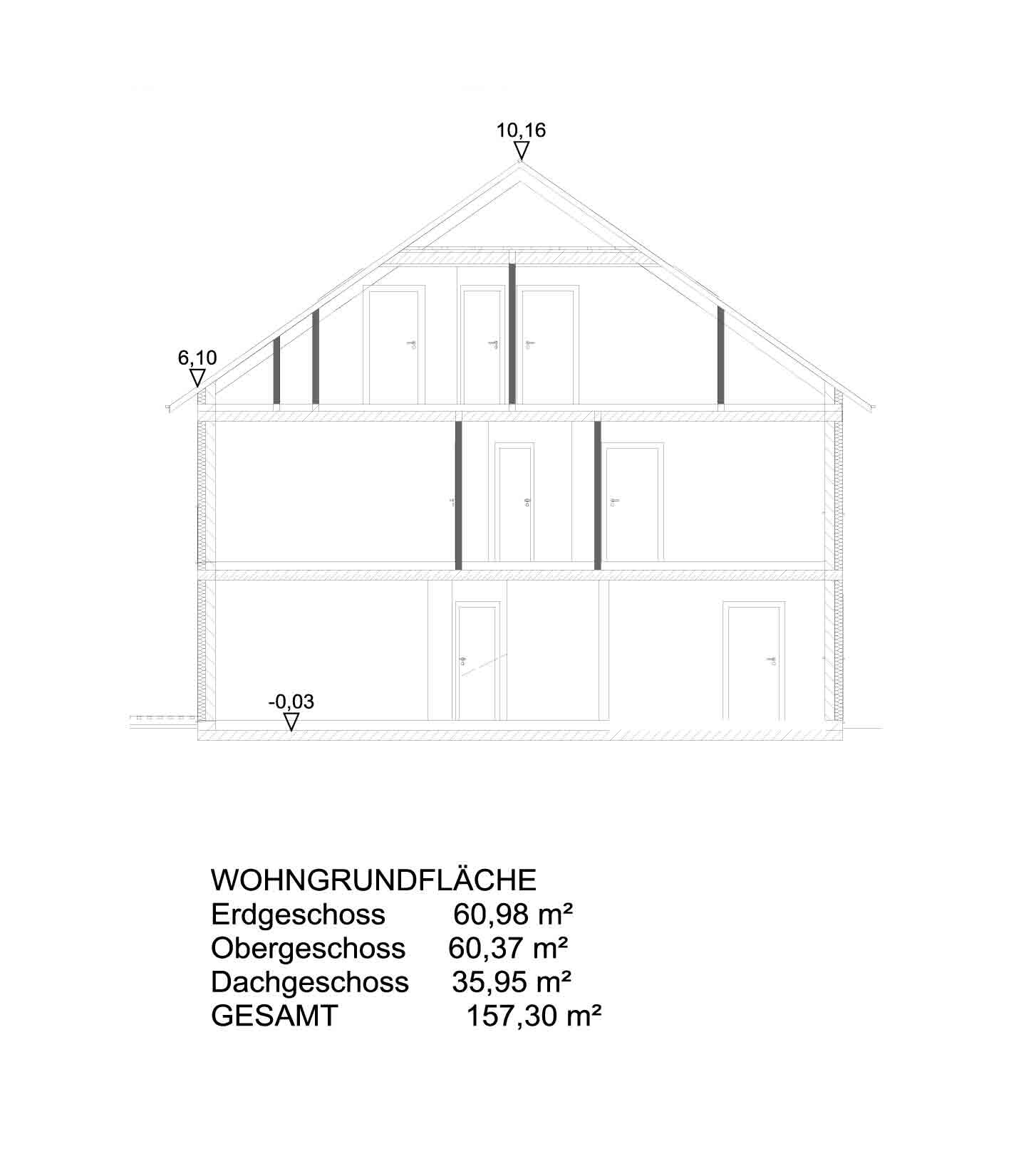

I lied to you in my first post—sorry, that was unintentional—I simply remembered incorrectly. The floor plan for our clients that I mentioned measures 6.50 m x 11.50 m (21 ft 4 in x 37 ft 8 in) exterior dimensions. I’ve attached the ground floor plan, a section drawing, and two photos from just before completion. Overall, the net building footprint is 208.50 square meters (2245 square feet); of course, the actual living area is less.

For comparison: the attached floor plan required an investment of approximately EUR 240,000 (around USD 260,000) as a KfW 70 efficiency house with an air-to-water heat pump, decentralized ventilation, electric shutters on the ground floor, partly colored facade, and colored window frames.

Bauexperte
