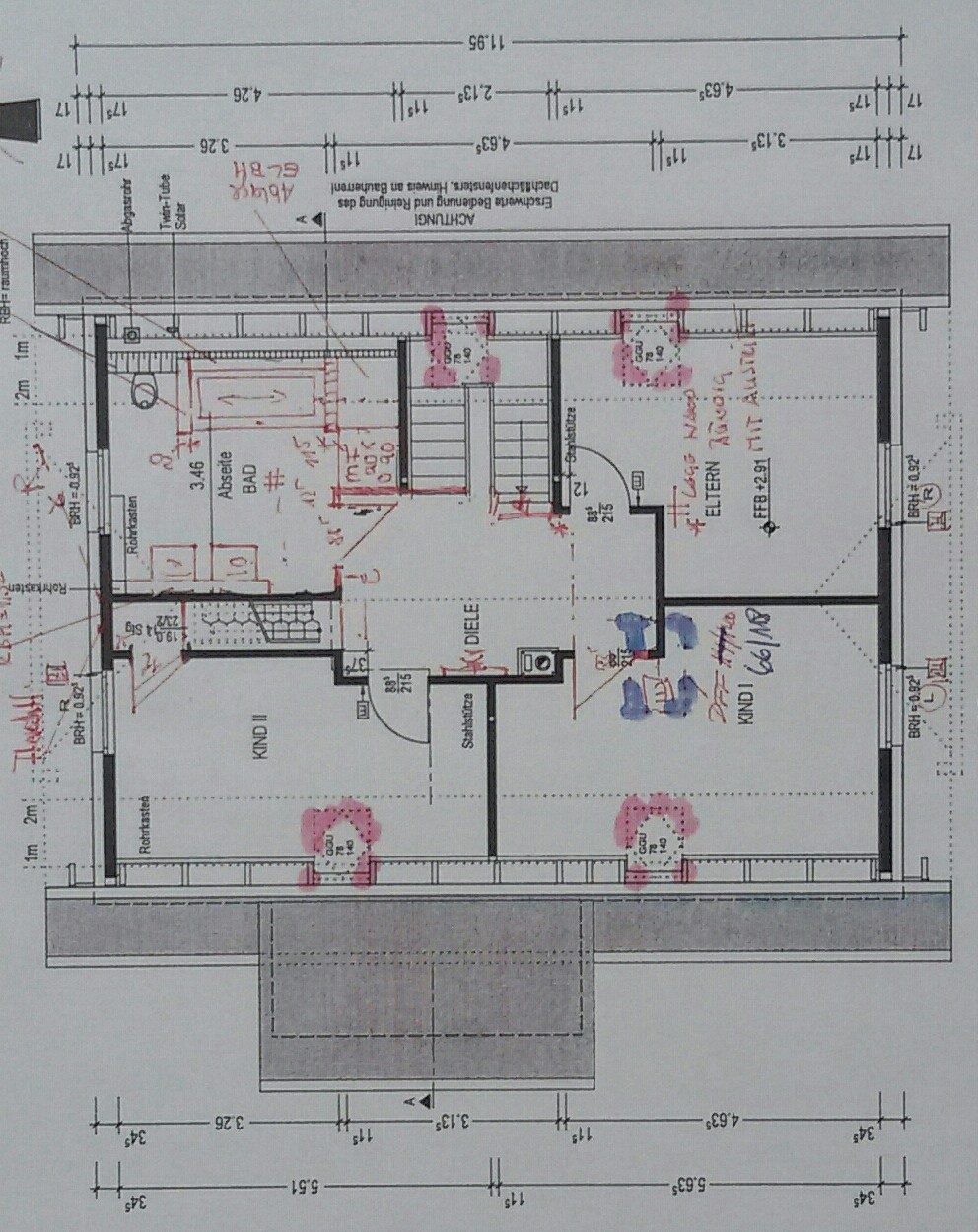

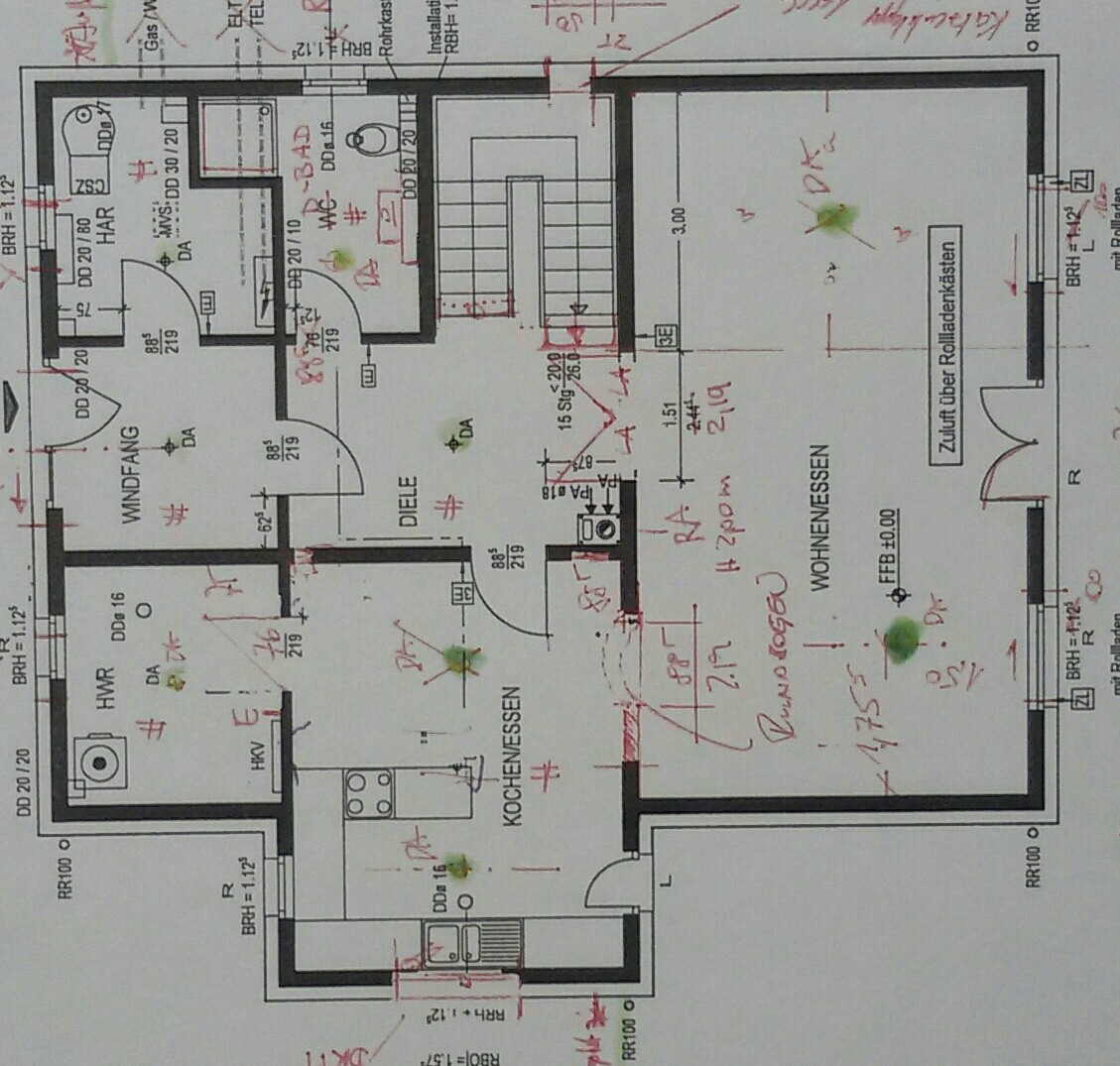

Hello @all,
In the meantime, we have just completed our second-to-last extensive house planning meeting and are now close to finalizing the plans. I would really appreciate it if you could take another look at the floor plan and give us feedback on whether and what changes might still make sense. Or if you have any ideas for the bathroom layout on the upper floor, please feel free to share.
Regarding our recent changes:
Ground floor
- Door to technical/storage room (HAR) now 88.5cm (35 inches) wide
- Stair landing with a 25cm (10 inches) stair tread width, which made the guest toilet narrower
- Window in living/dining area with a lower and higher sill height, now 145cm (57 inches)
- Terrace door now wider at 176cm (69 inches)
- Kitchen window in the bay now wider and double-leaf, 151cm (59 inches) wide
Upper floor
- Every room except the bathroom now has a roof window
- Staircase to the attic without a door; the room behind it will be added to the bathroom (it’s still marked as Child 2’s room on the floor plan, but we urgently need storage space for towels etc. in the bathroom)
The strip window above the stair landing did not make sense because it would be directly under the roof overhang and no sunlight would come in. However, we have a roof window above it.
We are still debating the muntin bar distribution in the windows and terrace doors. Should they all be as uniform as possible, or would it be simpler to differentiate the terrace doors from the start?
Where to best place the unfortunately necessary and decorative heated towel rail in the bathroom is also still a topic. Likewise, increasing the knee wall height to 110cm (43 inches) to gain more headroom in the attic is under consideration. Unfortunately, this would exceed the permitted ridge height, and we would have to apply for a special exemption.
So, for now, here are the pictures.

Hello
A significant improvement compared to the original version.
However, a few points I noticed:
What is the large area in the kitchen for?

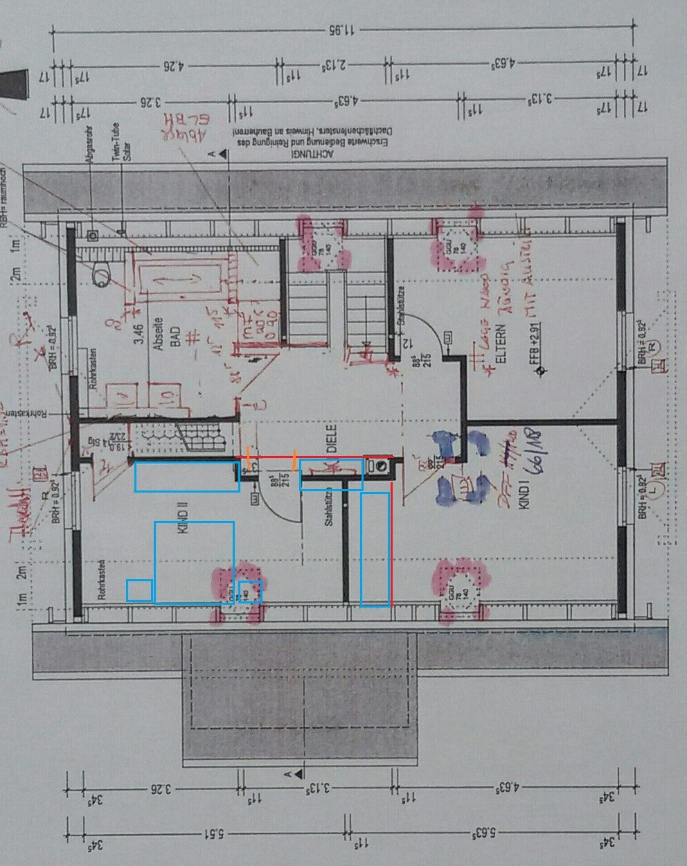

With the half-hipped roof, access via the attic stairs becomes critical.
If the washing machine is moved in the bathroom to provide access under the stairs,
a cupboard would fit just as well there, and the storage room could remain in the children's room.

In my opinion, roof windows in bedrooms are not a good idea at all. They are very noisy... Have you ever slept in a room with a roof window when it’s raining? I would definitely leave them out and instead make the regular windows larger.
I would swap Child II and the parents’ rooms, making both children’s rooms about the same size, and then make the parents’ bedroom a bit larger to allow more space for wardrobes. With this swap, at least the children’s room windows should be made significantly larger. Ideally, I would mirror the entire upper floor both vertically and horizontally... Then both children’s rooms would face west, the bedroom would be in the northeast, and the bathroom in the southeast. I’m just not sure how the bathroom drainage would work then, but maybe it could run down between the living room and kitchen and be connected to the kitchen drain. I do think the bathroom layout itself is very well done. Or what don’t you like about it?
On the ground floor, I still feel there should be a window in the dining area on the south side. And the kitchen is really poorly planned. I would redesign it more like in my picture, with the tall cabinets on the top side of the plan and the U-shaped kitchen rotated.
I hope I was able to help.

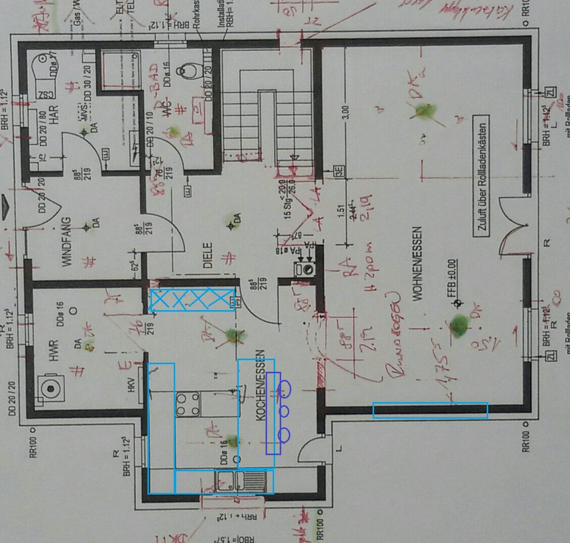

Thank you @wrobel and @Kisska86 for your feedback.
Regarding the kitchen: what is drawn in is just a placeholder. The actual kitchen layout will look different. Kerstin’s plan is quite similar to yours, Kisska, but instead of a U-shape, it’s a simple two-row layout. This design is really optimal, but my husband doesn’t like it. As a compromise, I’ve now proposed an L-shape with an island, which he can accept.
Access to the attic and the half-hipped roof is really tight. Due to the steeper roof pitch and a custom staircase with the last upper step designed as a small landing, we hope to make it work. The architect and staircase builder are still working on the plans.
I don’t understand the mirrored layout of the upper floor — in our plan, the bedroom is already in the northeast. Bottom left is southwest, top left northwest. That’s why we thought it made sense to give the kids’ rooms the sunny sides with plenty of light. Placing the bathroom at the bottom right would also be difficult because of the drainage.
The skylights are the only way to meet the applicable 1/8 daylighting rule in our area. Otherwise, the gable windows would have to extend across the entire width and be even taller. For now, we’re already living under the roof with skylights in the bedroom and have gotten used to it.
I advocated for a window on the south side in the dining area, but we are now foregoing it in favor of more usable wall space.
What bothers me about the bathroom is that we have relatively little storage, even though it is quite large. And wrobel is right about using a proper cabinet instead of a built-in unit under the stairs.
