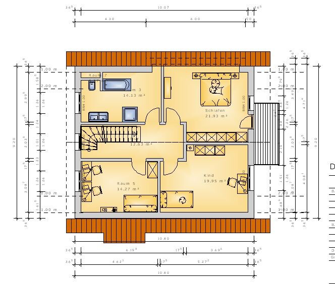

The bathroom on the upper floor is just an idea. As mentioned before, we are open to suggestions for improvement. Or do the experts here think it’s not possible to arrange it at all? If so, then as laypeople, there’s no point in trying further.
The staircase makes or breaks the floor plan. Again, I ask the experts for advice: Setting aside that the room layout would be completely different, if we rotate the staircase and want a comfortable quarter-turn staircase instead of a half-turn staircase, can that even work in a house of this size, 9.20 m x 10.80 m (30 ft 2 in x 35 ft 5 in)?
I have revised the floor plan again, straightened the walls, and redesigned the kitchen. The most challenging part is the bathroom on the upper floor because the door cannot be moved due to the staircase, and we are unsure where the best place for the shower would be. We’re probably a bit too close to the project to see it clearly, but I don’t want to give up quickly and start all over again. We have already invested so much time. What do you think?

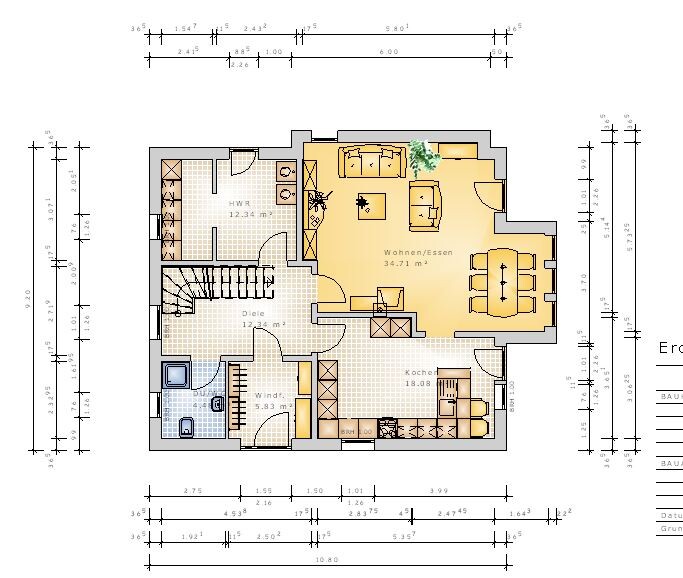

Ground floor and upper floor variant 2:
There is a huge opening in the kitchen, and the seating is squeezed into the corner.
The table placed across... that surprises me, because a table about 180cm (71 inches) long would only allow 60cm (24 inches) clearance at the top and bottom... hmm.
I still don’t understand the bay window at the top of the plan.
Could you achieve the single-story design with a ridge height of 9m (30 feet) by only using part of the attic space, but with standard ceiling height and a roof with a shallow pitch?
@kbt09: Yes, I also noticed the gap in the kitchen. So it’s definitely not narrow. I’m just missing that brilliant idea to make good use of all the space. The peninsula could still be moved a bit to the left.
I want to have plenty of storage because that’s what I lack in my current kitchen.
I’m not sure if reducing the size of the upper floor and having a flat roof would still keep it single-story. But it would definitely cost us important storage space in the attic.
If we extend the wall between the kitchen and living room straight into the bay window, we lose the space for the dining table. And the kitchen becomes even bigger.
Oh, and of course, we can rotate the dining table. There’s still enough room to walk past then.
