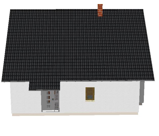

Cinderella77Hello fellow homeowners and experts,
After some time of quietly reading and learning, I have now registered and would like to discuss our floor plan design for our dream house.
It has been about six months since we bought our plot, and we have looked at what feels like thousands of floor plans and discarded them, ultimately designing one ourselves because none of the standard plans from homebuilders fit our needs. We have already sent the floor plan to various homebuilders to check and price it. The offers surprisingly didn’t differ much in price, but none gave constructive feedback on whether everything is feasible or practical in the end. As I have read before, every company praised the plan without any criticism, saying what a nice floor plan it is.
Before we sign a homebuilding contract, we would like to hear honest criticism and would be very grateful for advice, tips, ideas, and suggestions for improvement.
About the location of the plot: It is parcel 9 in a small new residential development with 11 plots, at the end of a private dead-end street (which still has to be built).
Unfortunately, the north arrow got lost on the attached graphics; north is at the top, east on the right, south at the bottom, and west on the left. Due to the drinking water protection zone, no further development is allowed to the east. Behind our garden is a northern neighbor’s garden, a stream, and then an open green area with a small path where dogs are walked.
The house elevations still need to be revised carefully in terms of window symmetry.

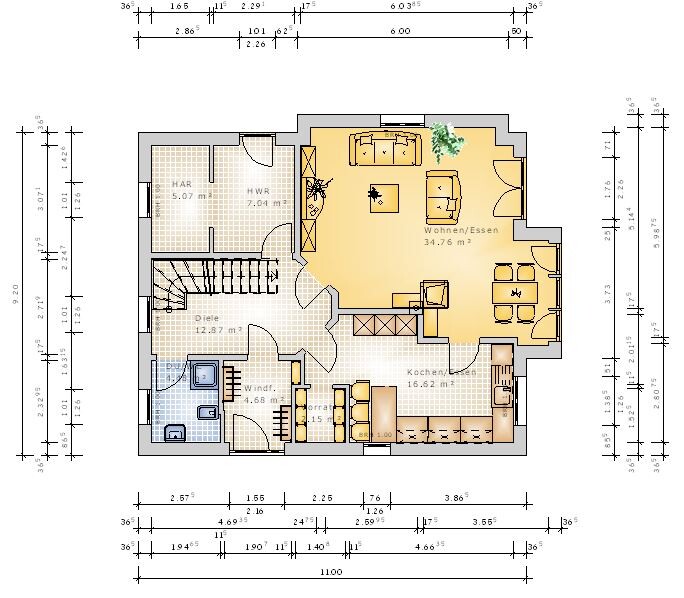

I think the floor plan is quite good overall. However, I have a few comments.
Ground Floor:

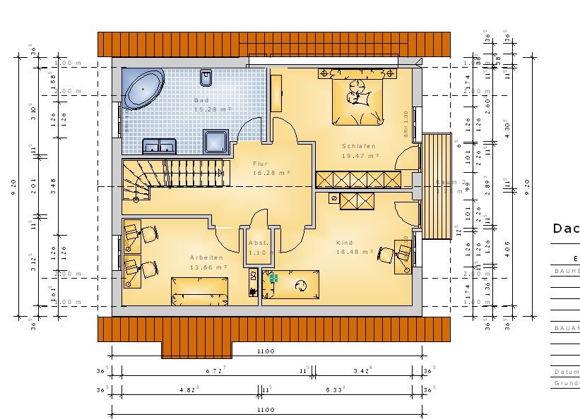

Upper Floor:
Ground Floor:
- I find the entrance area too narrow for the coat storage.
- I don’t like the corners (recesses) in the living room (south side in the bay window, northeast corner, northwest corner of the living room). I would straighten these out, as it will make furnishing easier later on.
- The tall cabinets in the kitchen are quite far from the countertop workspace.
- The slanted walls in the hallway are not to my taste.
Upper Floor:
- I don’t find the storage room practical at this size. I would suggest making the walls straight and creating a storage closet in the office, or enlarging the storage room.
- The bathroom layout could still be significantly improved.
Thanks Jochen, I didn’t expect a reply this quickly.
Yes, the entrance area has become quite narrow because of the pantry and the shower in the guest bathroom. We still need to think about whether to remove the shower and move the pantry further to the right into the kitchen. I’d rather not make the pantry smaller, as it would then no longer be practical to use.
You’re right about the corners; we will optimize those. On the north side of the living room, we would also prefer the wall to be smooth and continuous without the corner on the right, but our design software won’t allow this, and we’re not sure if it’s structurally feasible. The bay window in the current plan has an internal width of 3 m (10 feet) and is centered, which is why there’s the extra corner. Someone advised us that a decent bay window with a table inside should be 3 meters (10 feet) wide. On closer inspection, though, 2.5 m (8 feet) might be sufficient. That would remove the extra corner while keeping the bay window centered. What do you think?
Which distance would work better for the tall cabinets? We thought that otherwise the passageway might be too narrow.
We designed the angled walls to make the hallway feel more spacious and airy, and to improve the entrance into the kitchen. Of course, that’s a matter of personal taste.
The storage room on the upper floor is indeed tiny, and the storage cabinet in the office is a great idea. We just wanted a small place to store the vacuum cleaner and similar items, so we don’t have to carry them up and down the stairs all the time.
We would really appreciate suggestions for the bathroom.
You should be aware that your wardrobe will end up under the staircase. Is that what you want? These placeholders in the entrance area are a joke anyway: one on the left and one on the right.
Regarding the placeholders: try drawing in a proper dining table measuring 1 x 2 meters (3.3 x 6.6 feet). Then you'll see that a square-shaped room for dining and living can be very small.
Having a balcony that connects child and parents is also not ideal if the child is a teenager who still has friends over in the evening.
I also find the floor plan quite decent. However, a few things caught my attention.
The dining bay window feels too narrow. When the table is extended, you can no longer access the kitchen.
The storage room on the upper floor creates an awkward niche in the children’s room. I would extend it fully and possibly enlarge it by a few centimeters toward the study.
Also, I would add a window in the hallway on the upper floor to allow for natural daylight.
Am I the only one who doesn’t like the layout with the northeast-facing living room? No sunlight comes into the living areas from the south or west. The small kitchen window is hardly worth mentioning, and the kitchen would be too separated anyway to let sunlight reach the living space.
