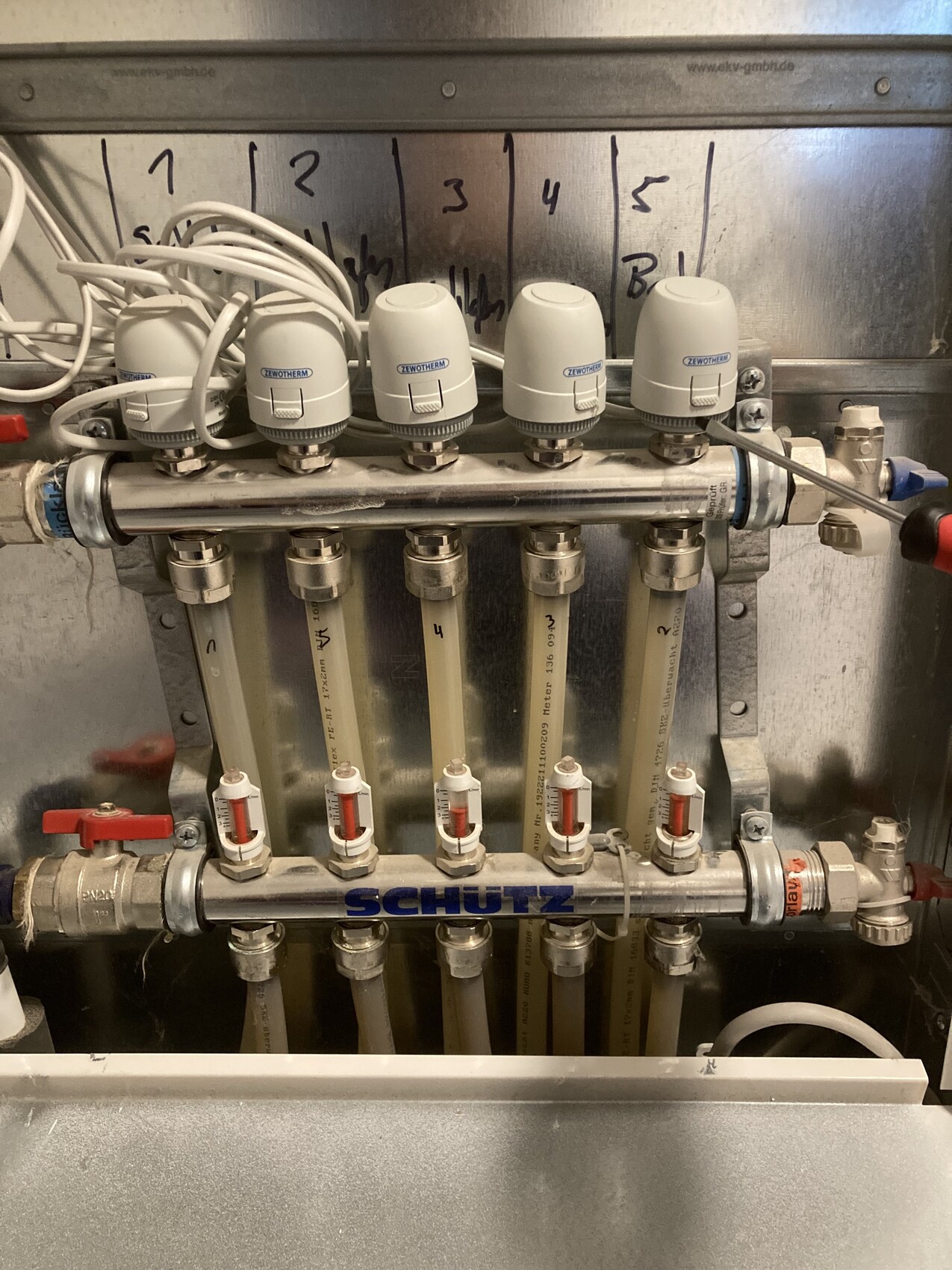

We recently renovated the bathroom on our upper floor. The underfloor heating was working when we finished.
However, it now seems to have stopped working.
Unfortunately, I have no idea what settings I should adjust.
Does anyone have an idea if everything is properly regulated here?
Apparently, the right connection is not functioning.

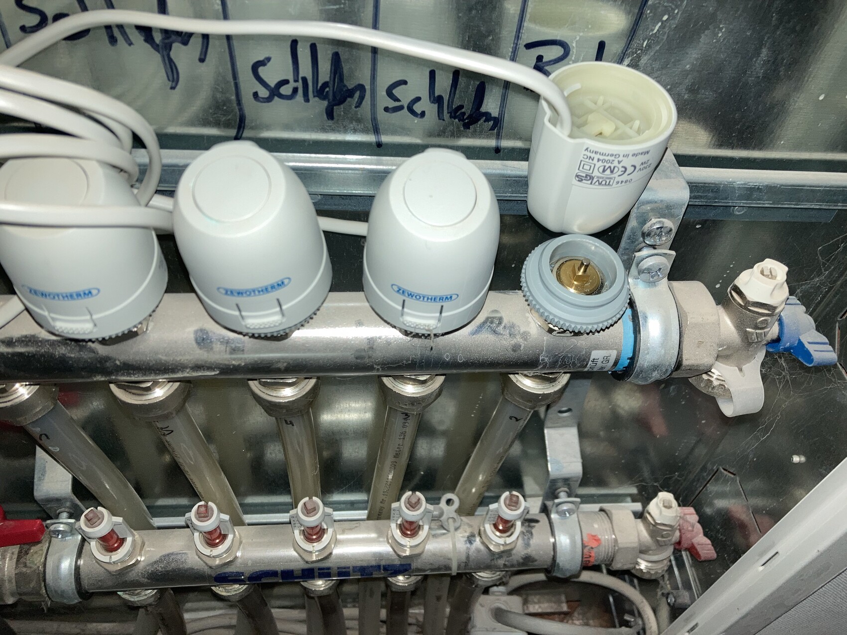

jens.knoedel13 Jan 2024 13:32ArniBanarni schrieb:
I slightly turned up the knob underneath.It works like a thermostat for a radiator. You have the pin in the center. It is pushed in by the motor or can extend outward. This controls the flow rate. You can adjust it to fine-tune.A
ArniBanarni13 Jan 2024 13:58Ah, great, I got it. I have the feeling that the bathroom floor is just cold now, not ice cold anymore. Let’s wait until this evening or tomorrow to see if anything changes.

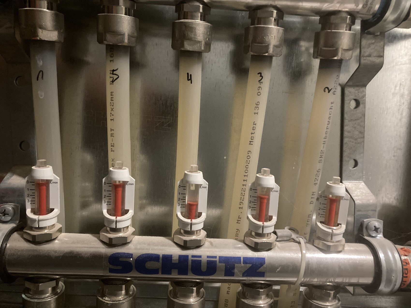

RotorMotor13 Jan 2024 14:42Does the sight glass now show flow? Otherwise, turn it fully counterclockwise.
ArniBanarni13 Jan 2024 15:15Only the middle sight glass shows flow. However, flow was present in all other rooms except the bathroom.
At the location indicated, I turned counterclockwise, opposite the screwdriver's direction. The red parts at the bottom cannot be turned; only the white plastic around them can be rotated.
I am also wondering: is the bathroom connected to the hose on the right or the second from the left, since the hose is labeled with a "5"?
ArniBanarni13 Jan 2024 15:24Ah, I have now found the key for the red ones.
All of them are fully turned "on" counterclockwise?
I adjusted them a bit clockwise.
