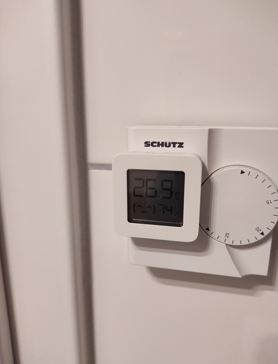

Now that we have a child, we need to increase the temperature in the bathroom (we previously kept it around 22°C (72°F), which was easily achievable with the heat pump). One option would be to raise the heating curve for the entire system, of course—but that doesn’t seem practical for just one room. The higher temperature is only needed occasionally (when our little one is taking a bath, etc.).
The bathroom is about 20 m² (215 sq ft).
Even when the thermostat is set to 25°C (77°F), the temperature only reaches around 22°C (72°F).
