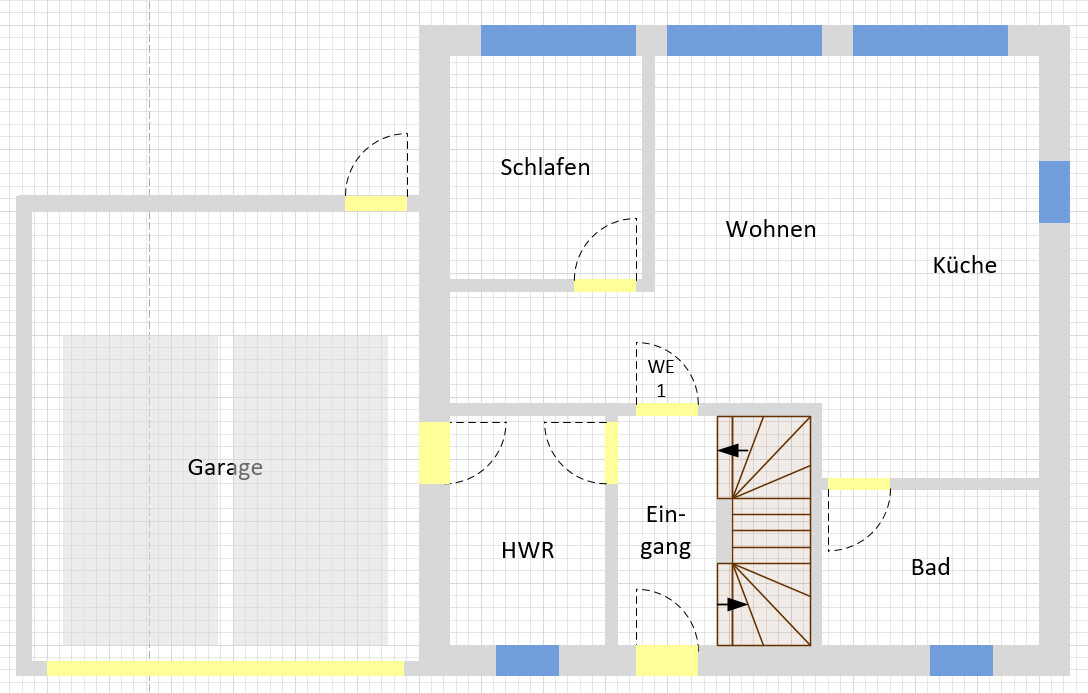

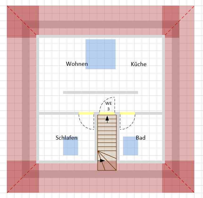

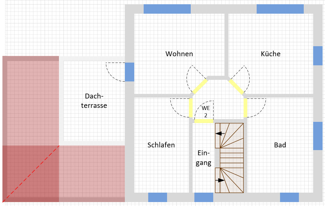

Attached is a version of the floor plan. I hope this one doesn’t have the issues from yesterday. I discovered a measurement error back then, which meant I had to revise all three floors again 🙄 Anyway, these are just initial drafts for getting a rough idea.
Here, I’m showing 3 residential units. It’s quite possible that in the end there will only be 2 units, meaning the attic floor wouldn’t be separated (this would require significant replanning, especially for the escape route). In that case, I would move the door to residential unit 2 towards the staircase leading to the first floor, so that the first floor and the attic would form one unit that can be locked separately.
Doors/gates are marked in yellow, windows in blue, and I tried to illustrate canopies in red. One square on the ground floor and first floor corresponds to about 20cm (8 inches), and one square on the attic floor is about 50cm (20 inches). I haven’t added dimensions yet. These can be retrieved from the planning software; the visualizations are still missing.
Edit: This version assumes the attic will be finished immediately (or at least part of it), so that the child has their own space there. Or maybe it will be us, we’ll see 😉 If the attic is not finished straight away, the floor plan on the first floor would be trickier (because then a transitional children’s room would need to be included).
Ground floor:
First floor:
Attic floor:
Ground floor:
First floor:
Attic floor:
