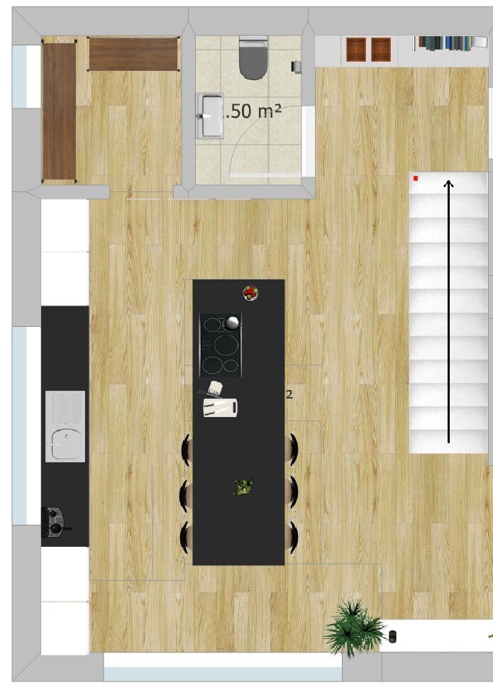

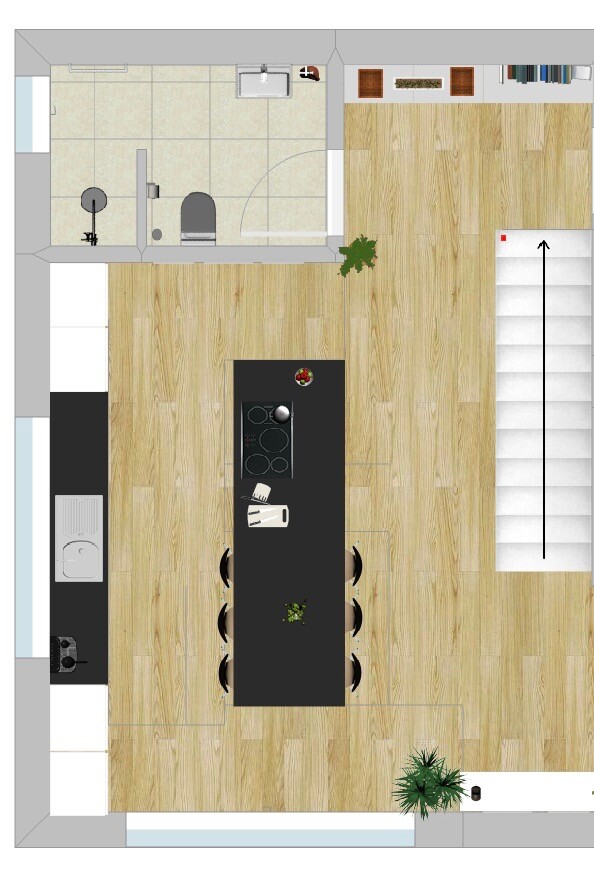

We are currently in the final stages of our detailed planning. We wanted to convert a bathroom with a shower into a pantry and a guest WC. This would involve moving a wall on the ground floor by 45cm (18 inches) and adding an additional wall on the ground floor to divide the former shower bathroom. So far, we have not signed off on the detailed planning, but now we are being asked to pay €1500 net for a new structural calculation. Is this common practice?
I had assumed that the structural engineering would only be calculated after completing the detailed planning.
What do you think? Do I really have to cover the cost of a new calculation?

Feel free to also generally use the planning thread with plans, floor plans, and so on.This is a solid construction house, planned freely by us and the general contractor. This was now the third appointment for discussion after repeated errors in the plans, not caused by us. According to the general contractor, the structural calculation is done before the detailed design phase, which, in my opinion, does not make sense. At least, there was never any indication of this.
I understand the general contractor’s position, as they had the structure calculated and would now have to bear the costs twice. On the other hand, the detailed design phase is meant to allow changes to be made and finally approved with a signature. After that, it is clear that no further changes are expected.
Attached are two small pictures illustrating the scope (just as examples).
