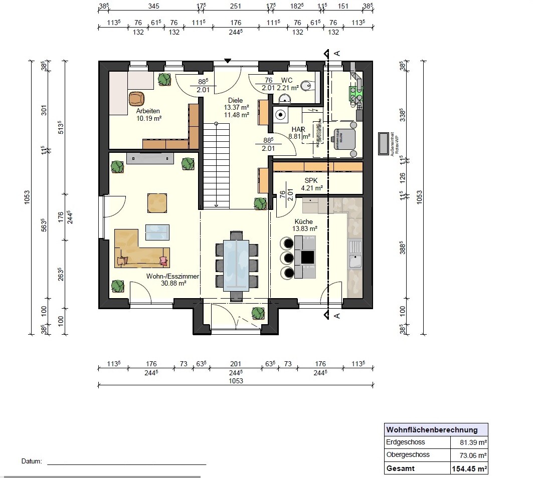

Hi, we have our final planning meeting on December 13th, after which everything will be sent to the building authority (building permit / planning permission).
From the beginning, I told my salesperson that the outdoor unit of the Rotex ventilation system was incorrectly positioned in the first offer. The layout shown is not possible because the garage is supposed to be there.
I was told, "No problem. This can be changed in the planning phase and moved up."
Now I wrote to the CEO to have this corrected.
The reply was only:
On your floor plan, you moved the outdoor unit of the heat pump to a different location. This is not possible with the contractual Rotex heat pump. A Novelan LAD heat pump is required, and the outdoor unit must be moved further to the right, against the outer wall of the study room.
Here are the costs: Change to Novelan LAD + 2,138.00 €
Extension of the outdoor unit + 1,509.00 €
The reason is that the outdoor and indoor units have to be aligned at the same height/line.
Of course, I disagree with this.
Do you have any suggestions on how to solve this without extra costs or significant loss of space?
The pantry shown in the picture will be removed, and the utility room (HAR) will be made larger instead.
The reply was only:

305er schrieb:
And what about the 180L (48 gallons) hot water storage? Isn’t that too little?Not necessarily. The storage temperature is higher than the desired temperature at the outlet. That means the water is mixed down. It certainly depends on the number of people, their shower/bath habits, and how long the heating system takes to reheat. With gas, I wouldn’t worry about it at all, and a heat pump can activate an electric heating element if needed—basically working like a tankless water heater—so hot water is guaranteed, but with lower efficiency and higher operating costs.
We currently have about 170L (45 gallons) in our gas boiler and have never had issues with cold water, even when we have guests, despite using a rain shower.
