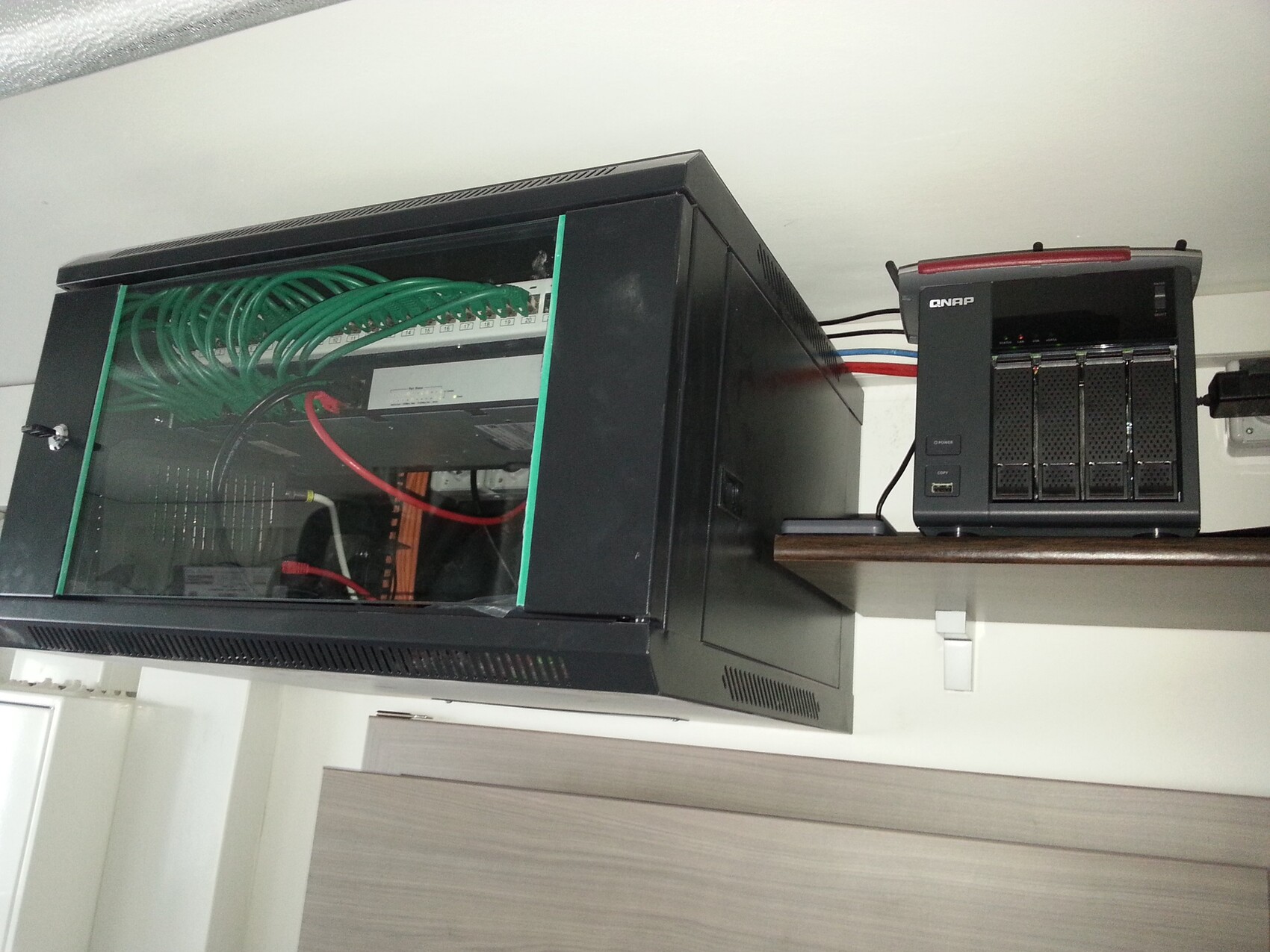

Does anyone have experience with a 19-inch network cabinet (9U) including mounting and grounding kit, fixing set, power strip, and patch panel? My electrician quoted €528 net. Additionally, €180 for installing, labeling, and connecting the data cables and €170 for testing the balanced copper cabling according to CAT6.

Does anyone have experience with a 19-inch network cabinet (9U) including mounting and grounding kit, mounting brackets, power strip, and patch panel? My electrician quoted 528 euros (net) for this...... Additionally, there are 180 euros for installing, labeling, and connecting data cables, and 170 euros for testing the balanced copper cabling according to CAT6 standards....
Are you referring to something like this? However, these are only 6U and, in my opinion, more than sufficient for a single-family home, plus it still fits above a door. Achieving that with 9U and a ceiling height of 2.50 m (8 ft 2 in) is no longer possible.
