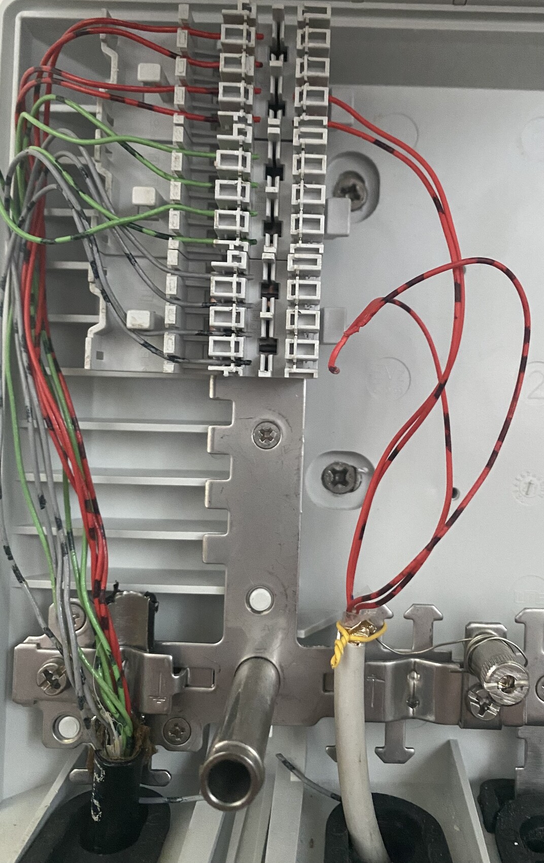

Attached is a photo of the final telecom cable (Brandenburg, no fiber optic). It is as thick as 5x2.5mm² (about 1cm (0.4 inches) in diameter).
