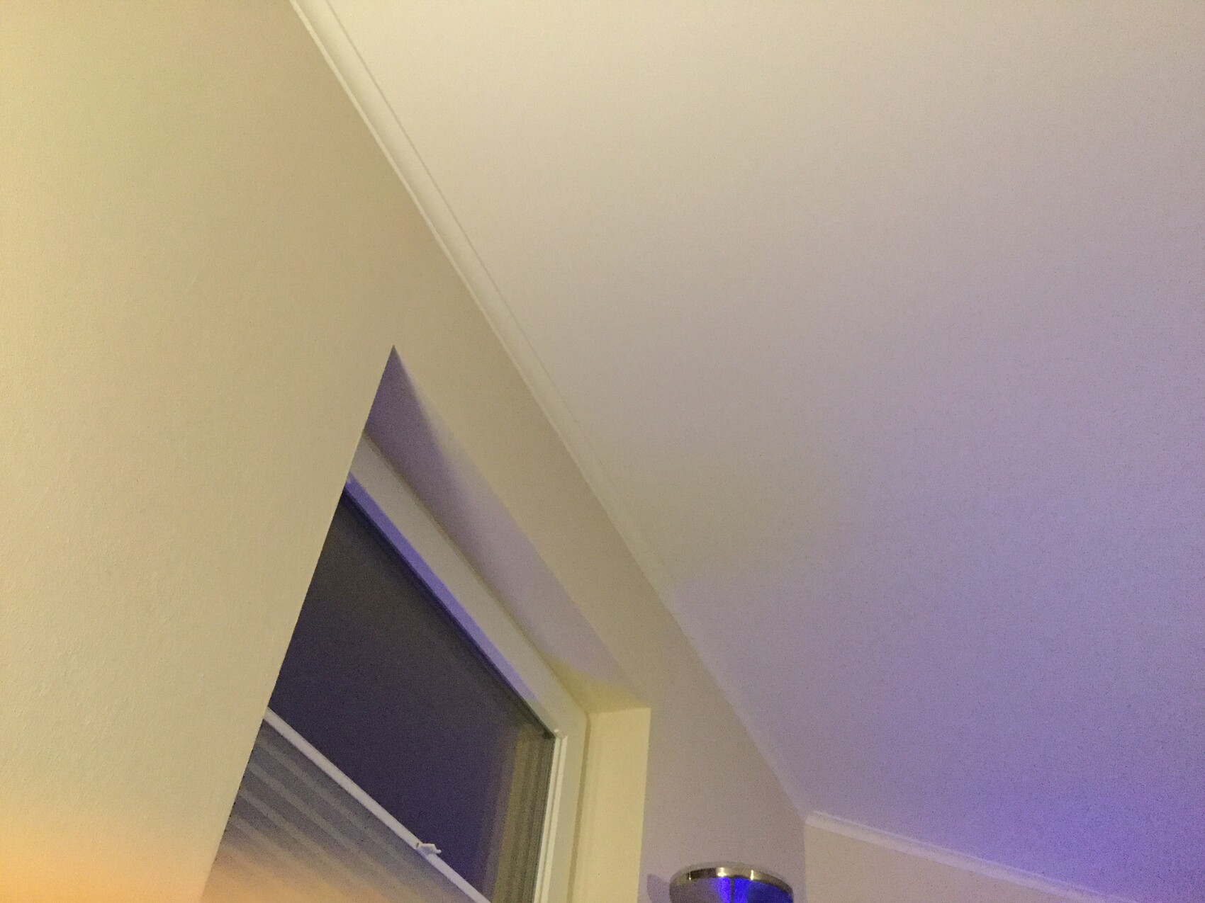

Stick on a decorative molding strip
Interior corner with window and blue-purple lighting on ceiling and wall
