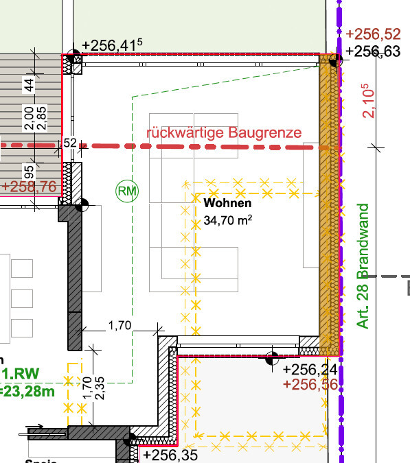

Does anyone have more expertise on this and can tell me to what extent this can reduce reverberation in a room (in my case, a living room with hard walls and very large windows)?
