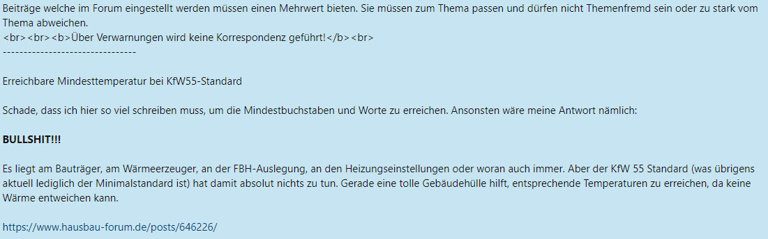

KarstenausNRW17 Nov 2023 12:26Sorry, my first post was removed because I used a bad word and received a warning. This bad word (besides the paragraph with the specific information related to the question) caused the forum software to mark my post as “no added value.”
So, again:
No, the statement from the developer is complete nonsense. Modern houses (by the way, KfW 55 is the current minimum standard that a new build must meet) are so well insulated that heat can no longer escape. Or rather, cold does not penetrate, making it quite easy to heat to comfortable temperatures.
If 20 degrees Celsius (68°F) is not exceeded, it could be due to:
- incorrect heat generator (heating system)
- incorrect design of the underfloor heating
- incorrect heating load calculation
- incorrect settings on the heat generator
- incorrect settings on the underfloor heating
and so on.
ALL of this is within the builder’s responsibility. Please report the defect and have it corrected. Since you haven’t yet responded to my question above and you are the owner, please ask to be provided with the documents you are entitled to. Then you will know more. Nowadays, it is really difficult not to reach 20 degrees Celsius (68°F) in a new build, unless the heating is simply turned off.
