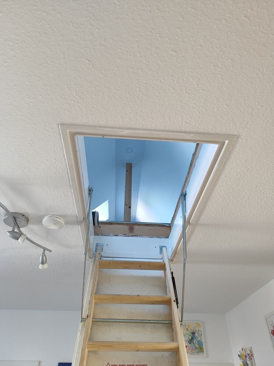

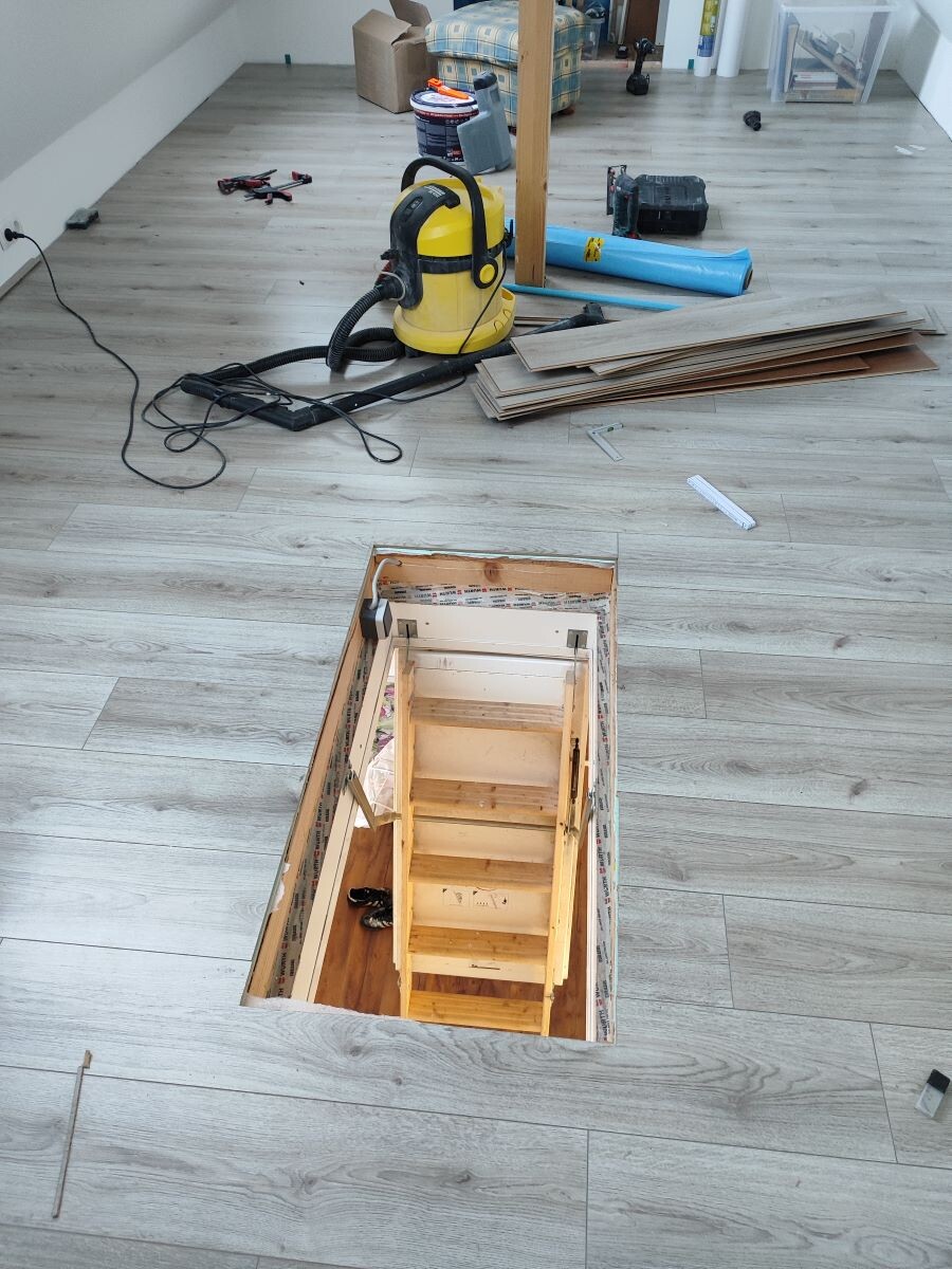

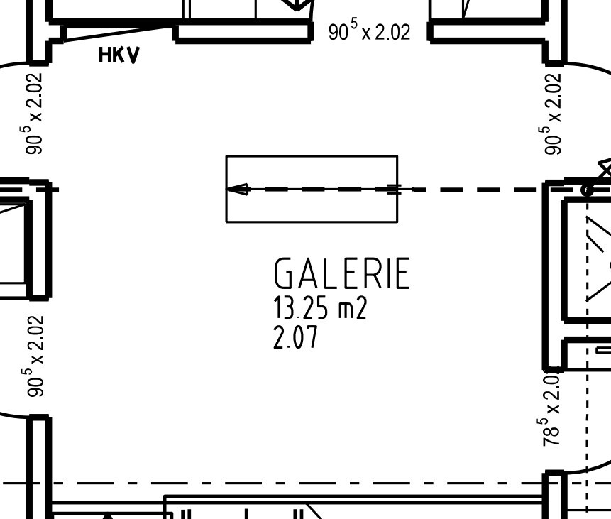

I have finished some renovations in the attic for the children and now face the challenge of providing a safe way for them to go up and down without crowding the entire hallway. I hope some of you might have experience on the best way to achieve this.
The attic is converted to a height of 2m (6 ft 7 in), but this height is only available in a width of 45cm (18 inches). After that, the roof slopes symmetrically at a 45° angle. The access to the attic is located in the center and is currently reached by a folding ladder. The ladder measures 60 x 114cm (24 x 45 inches), and I assume the opening is the same size. Ideally, I would prefer not to change the size of the opening since there is already rather limited space inside the attic to pass by the hatch.
One option would be to install a space-saving staircase or possibly a spiral staircase. For the space-saving staircase, the steps would be taken lengthwise, while for the spiral staircase they would be oriented toward the roof slope. I am unsure if this is really feasible due to the ceiling height.
I have attached two photos and a drawing so you can better understand the situation on site.
In general, the solution should be relatively cost-effective and involve as little effort as possible. Thank you for your ideas.

ElBoCaDiLlO5 Nov 2024 09:54Arauki11 schrieb:
Why do you want to change anything about it at all? The staircase meets standard safety requirements, and for children it’s quite easy to climb up.
We had the same setup, and the kids were often up there because of the toy highway they built; sometimes we even closed the hatch when they wanted some quiet time.
Unless it’s a room that will be used more or less continuously or is meant to be part of the living area, I’d leave it as it is for occasional play afternoons, especially since most of the time the staircase would be right in the middle of the hallway below, and the kids might soon stop playing up there anyway. Thank you for your feedback. The issue is that the children can’t open the staircase by themselves. The lock is rather hard to reach and then the length isn’t enough to fully unfold the stairs. I also checked out scissor staircases with a motor drive just for fun, but those are really expensive... But I do agree with you that no matter which staircase you choose, if it’s fixed in place, it will be right in the middle of the hallway. The hatch was originally planned in a different location, but the problem was that it would open directly in front of a beam, so it had to be repositioned...

ElBoCaDiLlO5 Nov 2024 10:23I also had someone here who would have extended the stairwell and built a staircase along the right wall. The opening would then be at least 2.3 meters (7.5 feet) long and 1.4 meters (4.5 feet) wide. But with only 1.4 meters (4.5 feet) in width, there would still be just 1.5 meters (5 feet) of remaining headroom next to the passage in the attic. Who is supposed to use that, please? And for a price of around 10,000 euros, at least it would have been adjusted to the existing staircase. Well, that’s simply too much for me and unfortunately not practical if I can no longer walk properly up there.
Basically, all the children can safely go up and down at the moment. Practice makes perfect. Still, it’s not something you want to look at.
