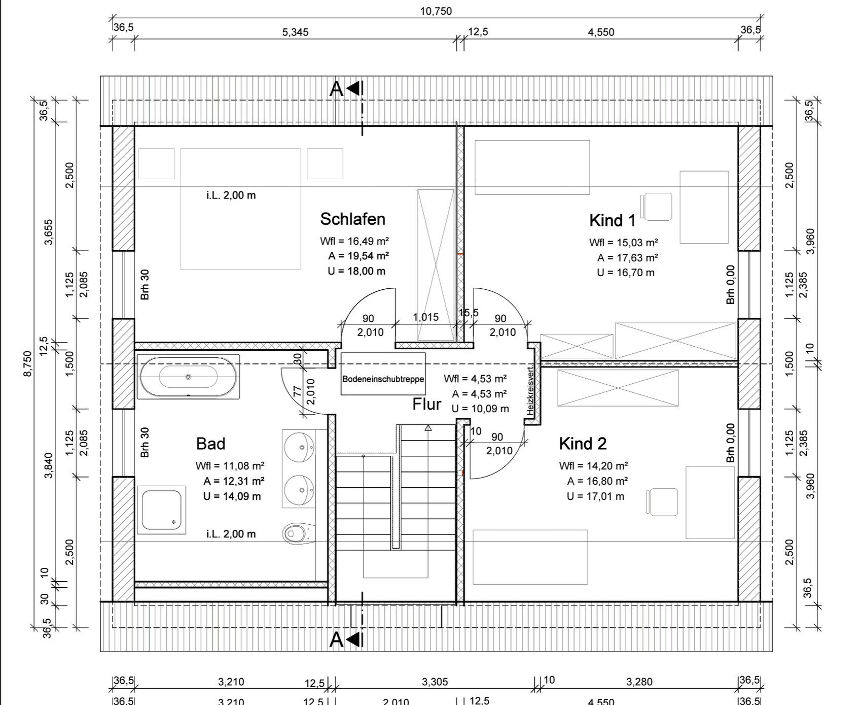

Now I’m curious, what does the floor plan on the upper floor look like? Here you go.
SebastianH. schrieb:
Since we're chatting anyway: For noise insulation reasons, would you plan to build all the walls downstairs from sand-lime brick? The wall between the kitchen and utility room is still a bit concerning to me (hanging cabinets, etc.).You can attach anything to sand-lime bricks! It is really very solid.
