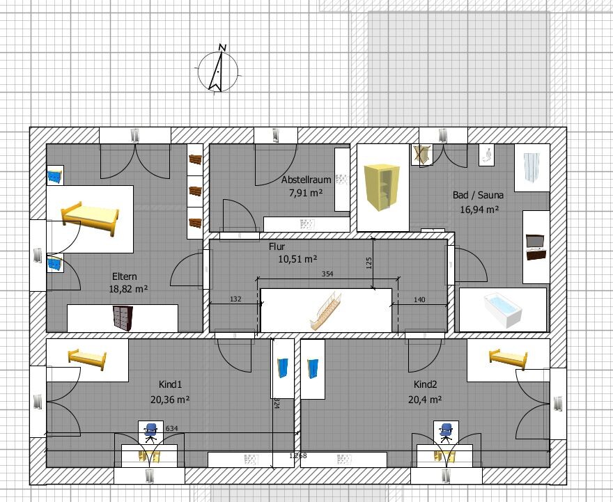

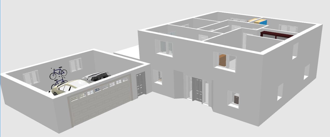

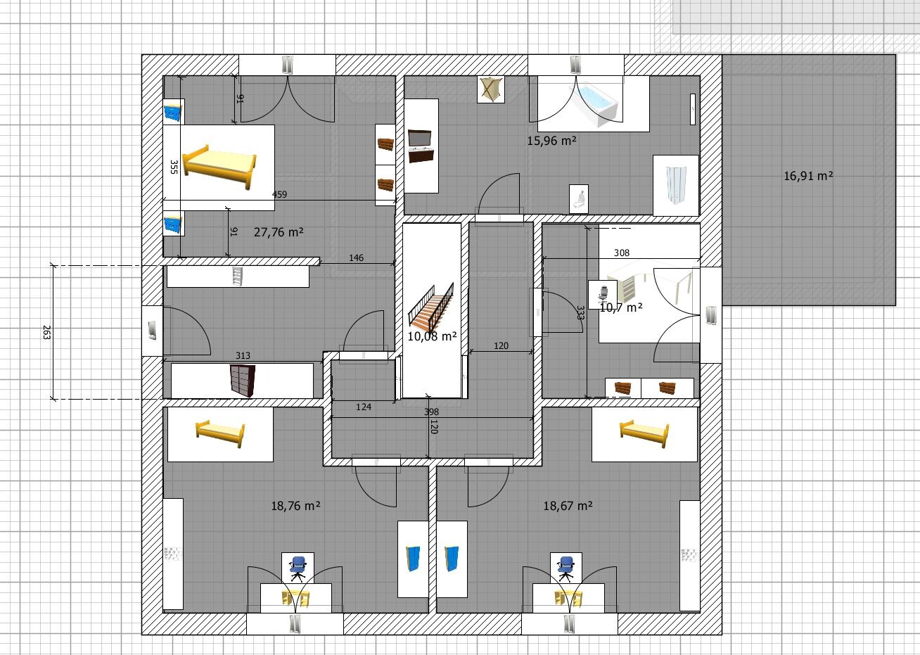

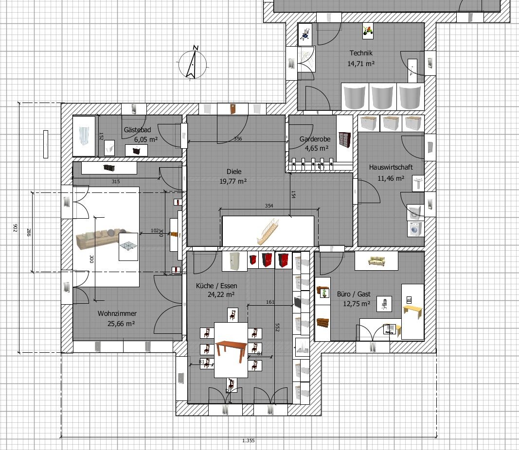

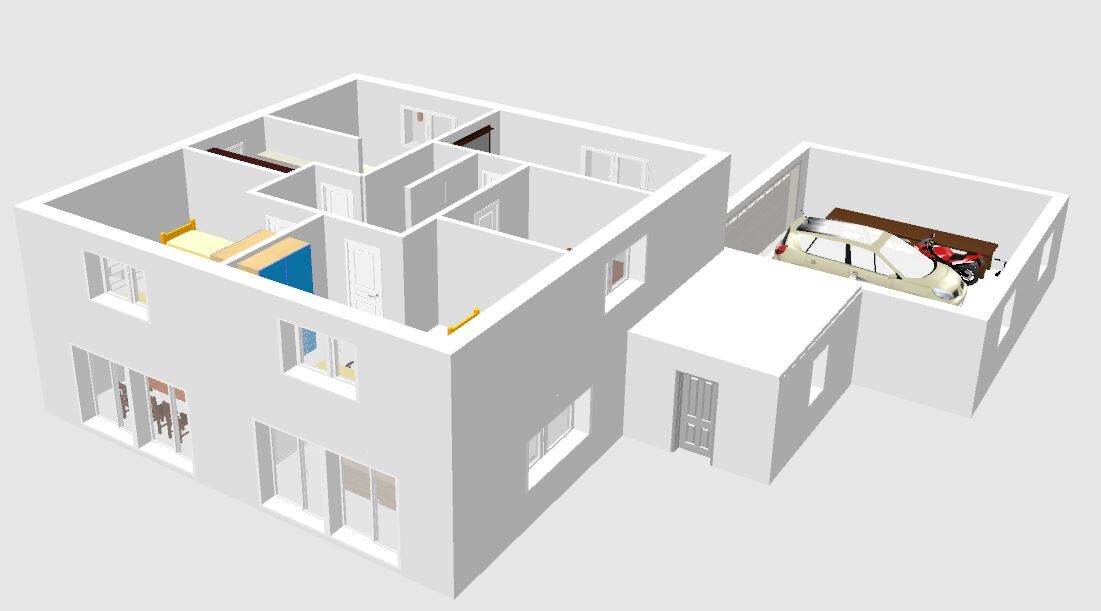

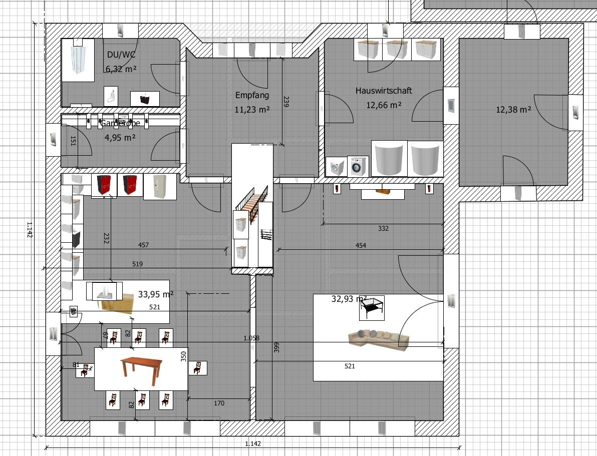

Well spotted.
Okay. So back to square one and working with the initial draft posted.
We made some adjustments and swapped a few locations.
This is the result:
Unfortunately, it turned out slightly larger than 8.99 x 12.99 meters (29.5 x 42.6 feet). In the end, the extra 50 cm (20 inches) shorter length doesn’t bother us.
Note regarding the staircase: It’s a 90° spiral staircase with dimensions of 3.30 x 1.10 meters (10.8 x 3.6 feet). If needed, the lower flight can be made a bit longer and extend further into the hallway.
The children's rooms are large, yes, we noticed that. But this results from the need for the ground floor size. We prefer the children’s rooms to be larger than the master bedroom and bathroom.
I haven’t finalized the rooms yet. The furniture sizes represent what we plan to place there later.
Have we considered everything?
This is the result:
