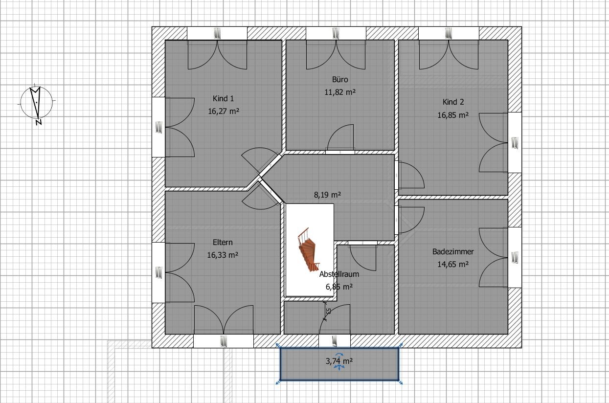

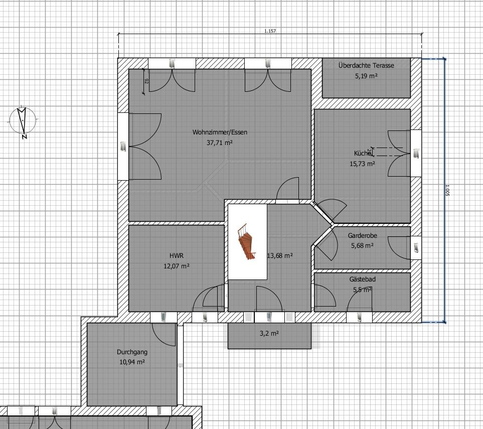

Traumfaenger30 Jan 2017 22:32So, at first glance:
Ground floor: Why does the pantry need such a large window? Seems like wasted space to me.
The guest toilet appears a bit awkward and narrow; I’m not sure if that looks very appealing.
Overall, it looks like a waste of circulation space when you consider the storage room in the garage, the utility room hallway, and the entrance hall. Was this design really created by an architect?
Upper floor: I don’t find a bathroom/toilet with two doors very practical—it will likely lead to many awkward situations (I would remove the door from the dressing room to the toilet; in my opinion, that only makes sense if it were an en suite bathroom).
The irregularly shaped open space not only looks strange but will almost certainly be difficult to keep clean... I speak from experience with a 6-meter (20-foot) ceiling height in a gallery area.
The gallery does not stand out, because when you come up the stairs, you first face a wall instead of entering a spacious gallery area. I agree with previous comments that, in its current layout, the gallery is unnecessary. Was this really designed by an architect?

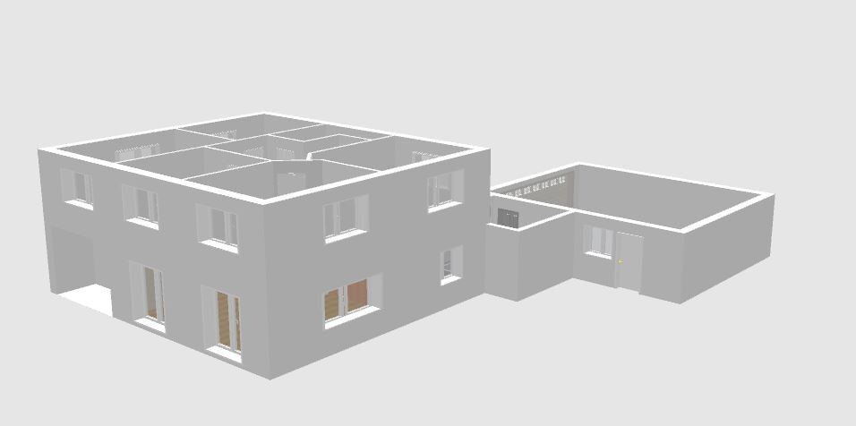

Thank you very much for your feedback.
Believe it or not, this draft actually comes from an architect.
We are trying to implement the points mentioned in our sketches using SH3D to get an idea of the results. I would much prefer a proper tool for this, but this is sufficient for experimenting.
I will try to address the individual points in more detail:
- Cost: Should end up somewhere around 300k. Realistic?
- Guest bathroom too small: We agree
- West-facing windows: Should be larger, especially in the dining room. We agree here as well
- Pantry: Definitely going away
- Staircase on the north wall: Saves space upstairs to allow for square rooms in the south (children’s rooms, next point). The current reason for the stair position is to keep it away from the entrance area since we walk barefoot inside and don’t want to spread dirt around.
- Living/dining room: The sliding door is sacrificed for more space for the TV/stereo setup
- Living room: The exit to the terrace points south, and the wall runs through as mentioned above
- Swap children’s bedrooms with the master bedroom: Could be an option!
- Upstairs no longer has any floor-to-ceiling windows. This was communicated before but not reflected in the plan.
- Utility/technical room: Could be planned more openly. The reason for its size is the absence of a previously planned basement. Storage space has to be created somewhere. The garage is not an option as it needs to fit two cars, a motorcycle, a workbench, and garden equipment. There should also be a door leading from the utility room to the east.
- Garage: The dividing wall to the storage room inside will be removed. It should be open...
- Hip roof on the garage: Fits with the main roof, right?! It should also be used as additional storage space. Flat roofs tend to become leaky over time, which we want to avoid.
Apparently, quite a few changes still need to be made. Reading through it, not a stone will be left unturned...
That’s why we reached out to you all to get unbiased opinions.
On to round two...
