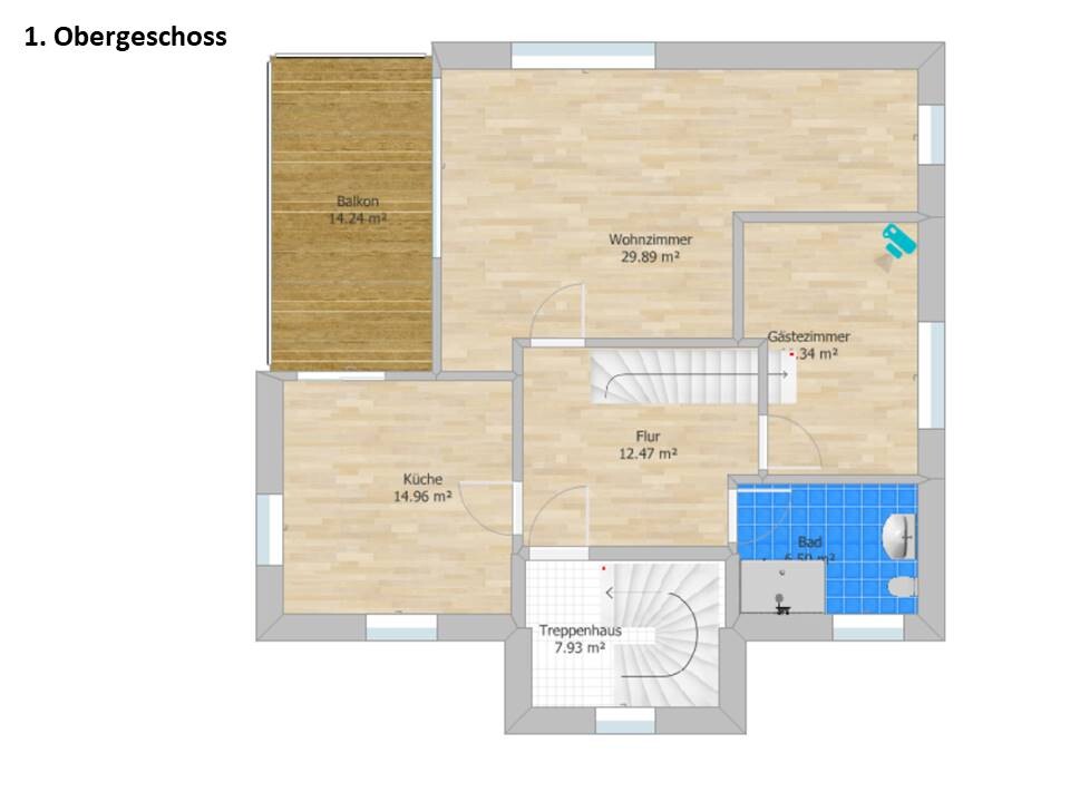

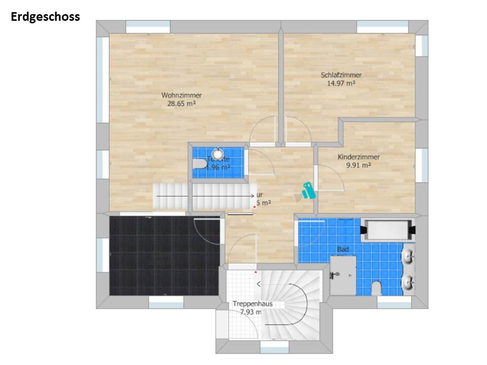

Who created the plan: self-made using Roomsketcher
What do you like and why?: large sliding doors from kitchen to living room to create a kind of open plan kitchen/living area, but can be closed to avoid cooking smells; bathrooms about 10 m² (108 sq ft) each for comfortable size; lower apartment should be barrier-free
What do you dislike and why?: staircase on the 1st floor to attic intrudes into the guest room, which is somewhat inconvenient

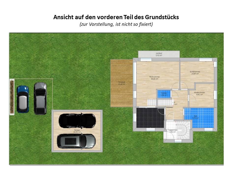

- Site coverage ratio: Plot area 810 m² (8,715 sq ft) with a site coverage ratio of 0.2 (=162 m² (1,743 sq ft)); limit: footprint for single-family house max. 120 m² (1,292 sq ft). What can be included in the remaining 42 m² (452 sq ft) difference (balconies, bay windows, light wells, courtyards, terraces…)?
- Extended site coverage ratio: for garages, etc., “site coverage ratio may be exceeded up to 0.5.” How is this calculated? Half of the plot area (405 m² (4,359 sq ft)), half of the plot area minus the original site coverage (405–162 = 243 m² (2,616 sq ft)), half of the site coverage ratio (81 m² (872 sq ft)), or half the footprint of the house (60 m² (646 sq ft))?
- How are light wells (planted embankments, not attached cellar shafts) for basement illumination counted, under site coverage ratio or extended site coverage ratio?
- How are balconies and overhanging bay windows counted?

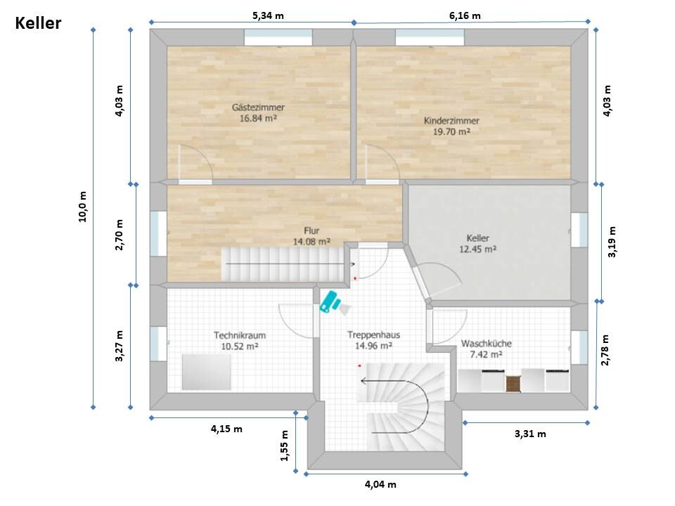

- What wall thicknesses should we expect for exterior walls (KfW40 standard with brick veneer) and interior walls?
Images attached:
And forgetting to include the street and north arrow on the site plan....

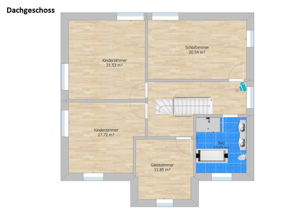

However, everything will probably fail because of the staircase... Outside 404cm (159 inches) - wall thickness 93cm (37 inches) = 311cm (122 inches) available for the staircase, which remains the main traffic route (including furniture transport, kitchen countertops, etc.) for a two-family house.

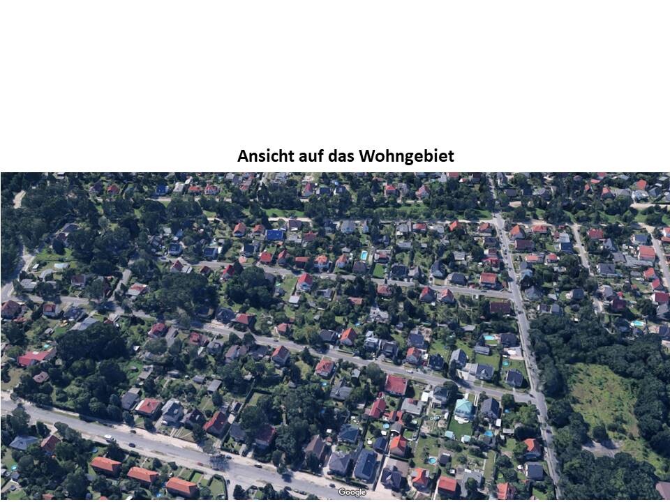

hanghaus200013 May 2021 19:09Is there a zoning plan?
Please mark the plot of land on the aerial image.
A plan of the plot? Preferably from the geoportal. At least you can see where north is.
If it is a §34 case, then photos of the neighboring buildings are important.
